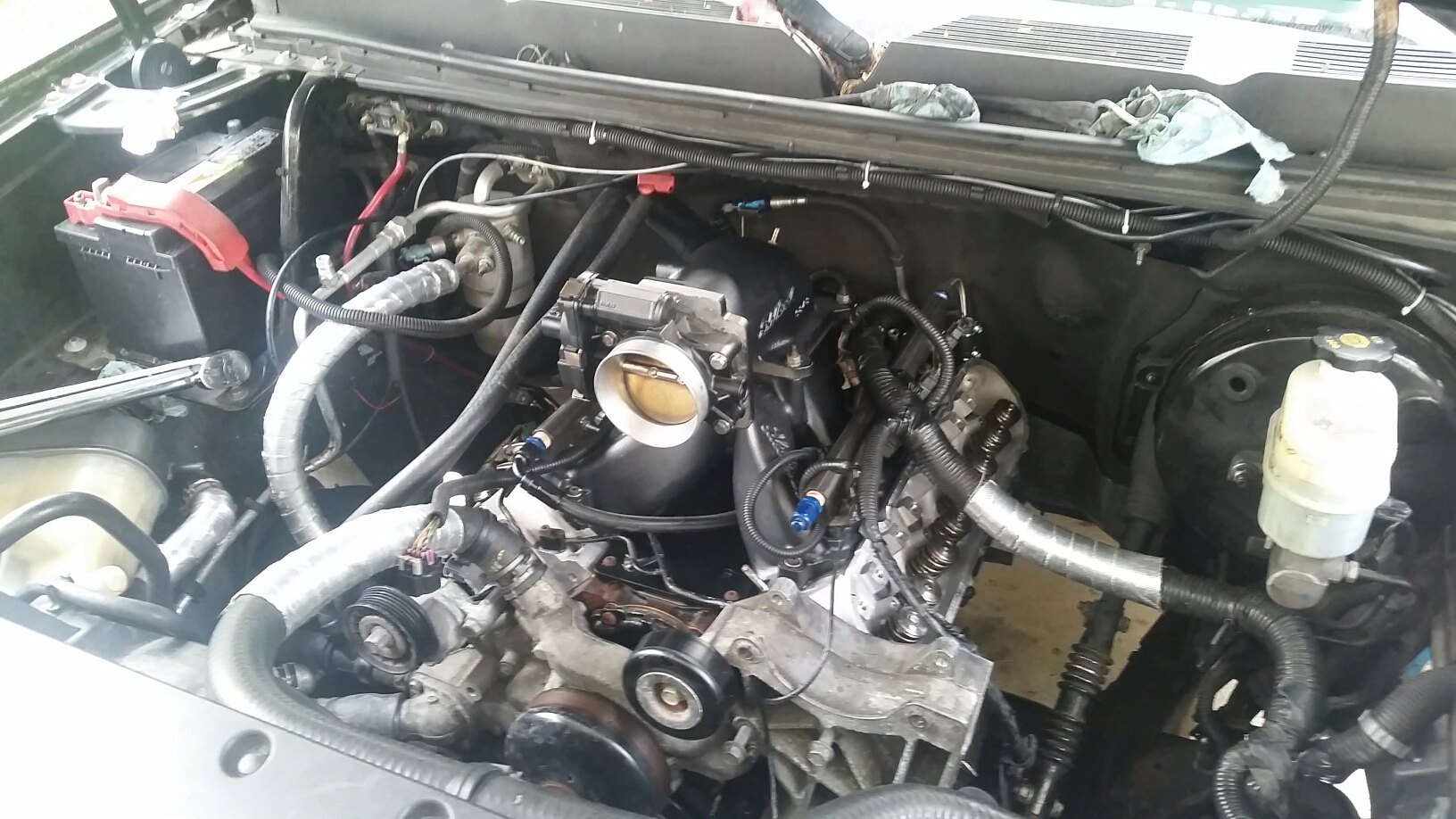

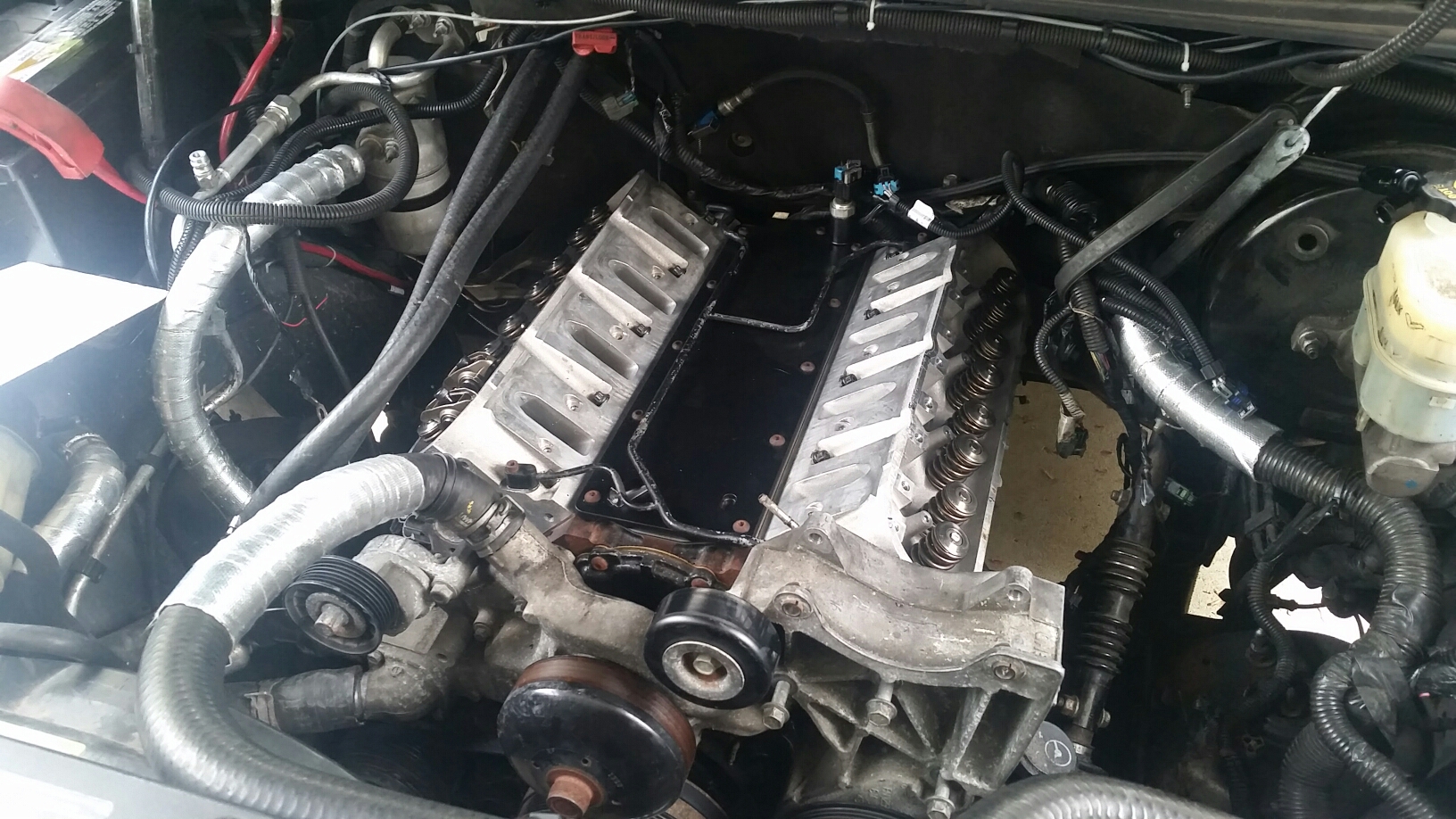

Gaskets came in so I started putting her back together. May swap the supervic for a vic jr. With a friend who's building a race car. I doubt I'd need it for the power levels and street driving this truck is gonna see.

Got a lot of it back together for now ... just waiting for new pushrods. The valve tips came in at two different heights, ugh ... but since I had to get new ones anyway, it wasn't a huge issue. So 7.300 for exhaust and 7.325 for intake to give me 0.030" as recommended for the Lunati link-bar lifters.
If you noticed the green in the pic, that's gonna be turned into my brake vacuum reservior, lol

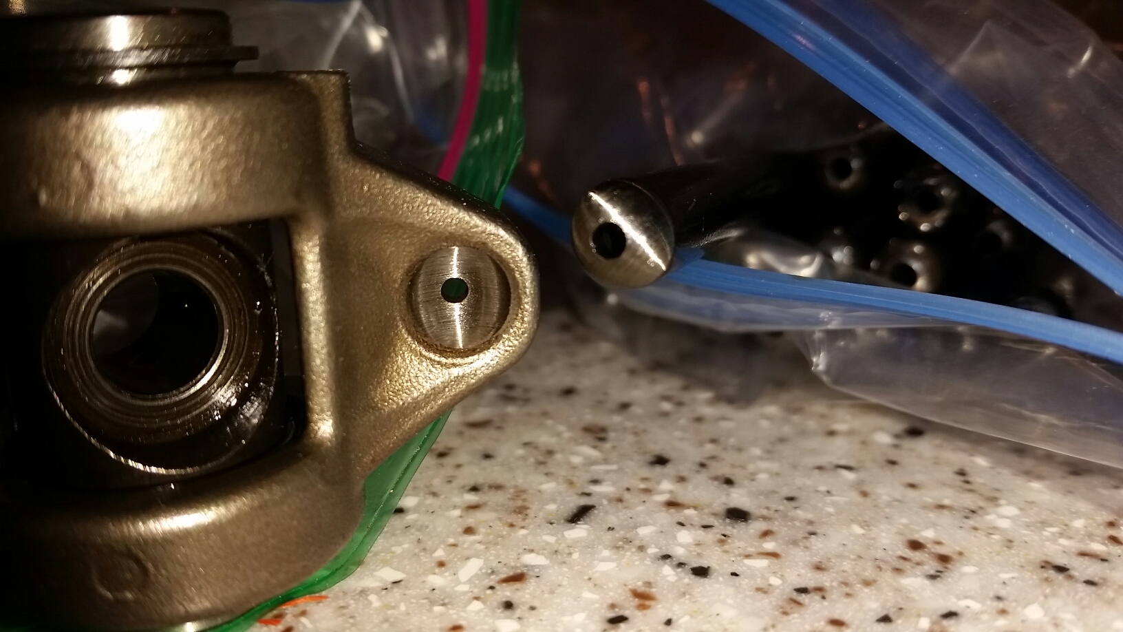

Looks like l need a new rocker and to swap over the trunion upgrade

Pushrods came in, swapped the trunion upgrade onto another stock rocker and put it all back together. Just a few odds and ends to finish and an oil change and we should be ready to fire up!

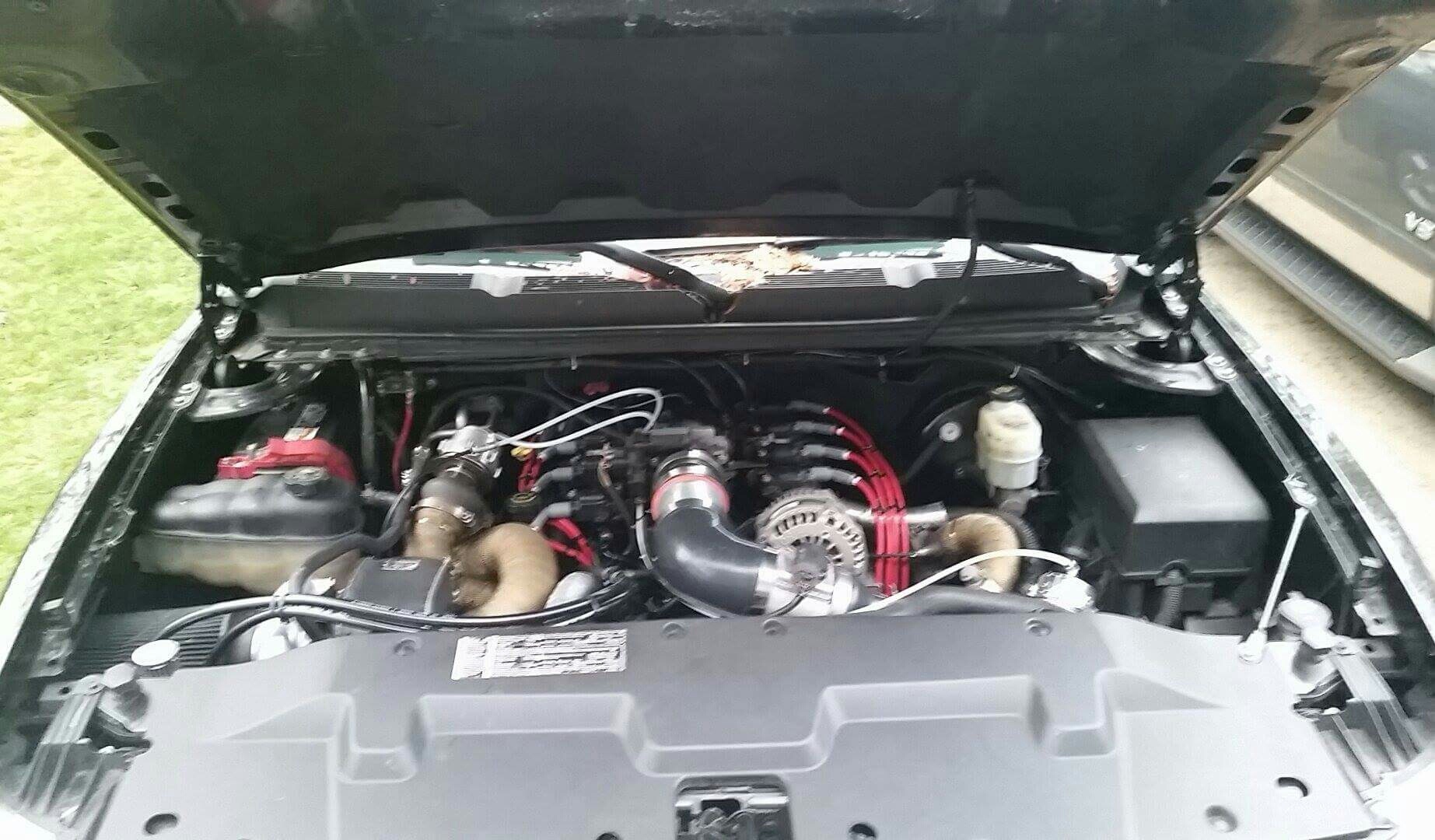

She's all together again!
2009 Silverado ... another flipped Manifold build-received_10101319139420973.jpeg
Need to set up the Tru Boost, and start fooling around with tune
