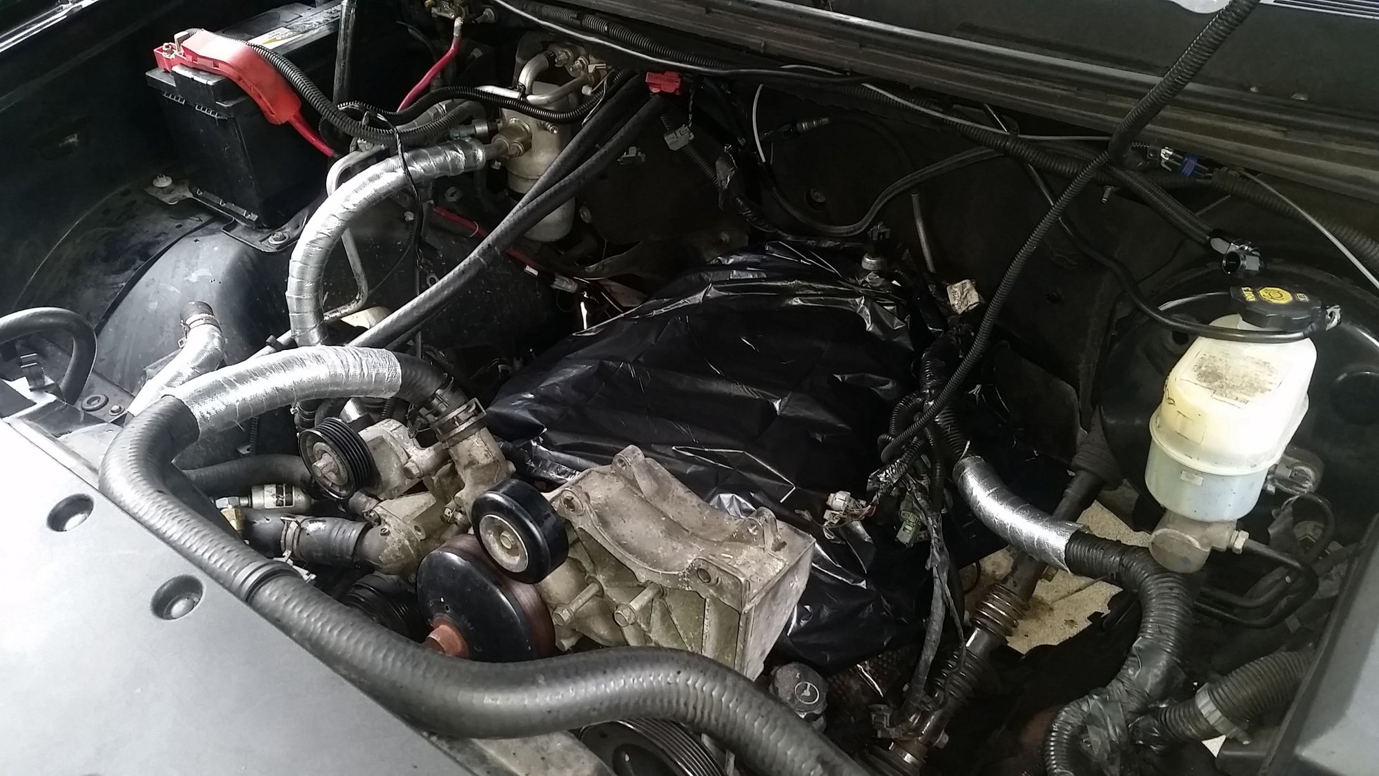

Well took some time and pulled the heads today. Def a lot of "milk" in there ... taking heads to the machine shop to get pressure tested etc for good measure. heads only have mild chamber work and larger valves installed, wish I had the $$$ to put some better heads on while I'm at it
As it sits
Was able to take the turbo kit out as one big piece ... giggity
