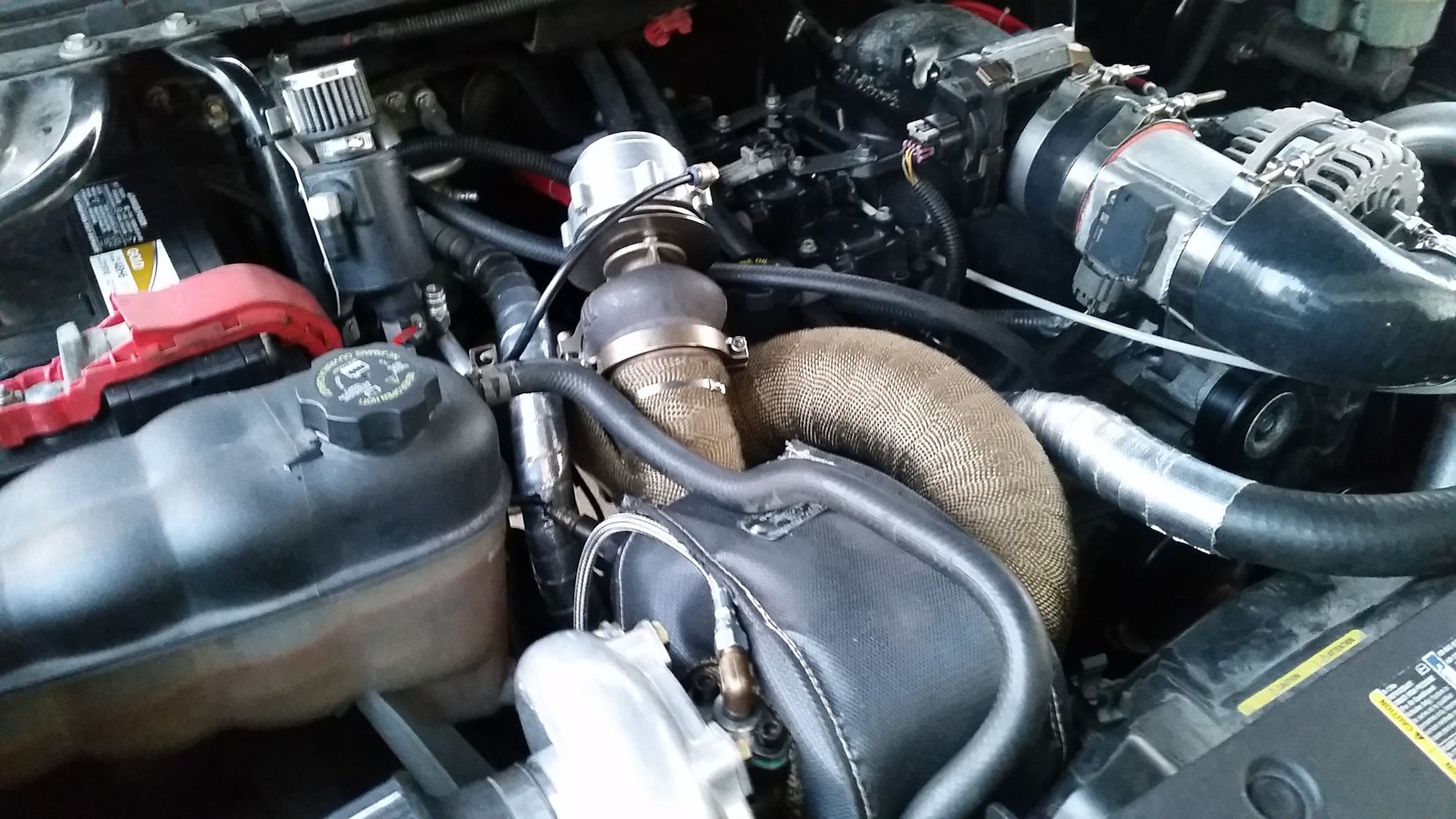

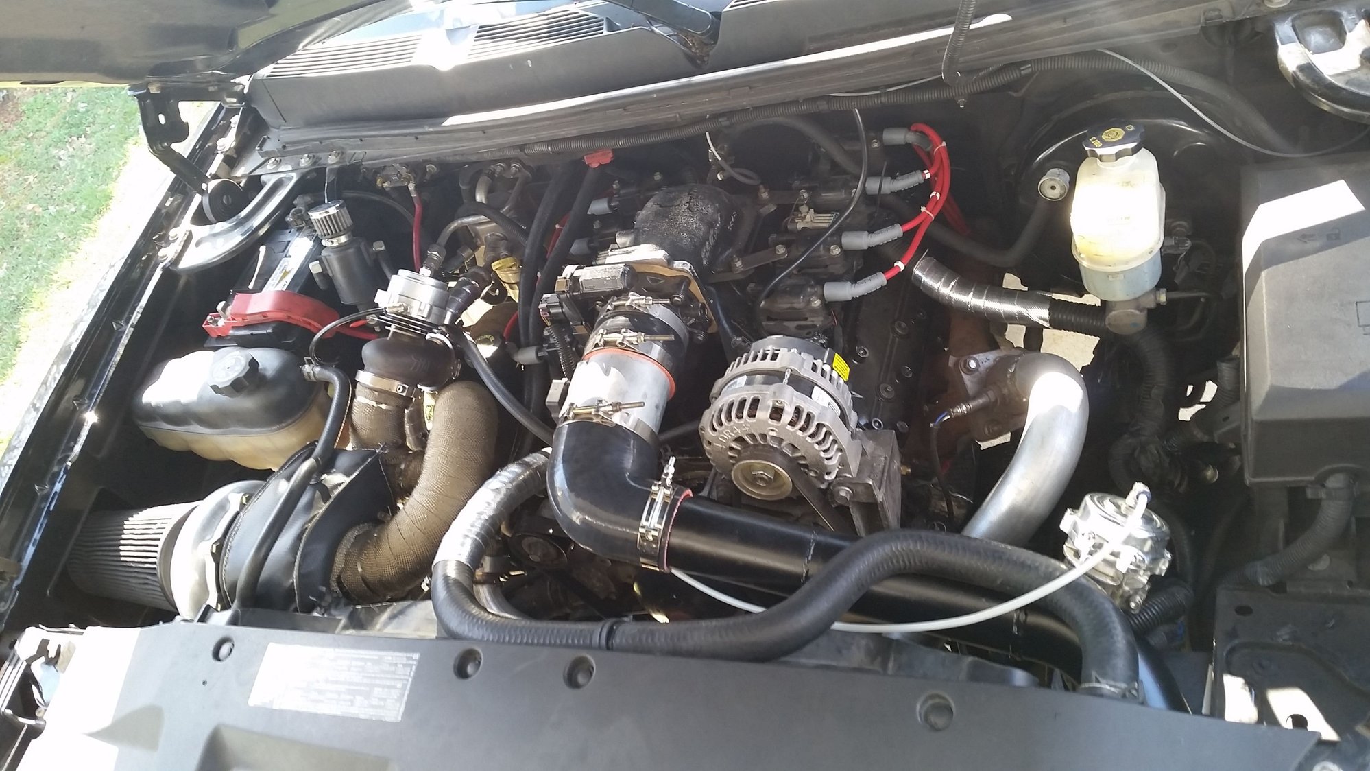

Well, it's all together and running! Made her idle for a good 5-10 mins while I checked all the clearances and lines for leaks etc. and then took her down the street to the gas station! I know she wants to GO and the turbo starts making boost at about 2200 and the blowoff sounds awesome! hahhah ... def needs a tune now. The previous tune was done with the stock 5.3 and 4L60E and now it has a low compression bottom end with cam and the bigger turbo/etc. and it goes into knock retard like a retard! I could barely get in the boost without the alarm being triggered on the Dashlogic.
Just need to wrap the crossover tubing; I don't have enough, and maybe relocate the catch can to a more permanent location instead of zip tied near the battery ... or maybe route the tube back into the filter to make EPA happy, lol

Great job pretty clean installation you have done there.

Curious, why didn't you build the kit with the driver manifold pointing down and forward? PS pump in the way?

Well to do that would require another passenger manifold ... which I actually do have but never test fit it like that. P/S and steering box is in that region though
Thanks, just waiting on some plug wire separators so I can get rid of the zip ties.

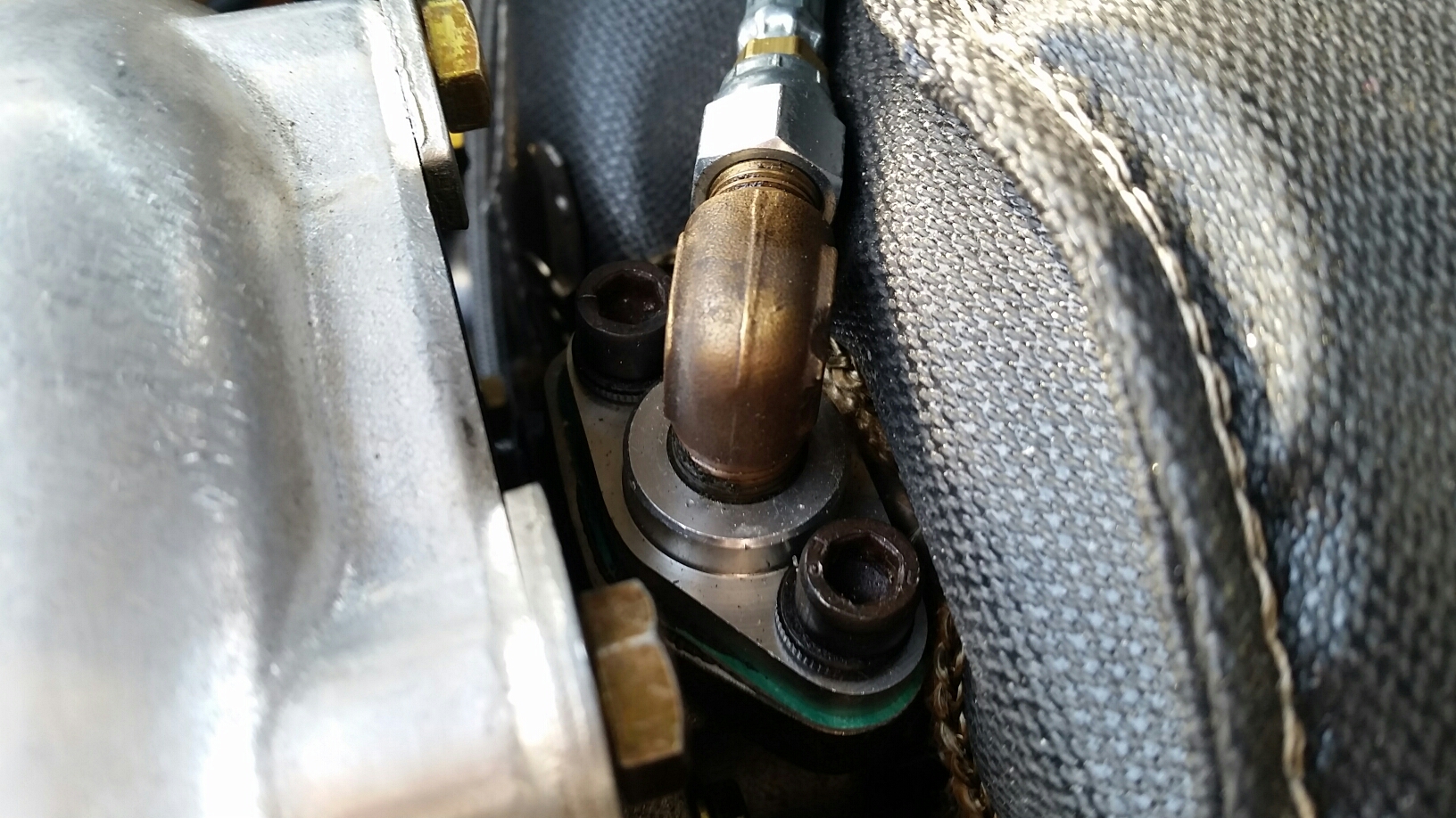

The only damn fitting I didn't take apart and re-seal leaks! lol
