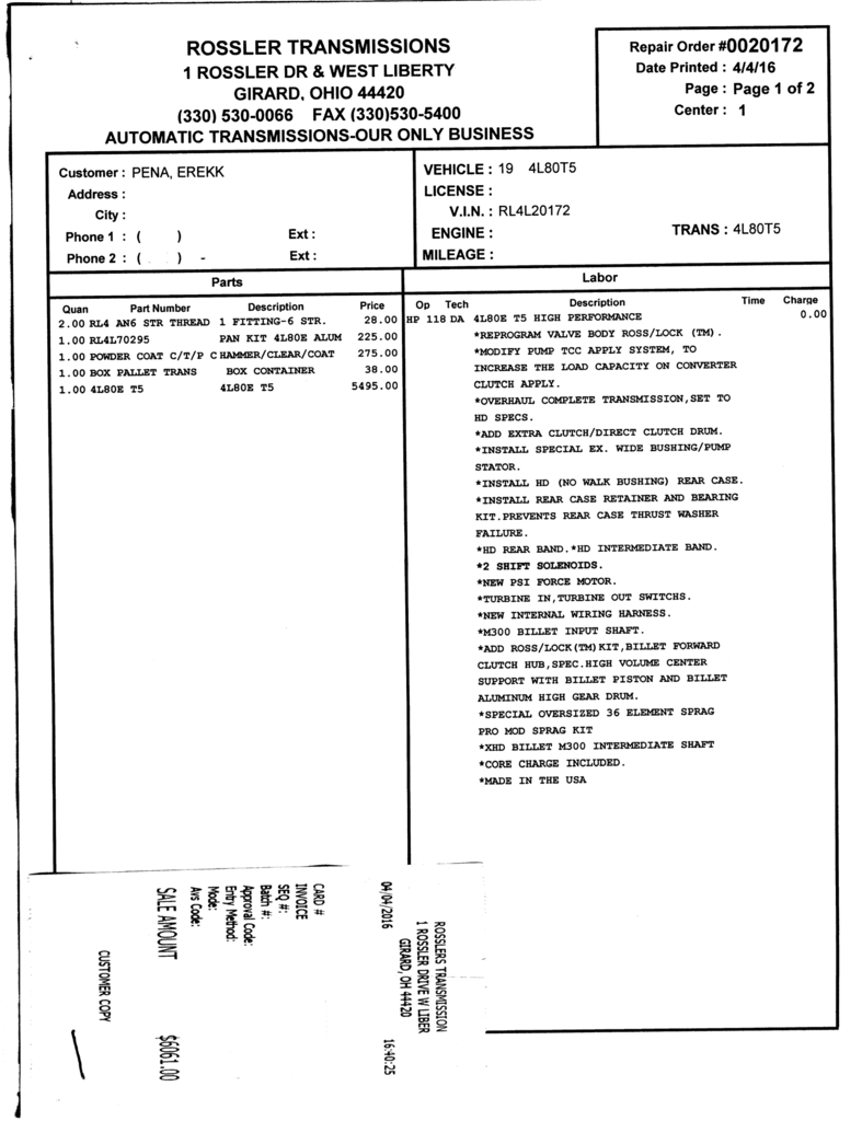

New Rossler Terminator V should be coming in in about two weeks. Should be fun with the new ProTorque converter.

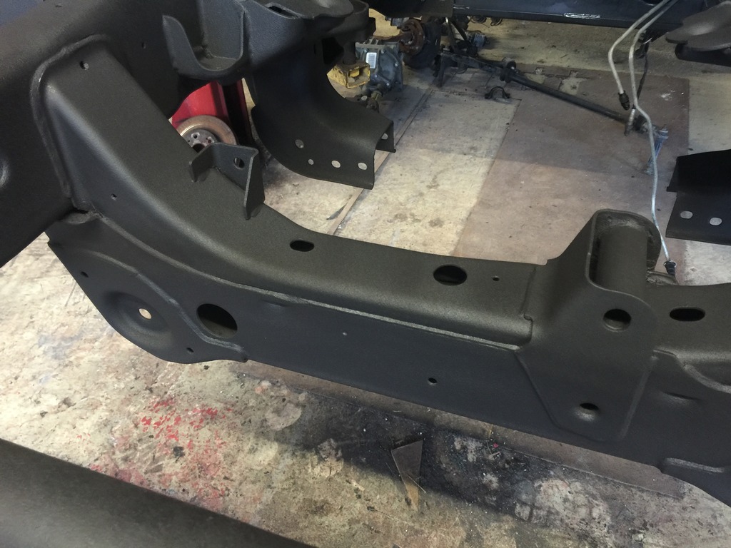

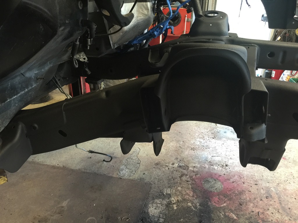

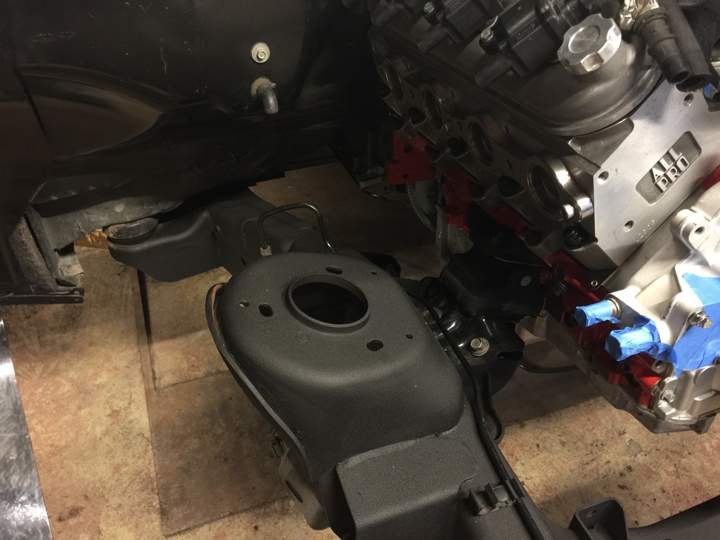

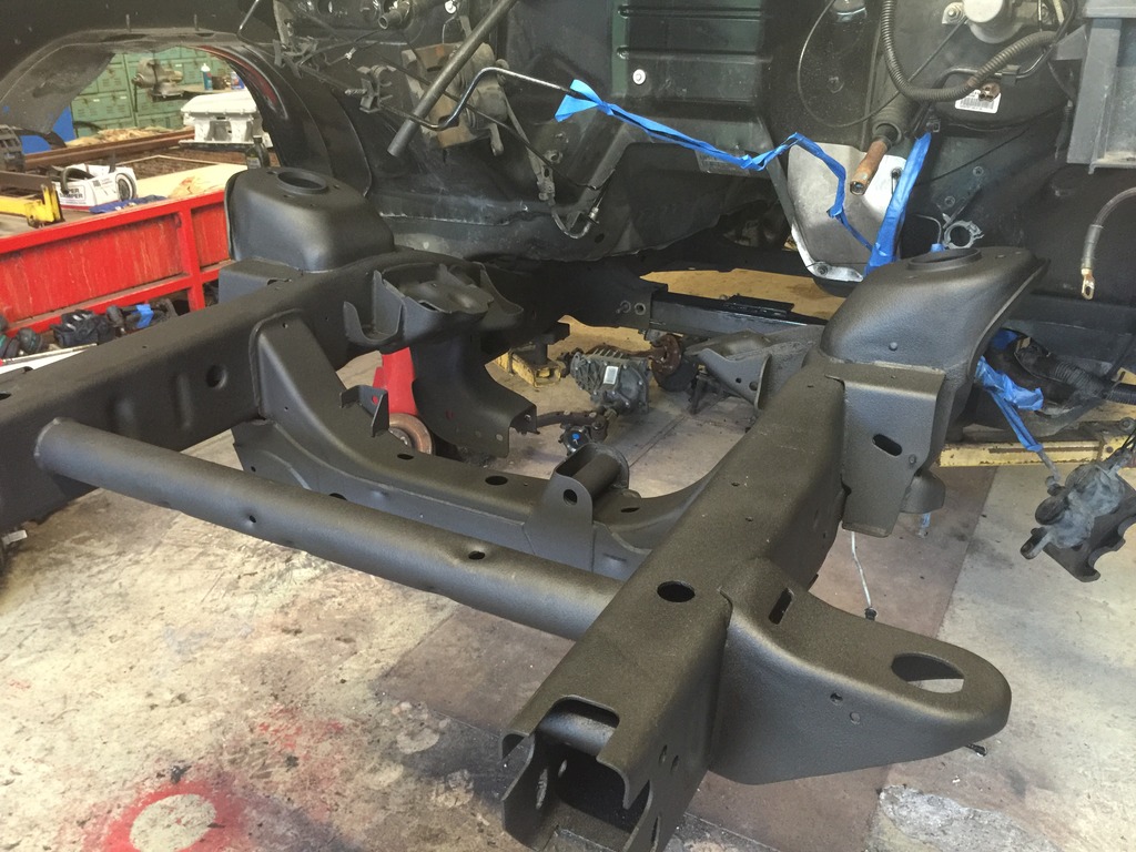

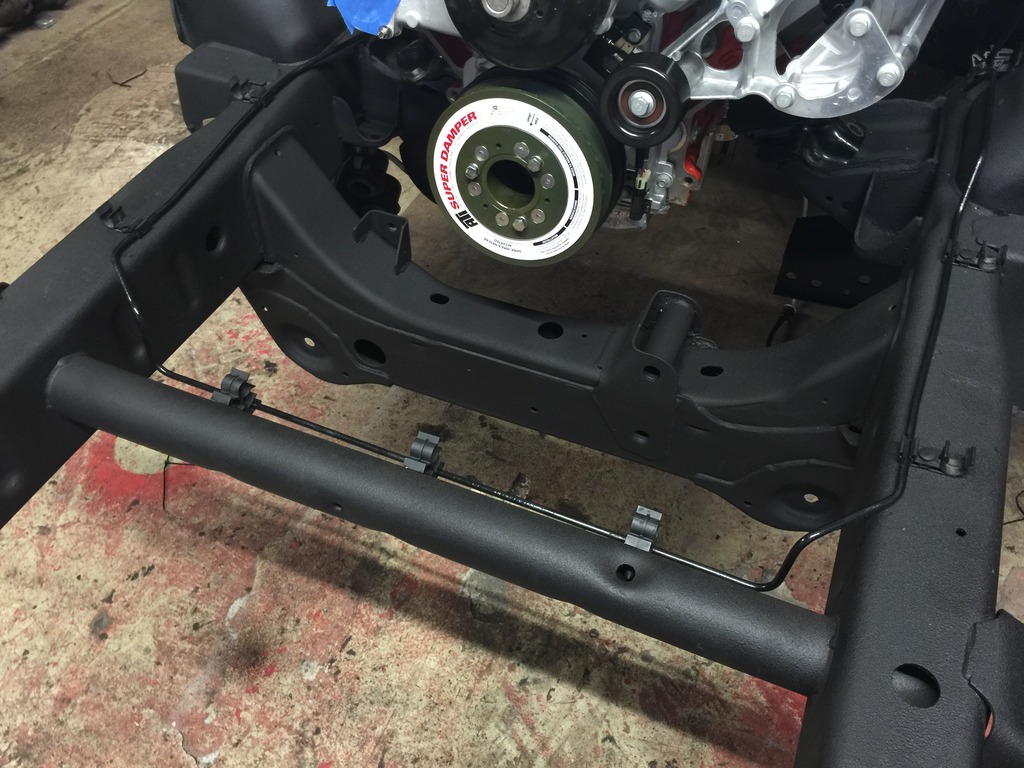

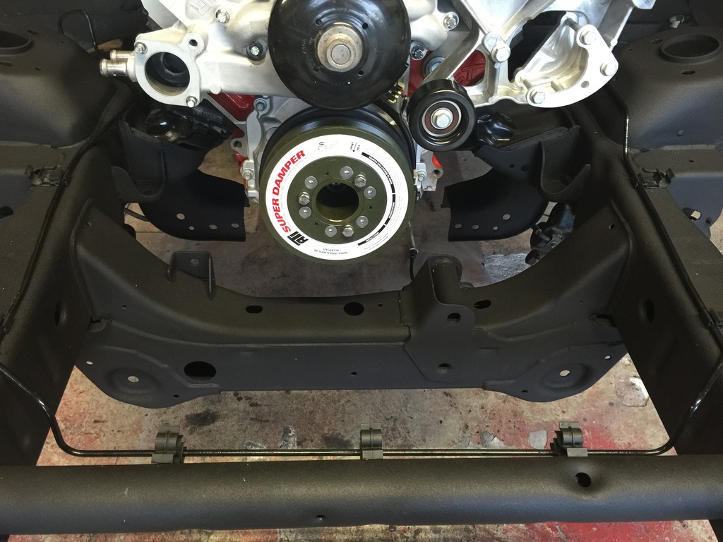

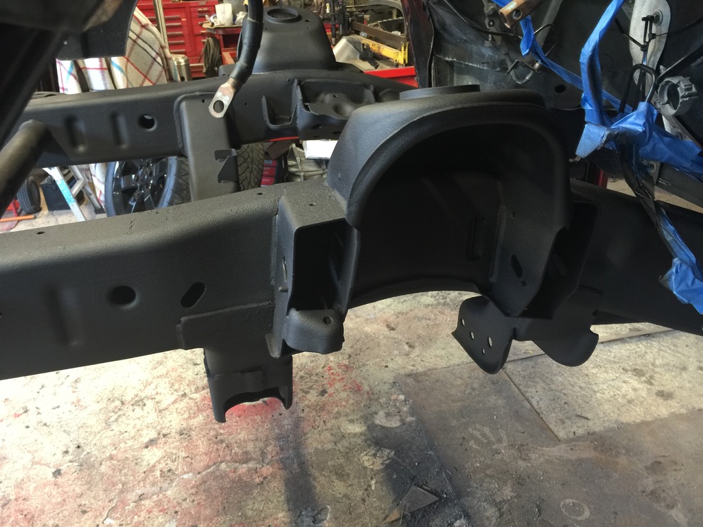

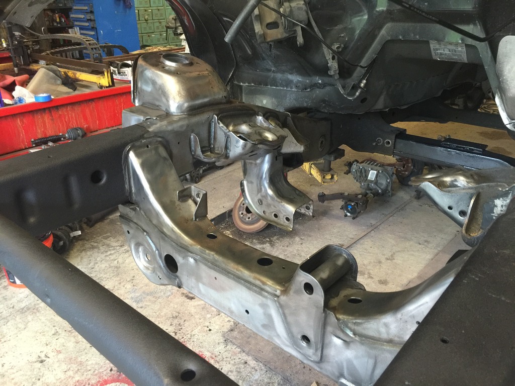

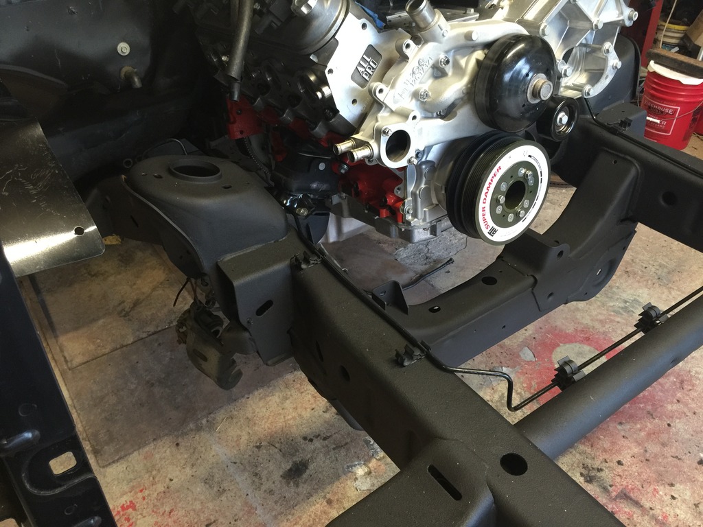

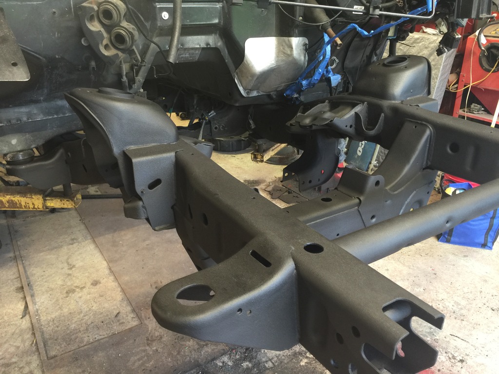

Well finally finished cleaning and coating the frame. Came out great. Motor and new suspension will be going in in a few days and while I wait for the new transmission to come in I can finish the hot side of the turbos.

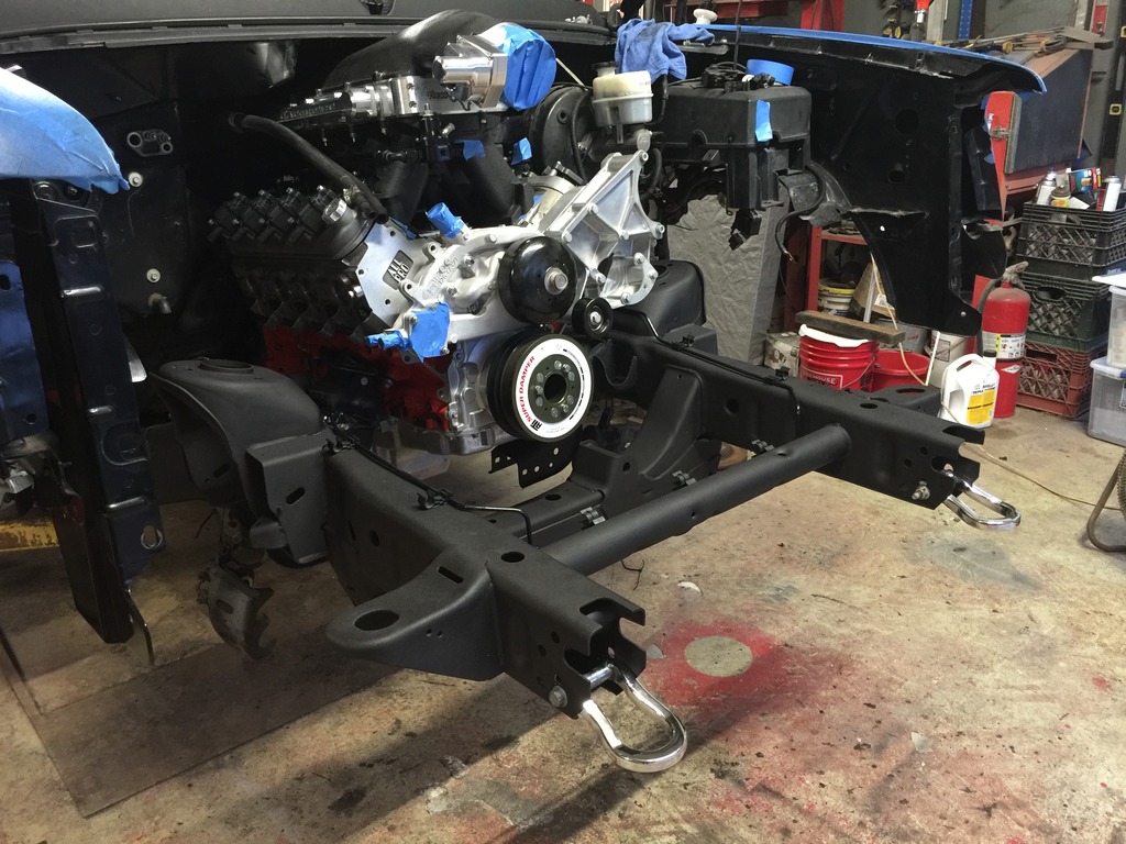

From: Corpus Christi

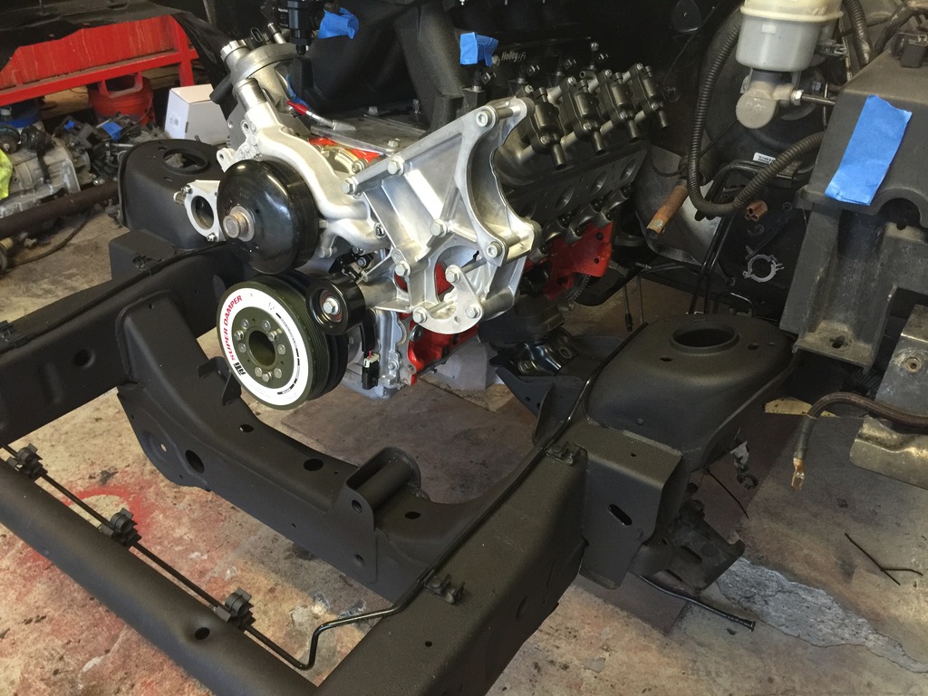

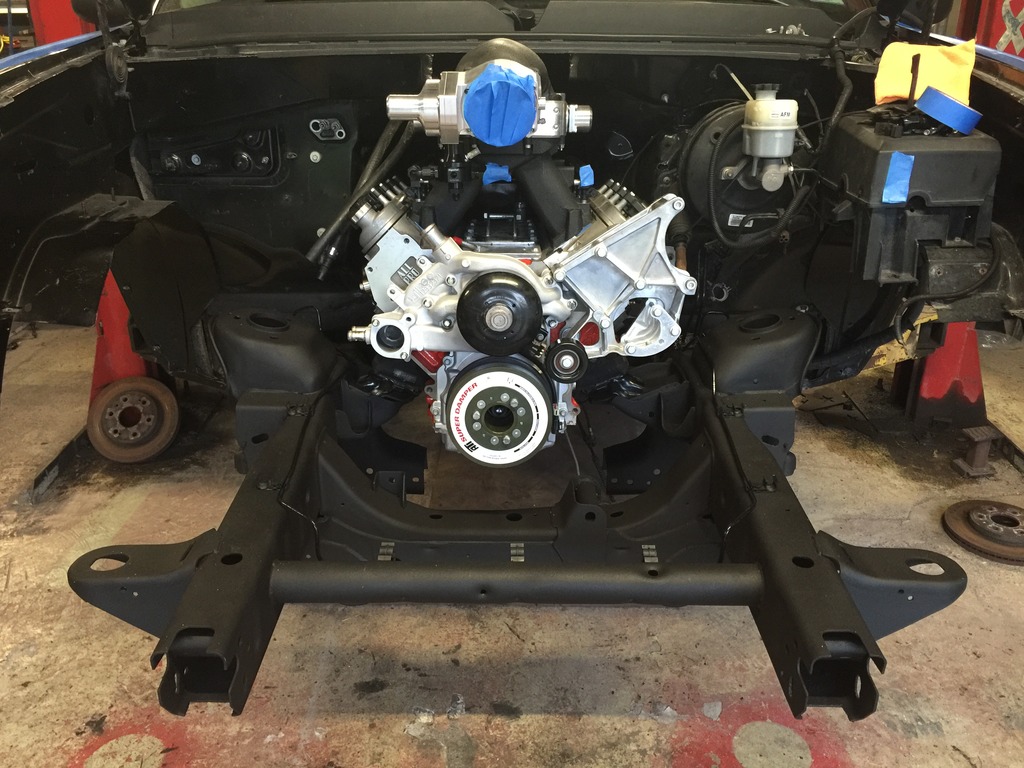

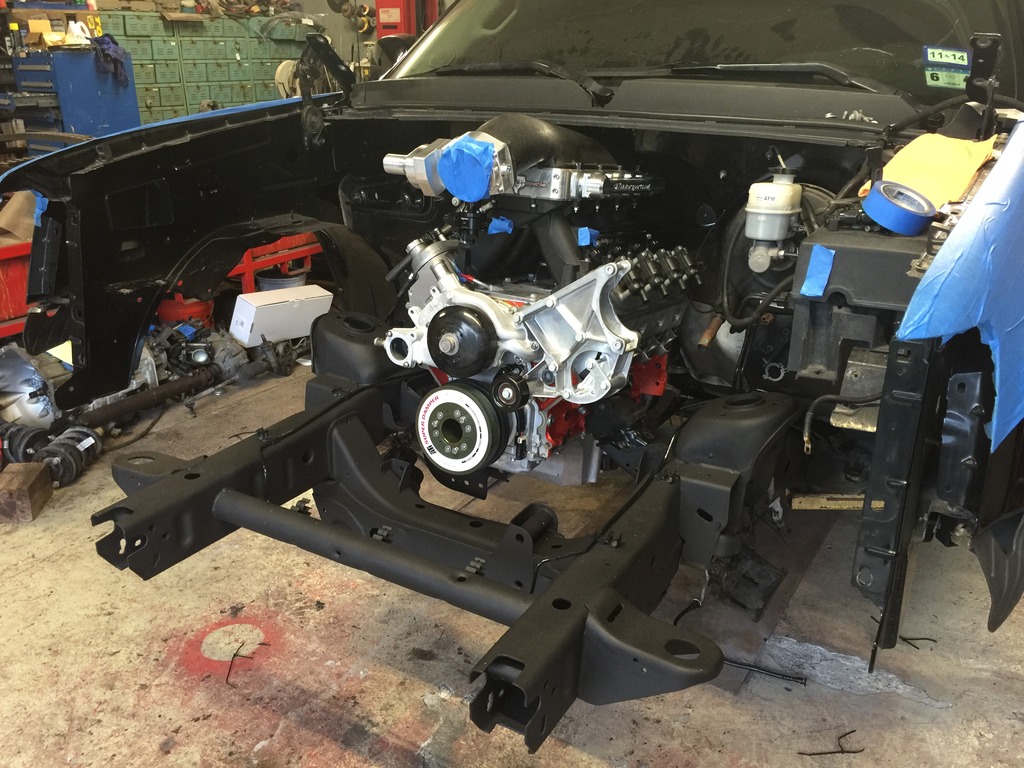

Got the motor back in and hopefully for the last time. Right now using the mock up trans to position the motor where its going to be so I can finish the hot side while I wait on the trans. Slowly but surely coming to together...
