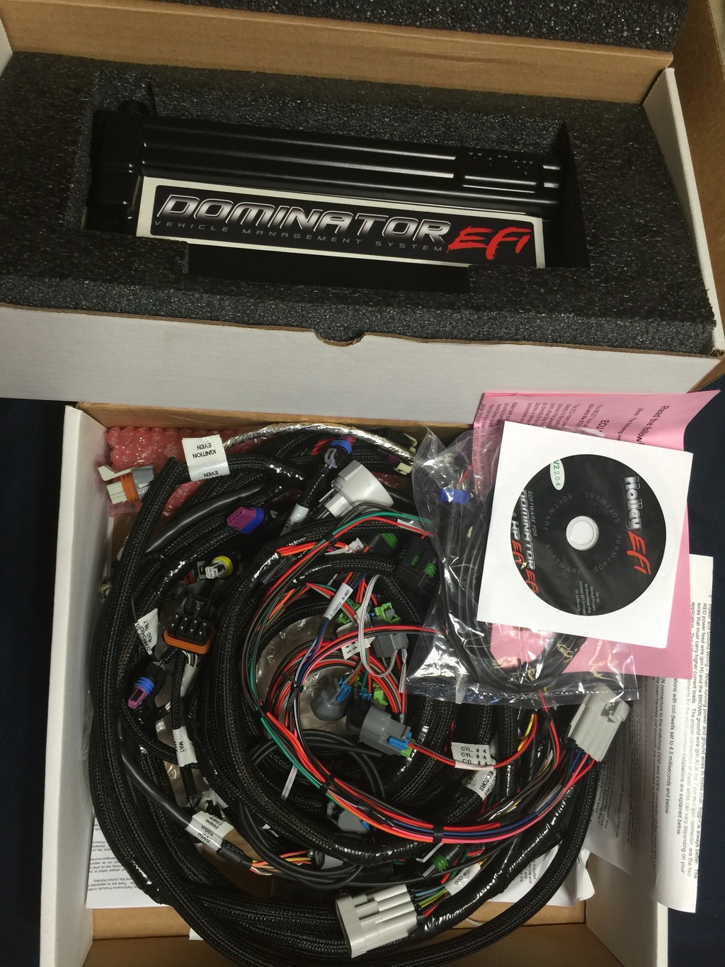

Well I got some discussions to make. I got a brand new ready to go Holley Dominator system for my truck but don't know if I want to stick with it or go to a Pro EFI 128 setup. The Holley seems easy to learn but missing alot of features and capabilities the Pro EFI comes with. The Holley also isn't so much user friendly to the factory features, needing seperate gauges and stuff. Anyways I'll be thinking about that for the next couple of days till me next days off...

Ill give you $500 right now for the whole box of goodies to ease your pain
