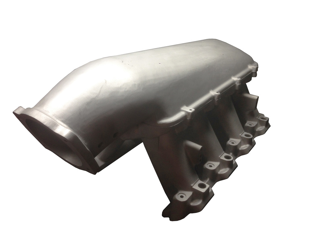

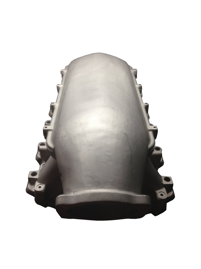

Finished smoothing out the intake now just going to have a buddy weld the top and bottom halves together so there is no chance of this thing coming apart under high boost. After that off to the powder coater...

You are going to paint that, right? It looks like a whale
Oh and good luck welding cast aluminum...***** hard!

Welding cast isnt all that tricky with the right prep work
i dunno if id weld those two pieces together, the upper piece isnt casted strong enough and the heat from weld will weaken the upper part above where it will be welded. At that point it will be more likely to break above the weld with boost
Lol Yeh def going to get powder coated and having a buddy weld it for me as I don't have the know how or the equipment
Seen a few of these intakes fully welded and hold up so will see. Not saying your wrong or anything as I'm no welder just seen more of these intakes posted broken at all the screw points so don't think welding it would make it worse. I see what your saying tho. If you have or seen one of these intakes in person you can see how weak the mounting points look. They are casted small and very thin in some points... Think Holley needs to rethink there casting on this intake as some points are questionable to say the least
