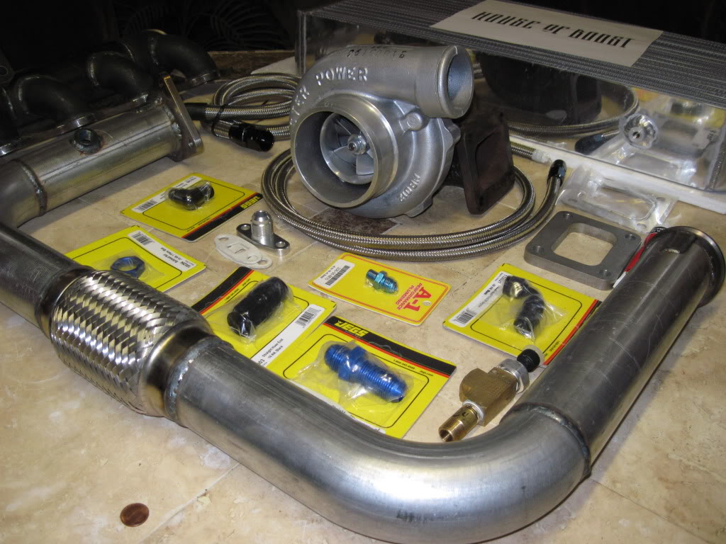

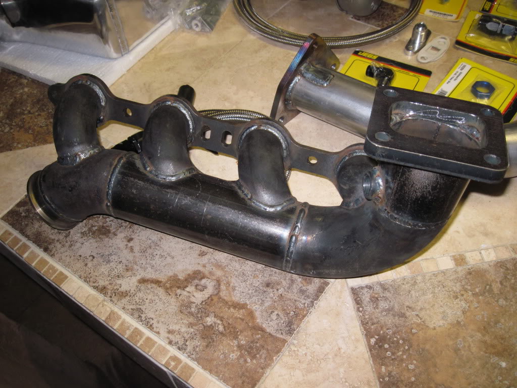

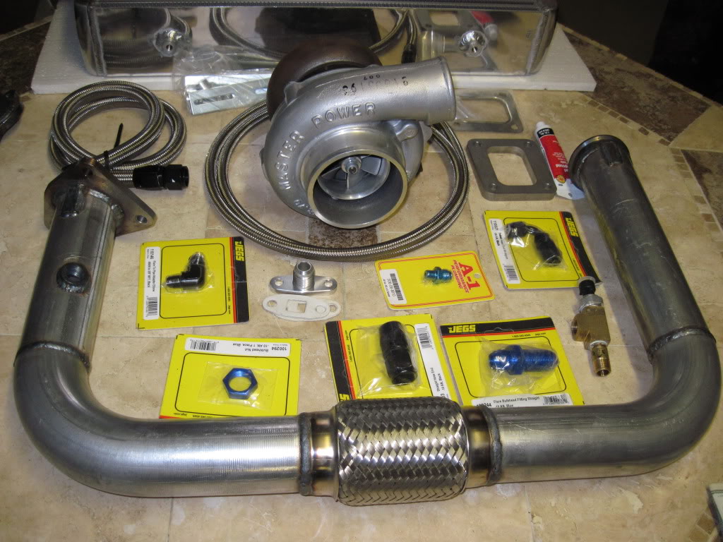

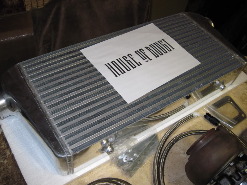

Yeah im doing the same thing on my 09, so far I have most of the parts minus the fuel system. From what iv read and reaserched our injectors use the UScar connectors and are the ls2 type now im not 100% sure on this but ill be ordering some 57lb FAST injectors from speed engineering soon so ill get back to you on that..... I have spent maybe 1500 so far on misc. parts and maybe need another 1000 and I should be done with the way i want it. Are you going top mount or rear?
