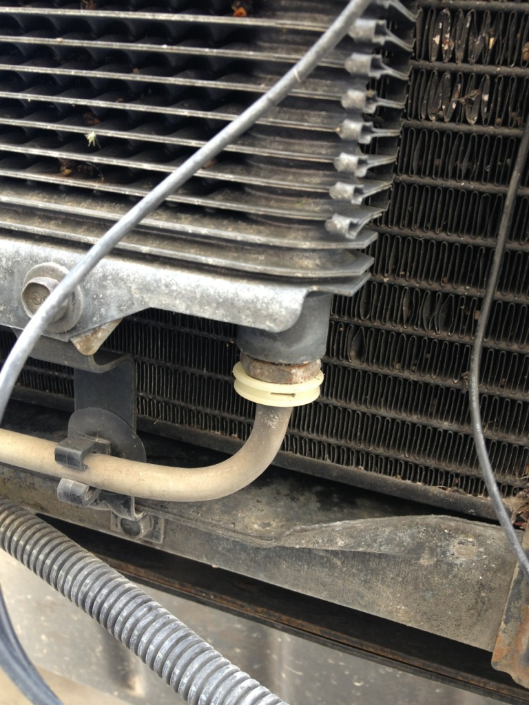

Here is what I have on my stock 1996 cooler
Will these thread into the new 40k cooler?
How do you disconnect them?

I don't know if they will fit into the 40k cooler but to remove the lines you pop down the plastic piece which will reveal a metal clip, you just remove that and pull the line down.

Ok, thanks, I see the clip now but how do you get the clip off? Need a special tool?

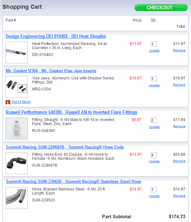

Well, looks like I will be attacking this weekend. Never put together AN/steel braided lines, so here is what I got:
The vise clamp I cancelled, it is out of stock and won't ship til the 30th, so I'll do it the old fashioned way. I have a pair of 0ga cable cutters to make the cut clean. Anyone think of anything I am missing?

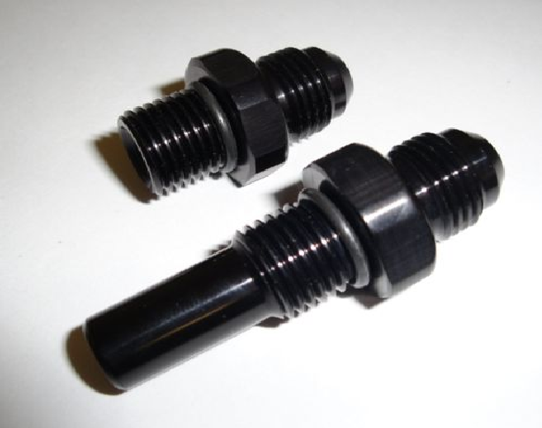

4l80e fittings:

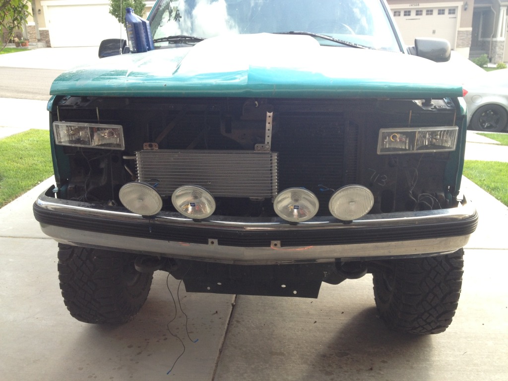

Here is mine. But i might move it under the grill and behind the bumper where that little slot is in the bumper. And honestly guys I think I shoulda bought a bigger thicker cooler from summit instead of this tru cool.
