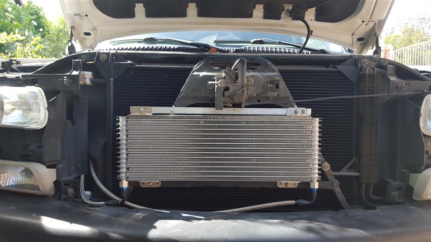

1999 Silverado 1/2T
Did not come with the small cooler in front of the radiator.
I routed the output of the radiator cooler to the Tru-Cool. I made a new line that went from the exit of th Tru-Cool back to the transmission.
I used a straight piece of aluminum bar with some spacers at the top and I flipped and rotated the bottom support bracket with a couple holes for the bottom mounts.
All went well except for accidentally drilling into the AC condenser!
I went with Earl's fittings since it sounds like they have less issues.

Originally Posted by bruceb58
1999 Silverado 1/2T

Originally Posted by 06_crewcab_ss
What size fitting did you use going to the rad? I'm looking to switch mine over to all AN line soon
Same as what goes to the Tru-Cool.
Earl's Performance AN to Inverted Flare Adapter Fittings 991947ERL - Free Shipping on Orders Over $99 at Summit Racing
