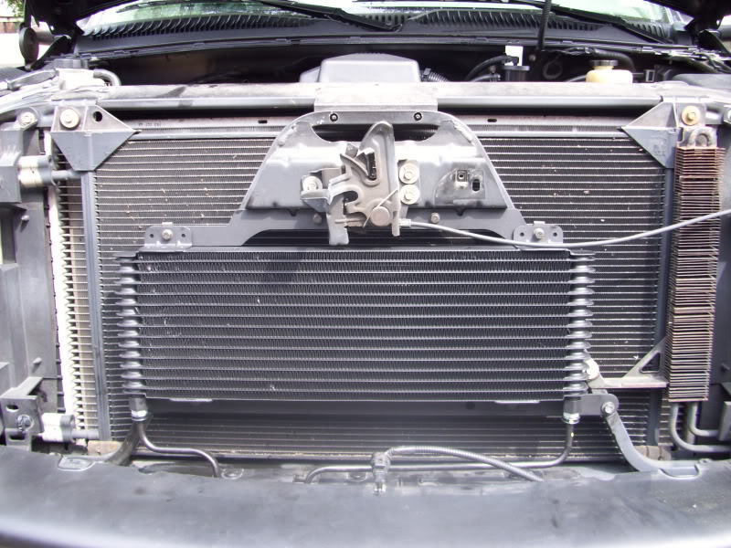

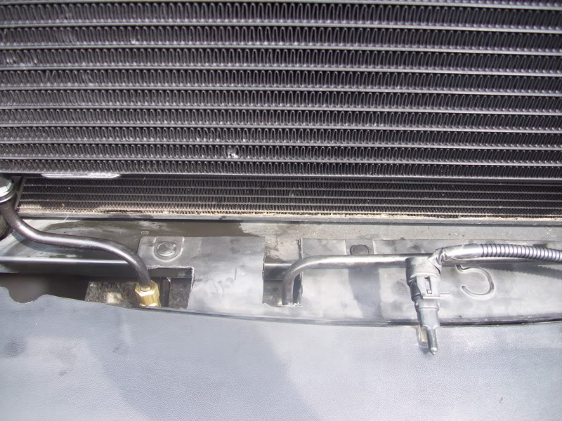

I used factory aux cooler lines (had to buy the kit from the dealer for about $70-$80 my price), and the EAD brackets and fittings kit. I made a thread with my install, that is probably linked somewhere on the first page of this sticky. If your truck already came with the factory aux cooler, you don't need to buy the kit. I was able to sell the new factory cooler that came with the kit also, which helped bring the install price down about 20 bux IIRC. It's a nice clean install and looks factory aside from one compression fitting, and is more of a budget way to do it. If I had more dough I would have done black braided lines and AN fittings though, but it took me 18 months to pay off the FLT Level7 as it was and I was dying to get my truck back on the road.
I had a bunch of trucool/trans swap threads floating around last spring and summer, here's a few lol:
https://www.performancetrucks.net/fo...hlight=trucool
Here's my 40k...
