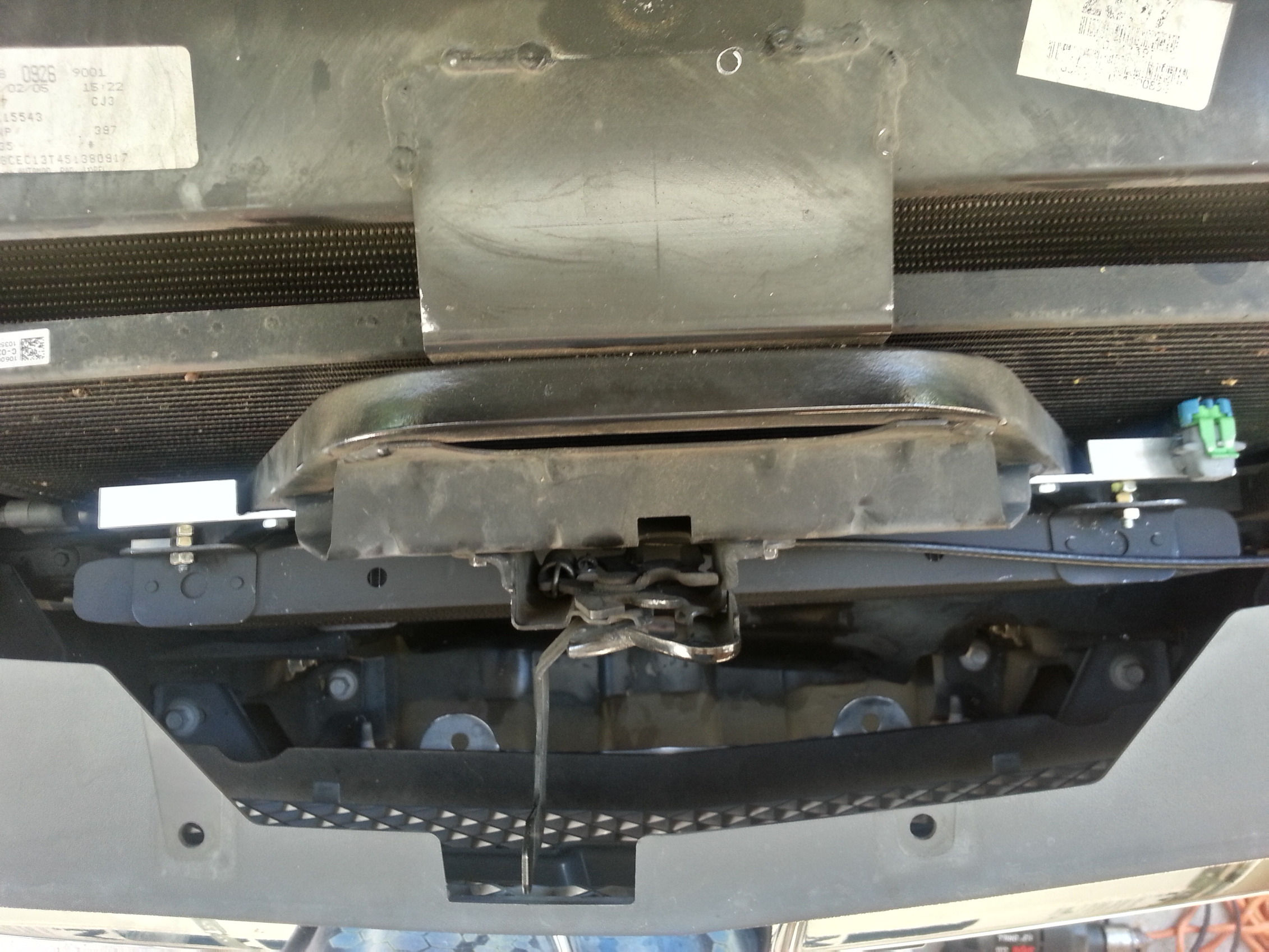

well got mine installed. took me a little over 3 hours working in 104º heat. gawd i hate summer.
