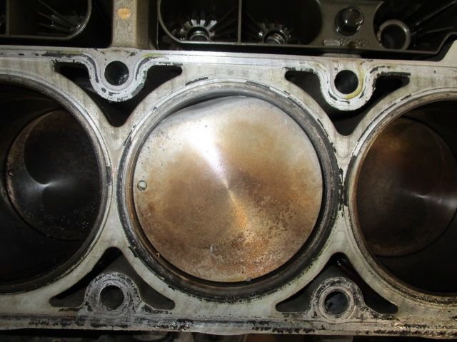

So I guess this is what a melted piston looks like! cylinder wall looks pretty damaged as well. The valves over that piston have metal shavings welded into them but I think the heads and valve train are ok other wise.
So does melted piston equal tuners fault? How do I find out what caused it to happen? Can I have the fuel injector tested to make sure its a 80# injector?

Here's a theory... What cylinders had the double stacked o rings on the injectors? Any chance they are the same ones that melted?
I suppose It's possible the extra o ring restricted the fuel going into the injector causing it to run lean.
I have seen a fuel pressure regulator before which someone tried to replace and it had another o ring bunched up behind it and blocked off fuel flow to the point it would only idle.

Melted piston is usually tuners fault...mismatched injector is a possibility, but unlikely.

Sounds like the guy who swapped injectors and tuned it sucks. Lesson learned, time to move away from that dude.

looks like my old nitrous motor when it leaned way out
