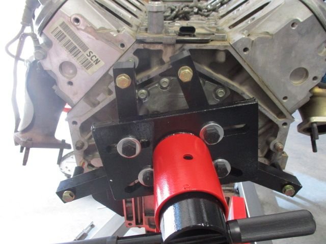

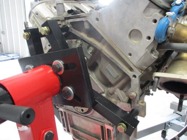

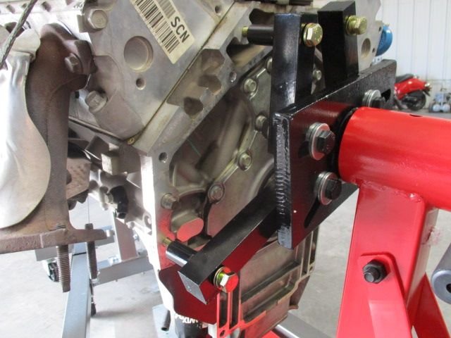

engine stands make me nervous especially this V8. How does this look? using 10.9 class bolts using the bellhouseing holes.
Old Mar 11, 2016 | 02:31 PM
  #217
kbracing96's Avatar
iTrader: (26)
Posts: 9,485
Likes: 31
From: Oakland, OR
That looks fine, you have a L33 5.3, all aluminum and higher compression. So it's even lighter then a normal 5.3, lol.
