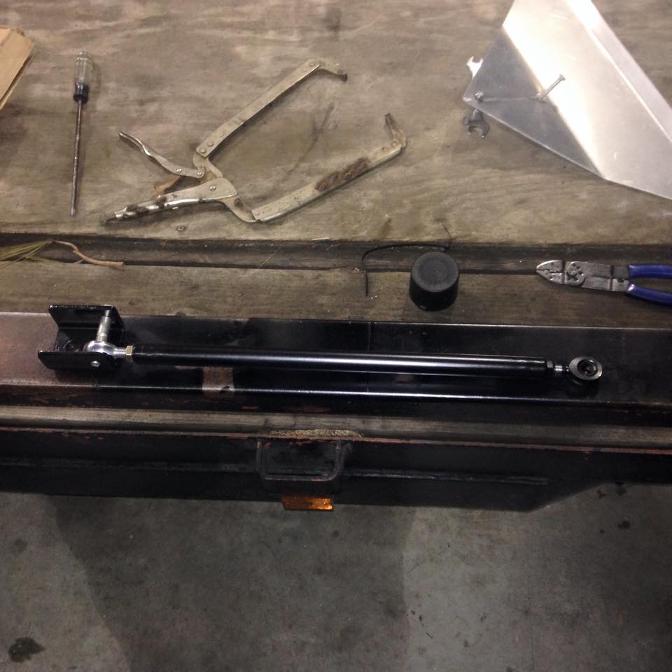

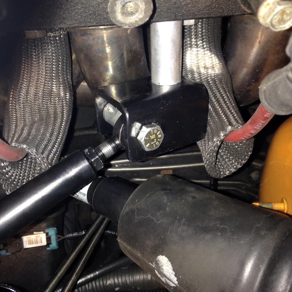

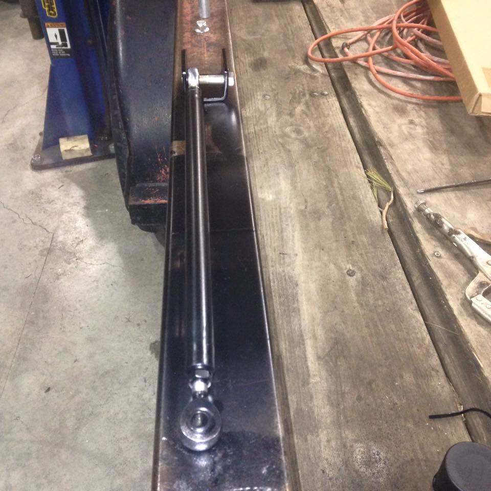

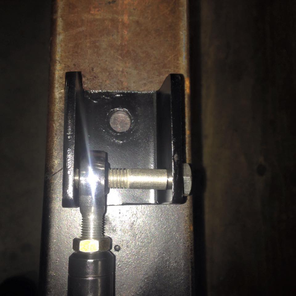

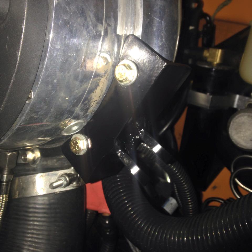

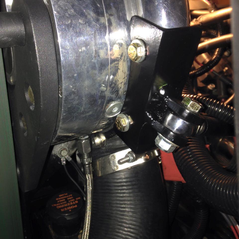

brace I've been making to do away with the main bracket flexing should work pretty good had it mounted up last night theres zero flex now
when i get it all painted up and mounted for good ill take some better pictures
