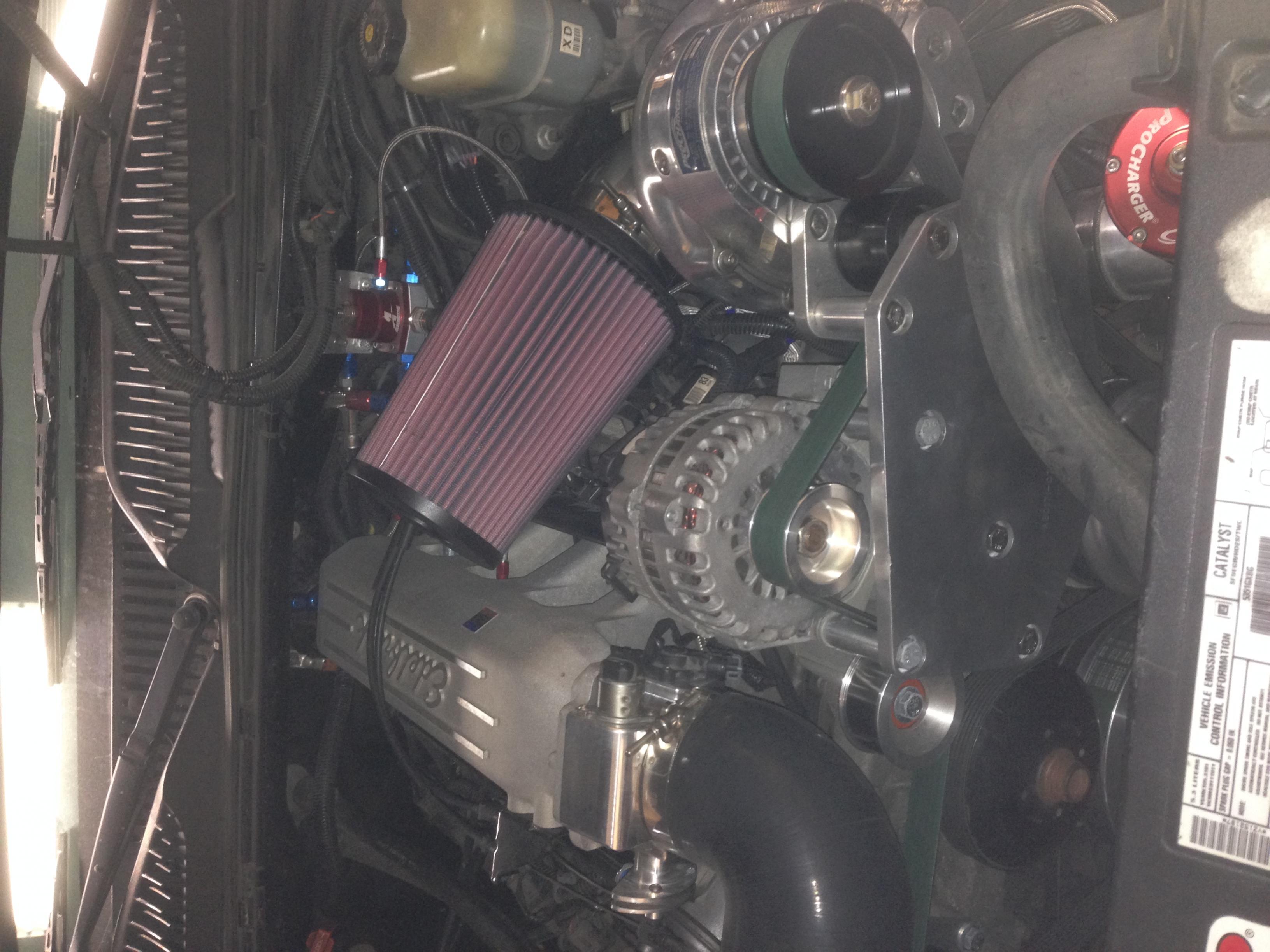

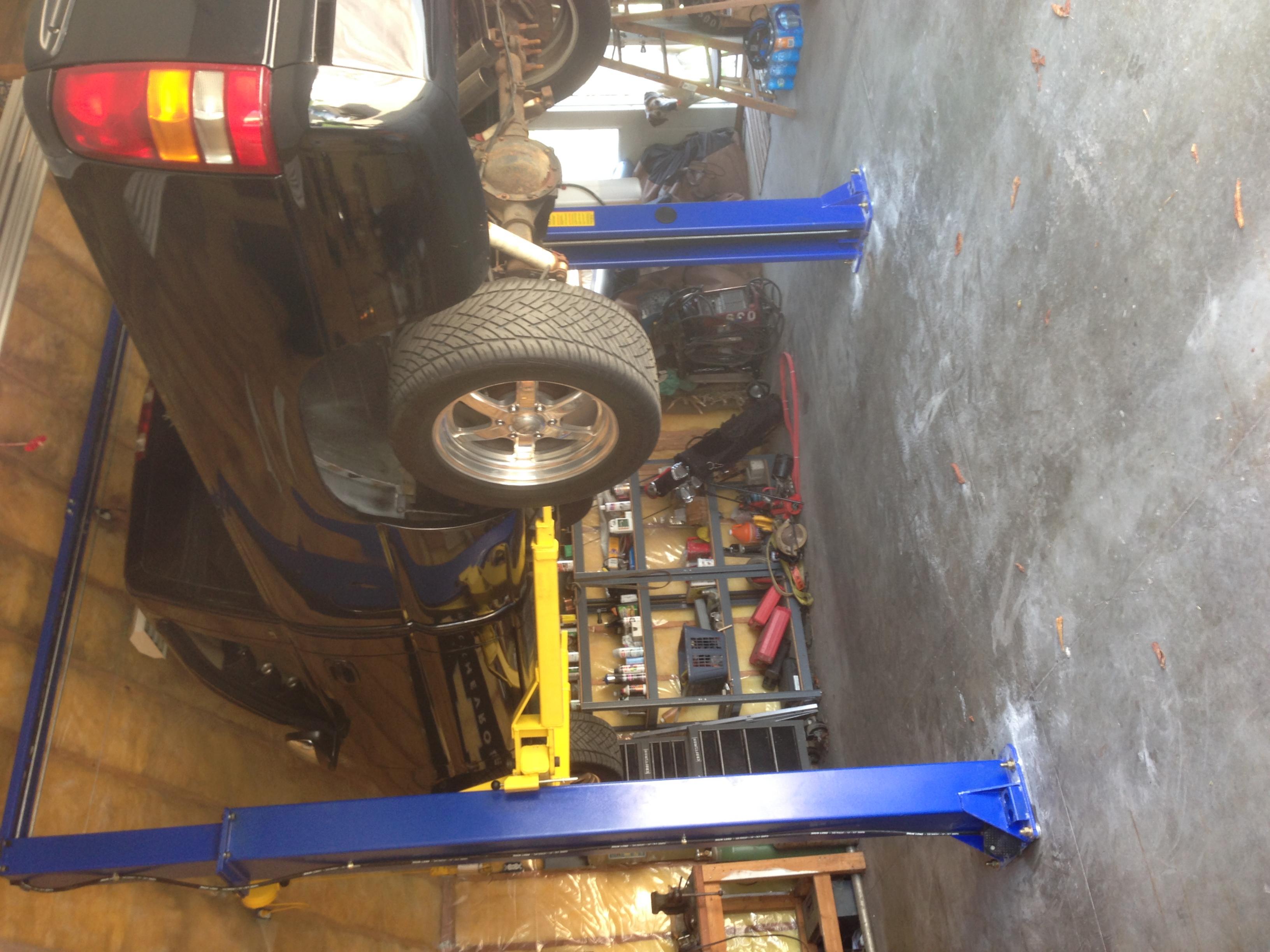

Well i really dont post alot on here anymore but frequent the site everyday. Pretty sick of listening to the same old turbo/cam thread.
But i have been busy on the truck! This thing really woke up when i dumped 16lbs of boost to the coals. gonna go ahead and max the blower out soon with a 3.55 pulley and lots of meth.
Just a few pics i took the other day. Removed the 4wd and installed Atomics coilover kit.
Attached Thumbnails Talk about prochargers-procharger-pic.jpg   Talk about prochargers-coilover-pic.jpg   Talk about prochargers-carlift.jpg
