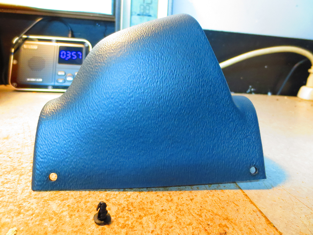

When you get the wideband let me know and I'll send you my old single Auto Meter gauge pod. It's painted graphite to match the interior and will save you $40 for the pod and $20 for the paint. I just installed a two gauge pod and this single is useless to me. You'll need to get four 5/16 christmas tree type push pins to fasten it to the pillar (shown in pic).
