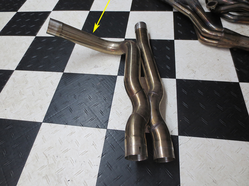

This is the AEM 30-0300 X Series wideband that I have...
AMAZON AMAZON
You can see the gauge and Bosch sensor to the left.
The center shows the included weld in bung.
The right shows the two harnesses.
The long one at the bottom connects the o2 sensor to the gauge.
The short harness at the top connects from the gauge to either the MVPI device (if you have that option) or to the A/C circuit or the EGR circuit. This is how the VCM scanner sotfware sees the wideband in HP Tuners.
This is where the bung is on my Speed Engineering true duals (opposite side) so I didn't need to weld in the bung that came with the kit.

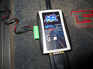

I have the older MVPI Pro which makes it simple to connect.
(my slight dyslexia is showing in this thread should be MPVI)

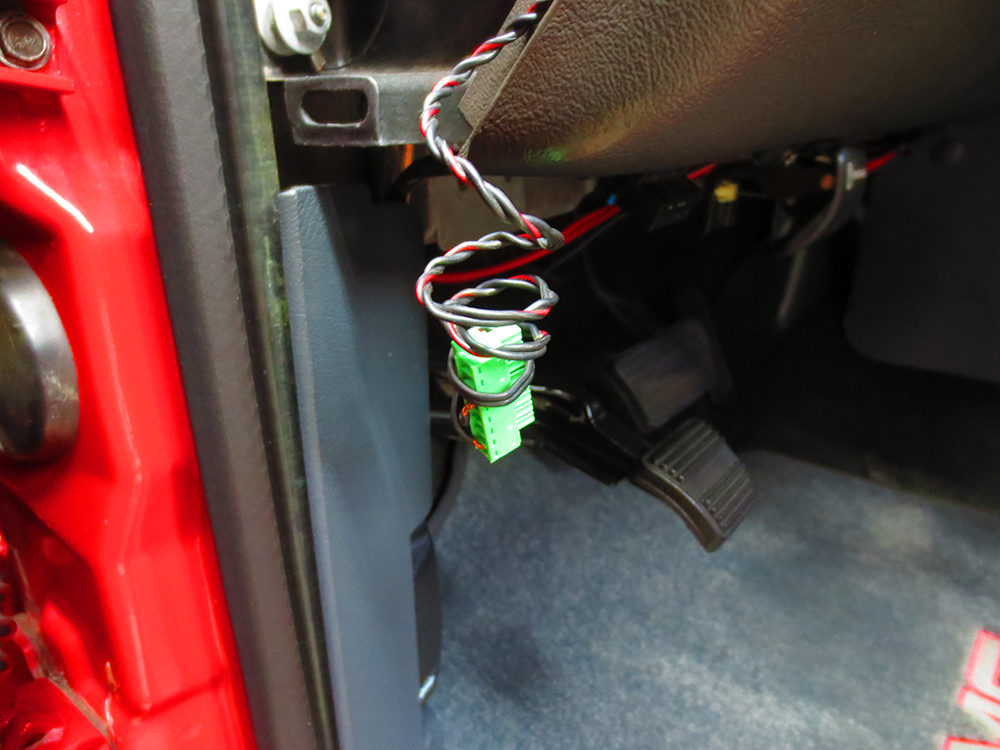

My setup:
I extended two wires to connect the Pro's green plug to the AEM short harness. I wind up the plug and wires and hide them inside the Dorito cover at the fuse box.

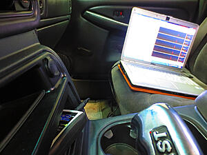

I simply plug the green connector to the MVPI and she's ready to log. With the Pro feature you don't need a laptop to log (see record button) but I like seeing that I'm actually logging so I always use the laptop.
I put the MVPI in the large console cubbie hole for protection then simply plug the USB to the laptop. I use a piece of masonite under the laptop to avoid the cloth seat from blocking the air vents, also keeps the heat off the passenger seat.
