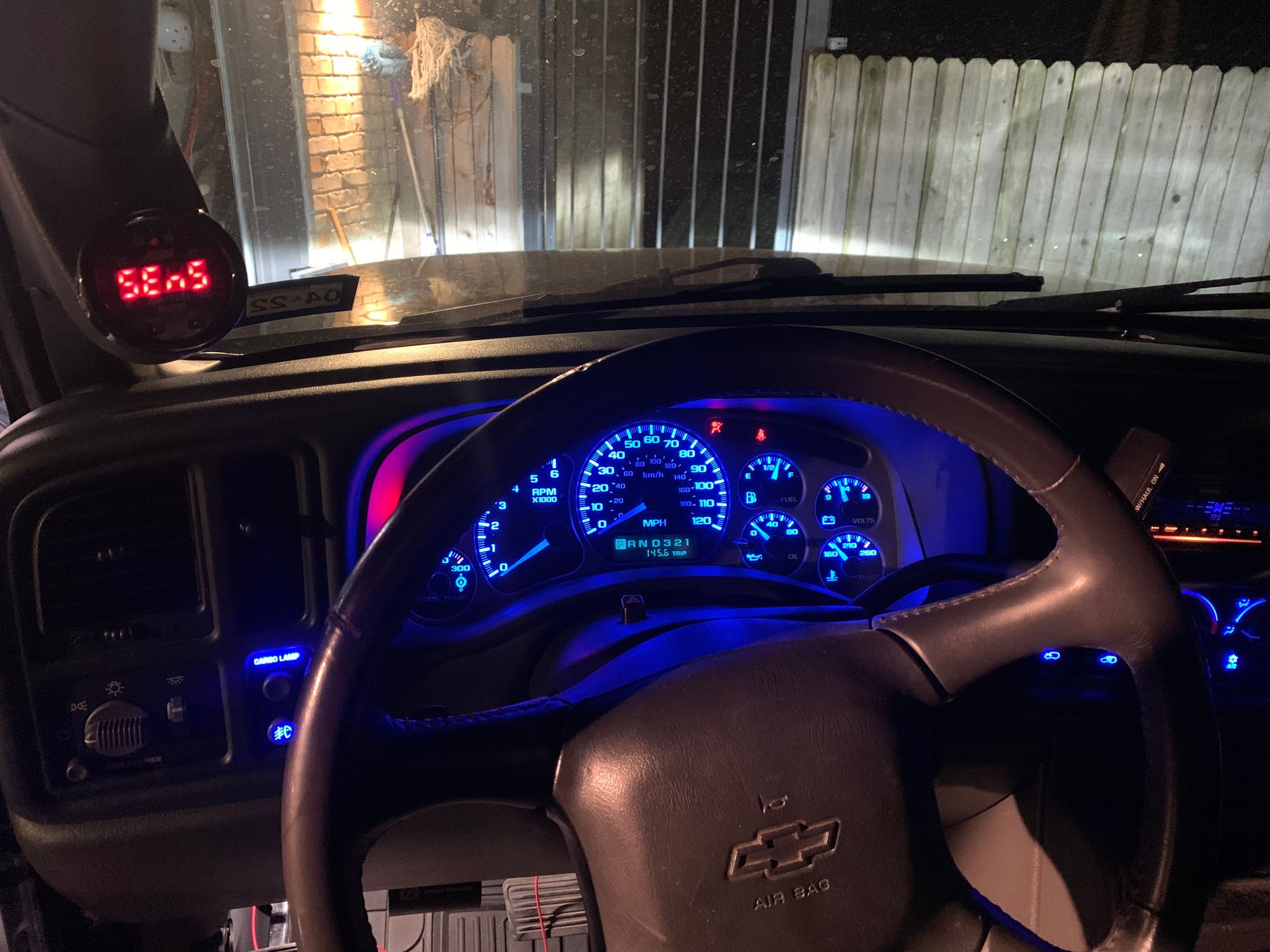

Gauge is wired up, plugs are gapped. Tomorrow is pulling the plugs, all the exhaust piping and installation. Also running my wideband harness but that is just a ziptie ez pz
Shoutout Red for the gauge pod!!!!
