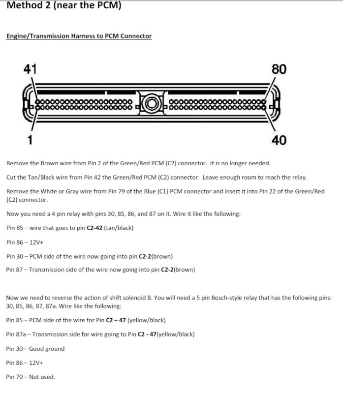

I found this info from a quick Google search, I believe this is the schematic everyone is talking about
If you want to delete PWM you need 1 relay, use one of these two schematics...
near the transmission
near the PCM
If you want to keep the PWM you need 2 relays, use one of these two schematics
near the PCM
