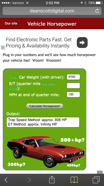

Actually George, 4700lbs and 130 trap shows about 800 with the math on the calculator. Not sure where your numbers come from, but the very definition of HP is a mathematical equation using weight, distance and time so pretty easy to calculate off a time slip.

Dyno sheet said 700 calculators say higher....cant always go off calculator

Id argue the opposite. Can't go off dyno.
