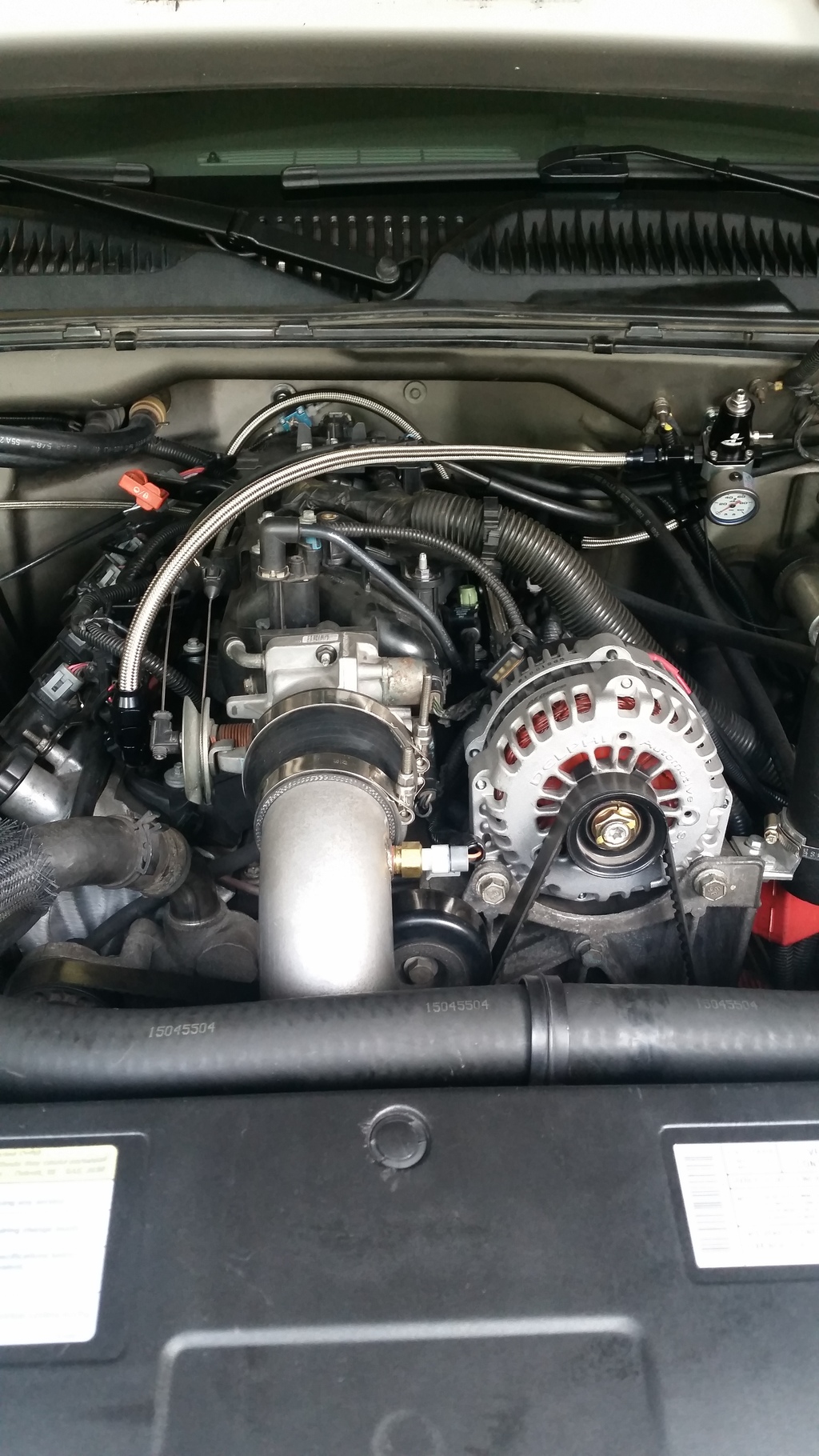

I looked back thru the thread and didn't see; Have you changed out the stock rails/regulator with aftermarket? Still on the 1000cc FIC injectors?
Old Nov 18, 2015 | 08:50 PM
  #410
GMCtrk's Avatar
iTrader: (27)
Posts: 12,275
Likes: 19
From: Dallas
Yes and yes to both questions. I'm still running stock fuel lines and filter from the firewall to the tank.
