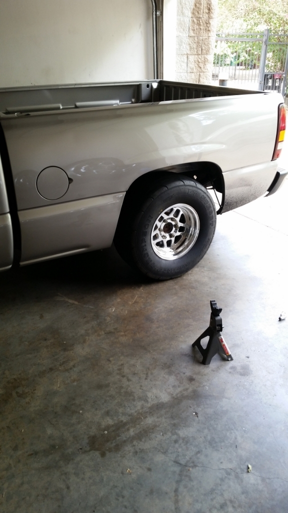

Edit: Retorqued the spring clamp bolts shy of 120 lb/ft. I don't see those moving anymore. I also clearanced the plate at the corners with the cutoff wheel for extra clearance to tire.
Also, here's a shot of the Wheels from the side with the 315s. I'm VERY happy with the 6.5" backspace. Even with the wider 315s they don't stick out unnecessarily and clearance to the leaf is great obviously versus my prior 7.25" BS wheels. (If anyone knows a good body guy in Houston please let me know!) When I buy the front Bogarts I plan to buy all 4 billet centercaps as well as new Mcgard lugnuts. For the time being I am using the stock lugnuts because last time the tech gave me a hard time about my rubber valve stem and I do believe you are supposed to have open lug nuts so they can confirm thread engagement.
