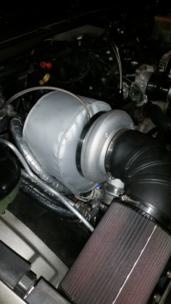

Atomic was correct (as usual). Fueling needed some loving but got it in line and man, this thing pulls like a beast on the highway on 21 psi.
Injectors went from 86% IDC on the 130 trap run to 104% now. My IATs are only rising 5-7 degrees over the course of a pull, so this turbo is much happier than the last one in its efficiency range.
One thing I noticed about the new converter....my 80e shifts are softer. Shouldn't the shifts be more pronounced with a tighter converter?
Also got this turbo blanket on. Thing is HUGE. Seems to be made for a full frame thumper turbo.

Over 100% idc means you are out of injector (or pump), period. Time to upgrade!
Old Nov 15, 2015 | 08:22 AM
  #370
George C....'s Avatar
Formerly ScreamingL
Joined: Oct 2003
Posts: 3,456
From: From the 412
Or fuel lines are under sized
