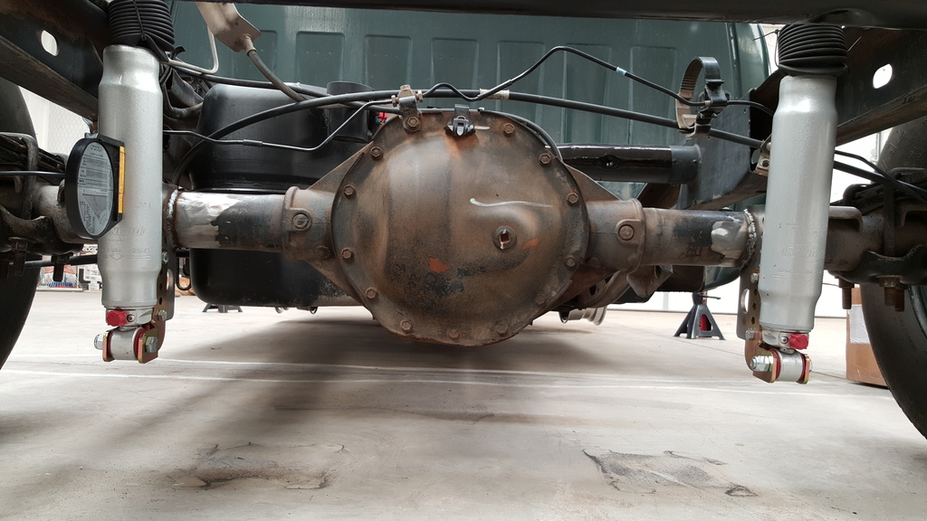

Updates:
Shocks stock location:

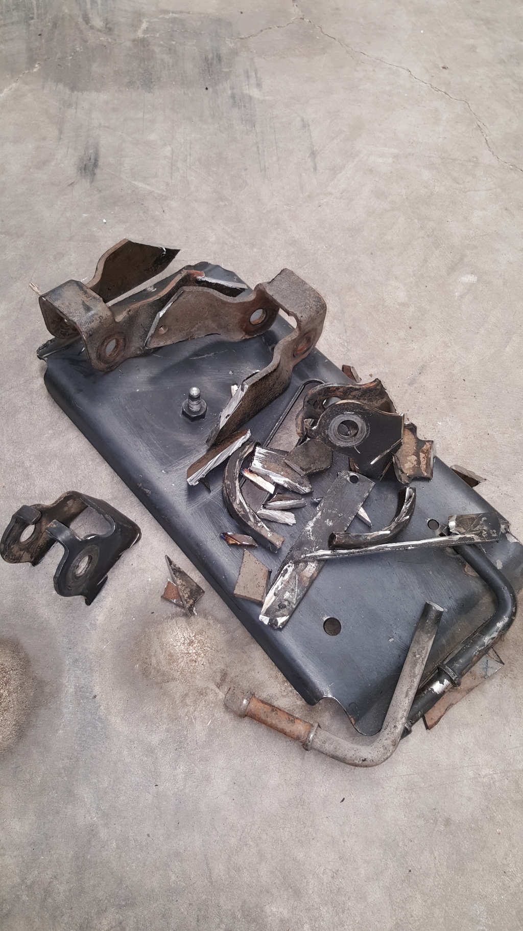

Parts i cut out

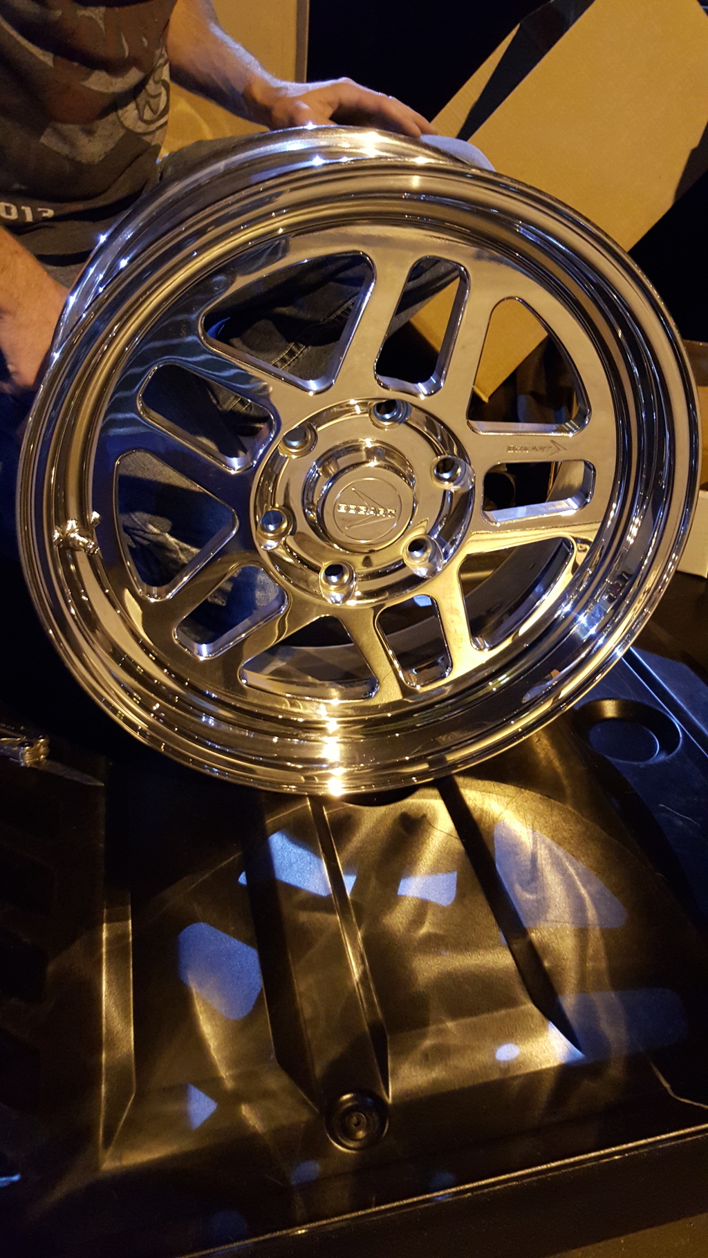

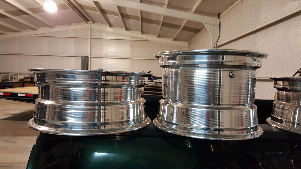

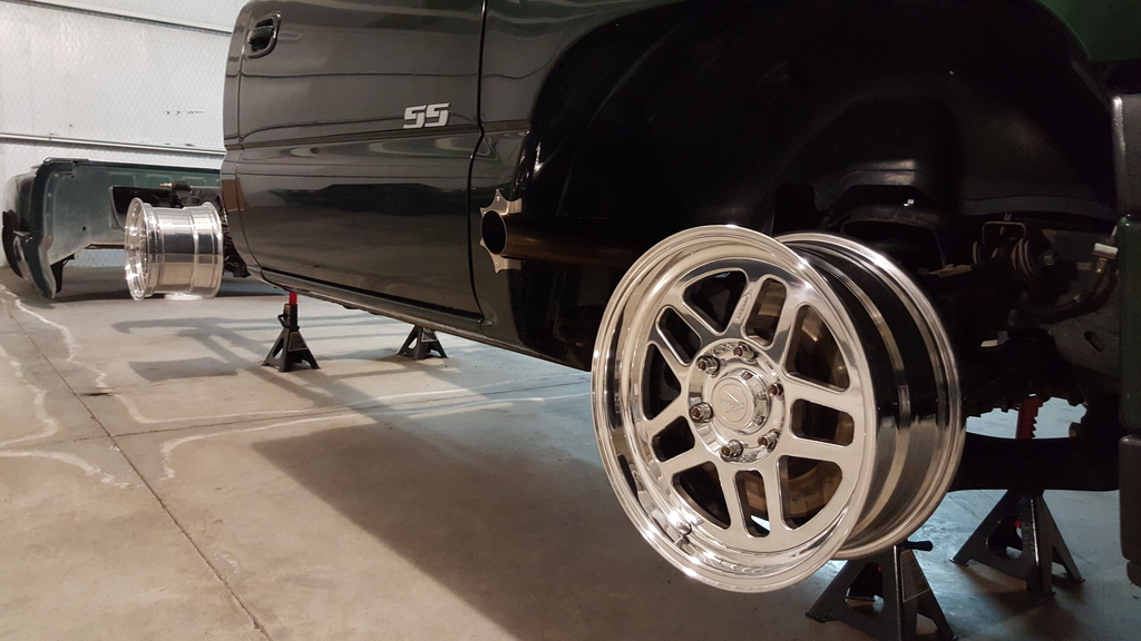

New Wheels
17x7 D10´s street/strip fronts
15x10 D10´s street strip rears

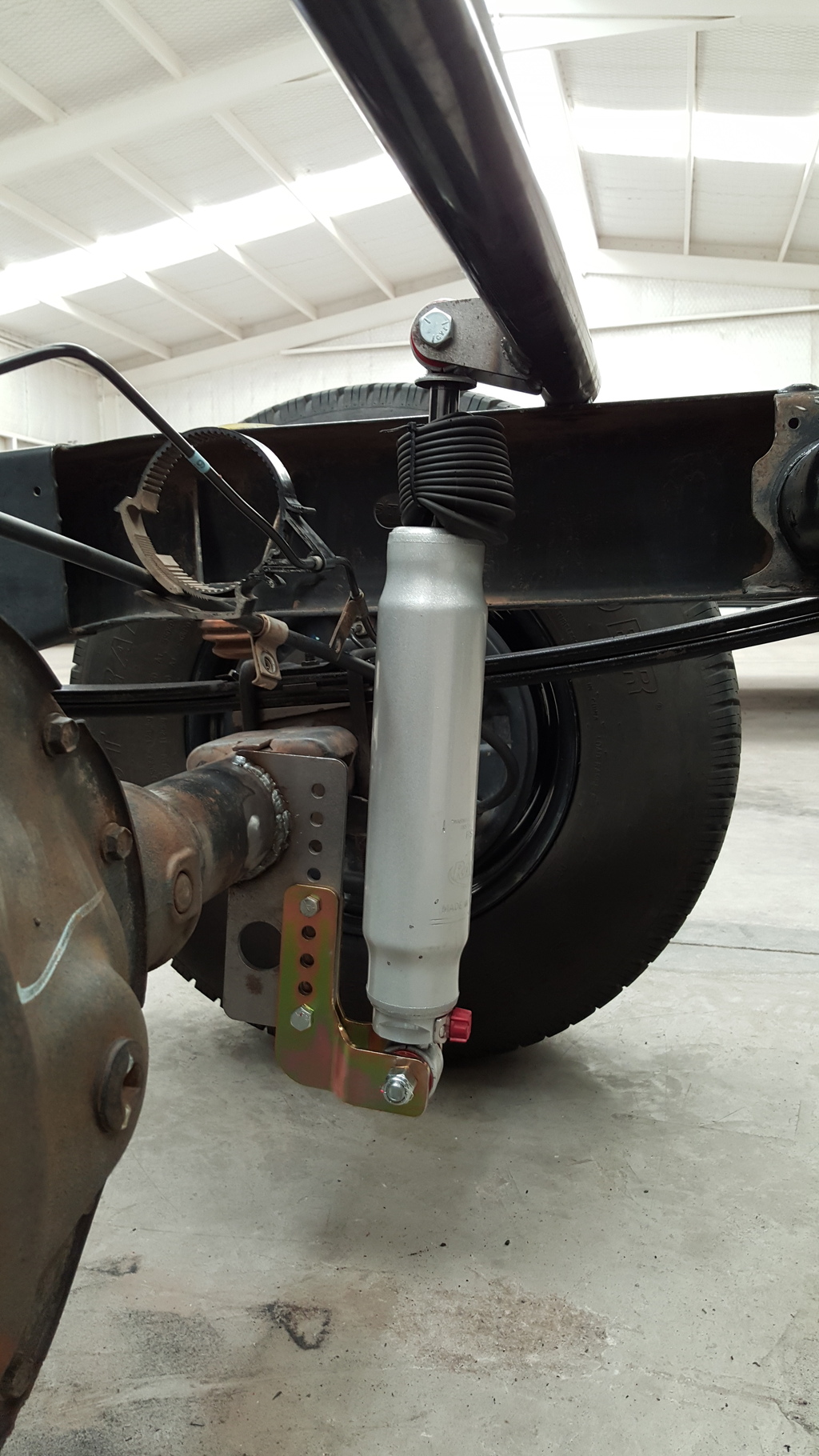

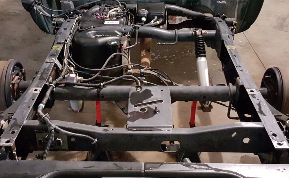

Brackets for new shock locations

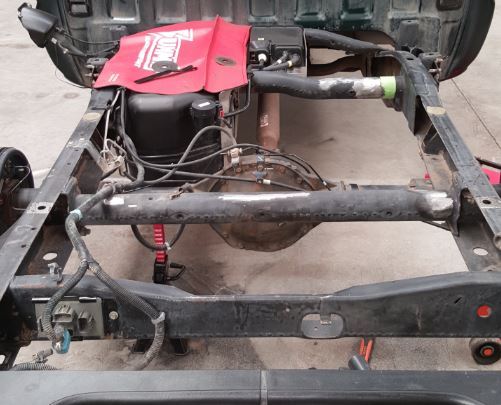

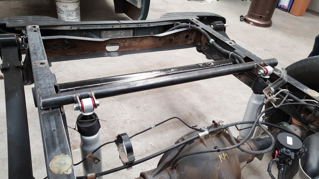

After everything installed shocks came out at 5 degrees

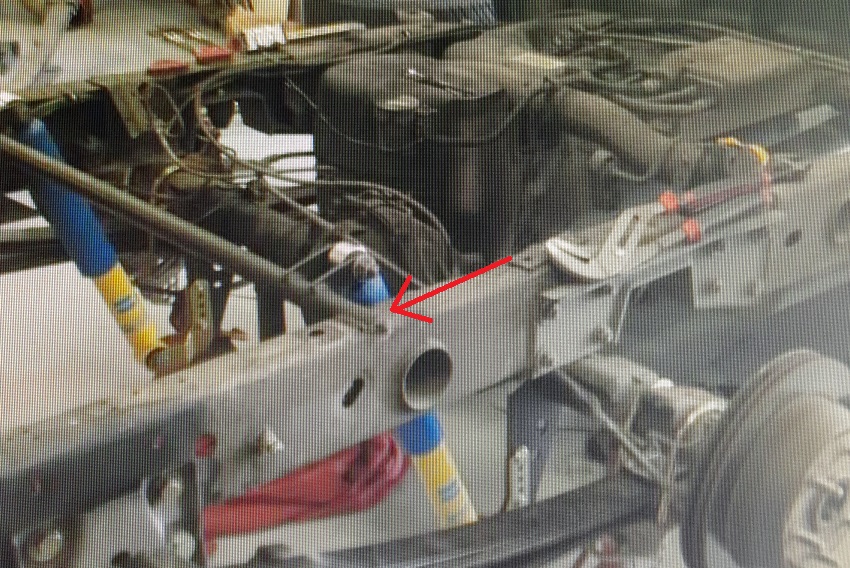

Question i have is why does everybody weld the crossmember like this and not laying on the frame like i did? i measured under my bed and i have the room for it, dont u want it as high as possible?
Crossmember isnt fully welded in i can still make changes that why im asking
