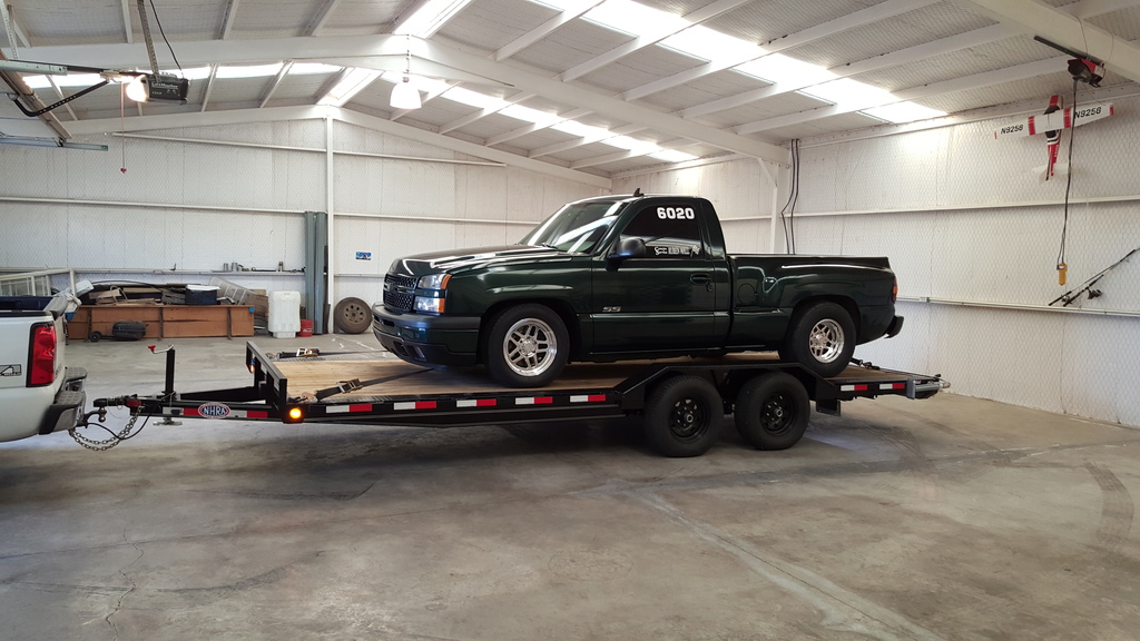

Ended up going with the 235/65-17 tires
truck got a little higher in the back with the new wheel combo

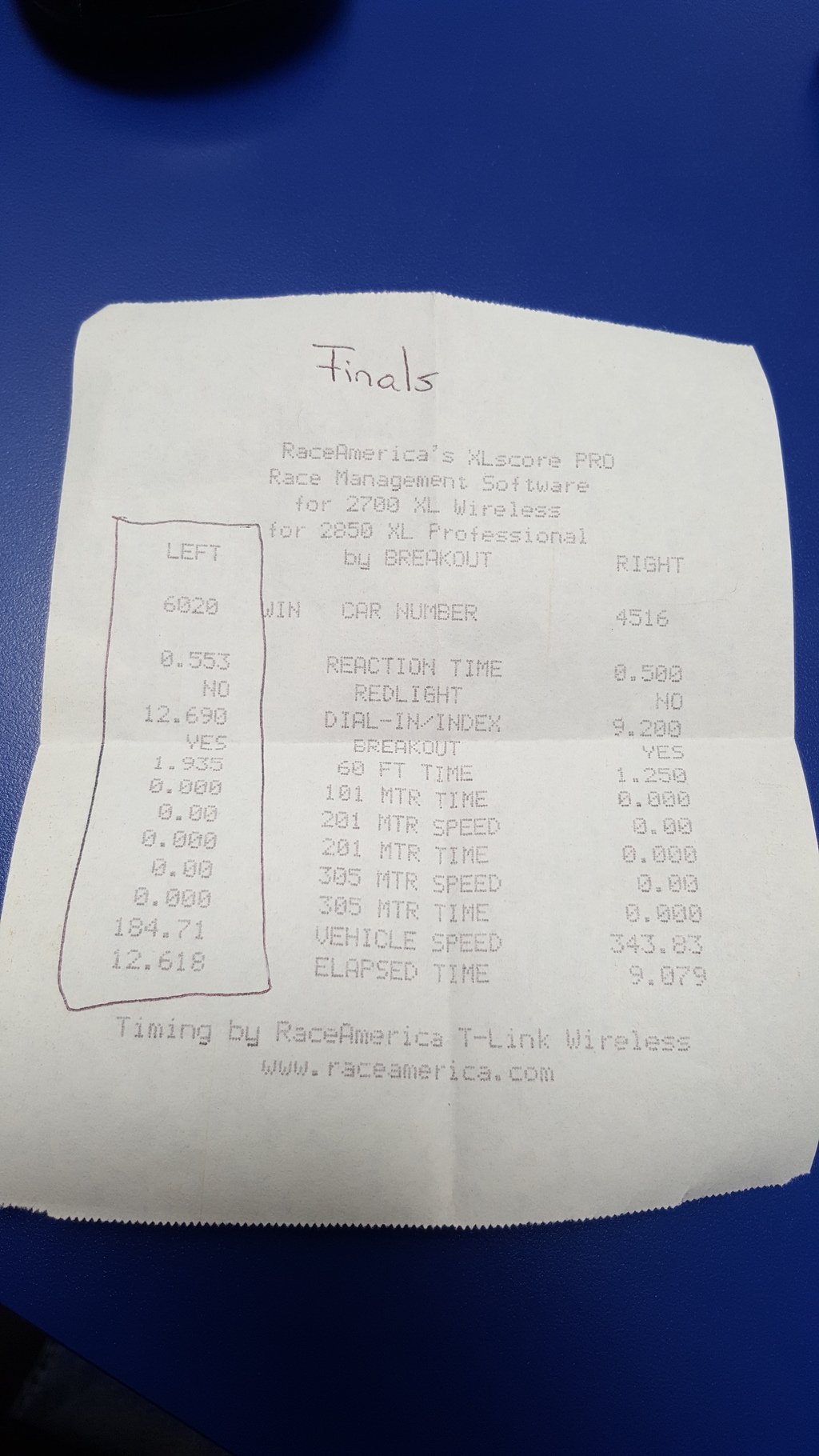

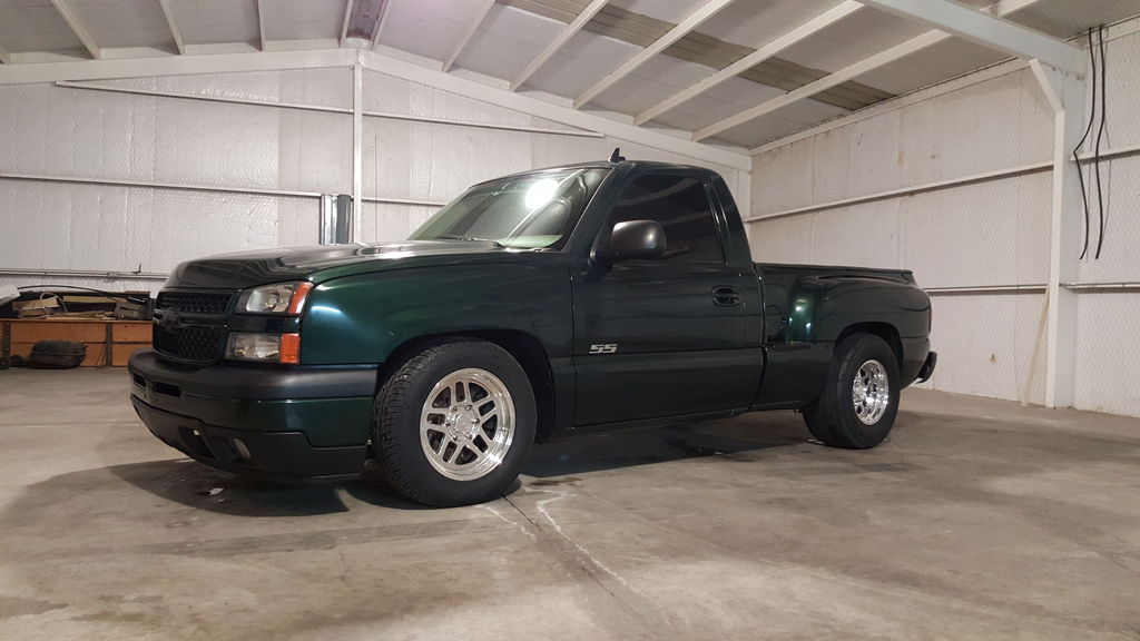

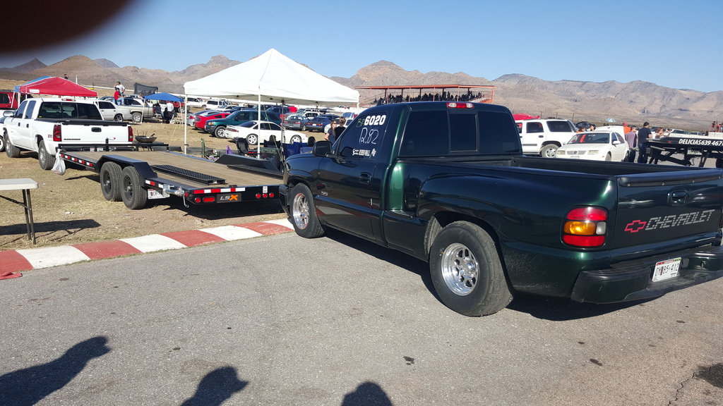

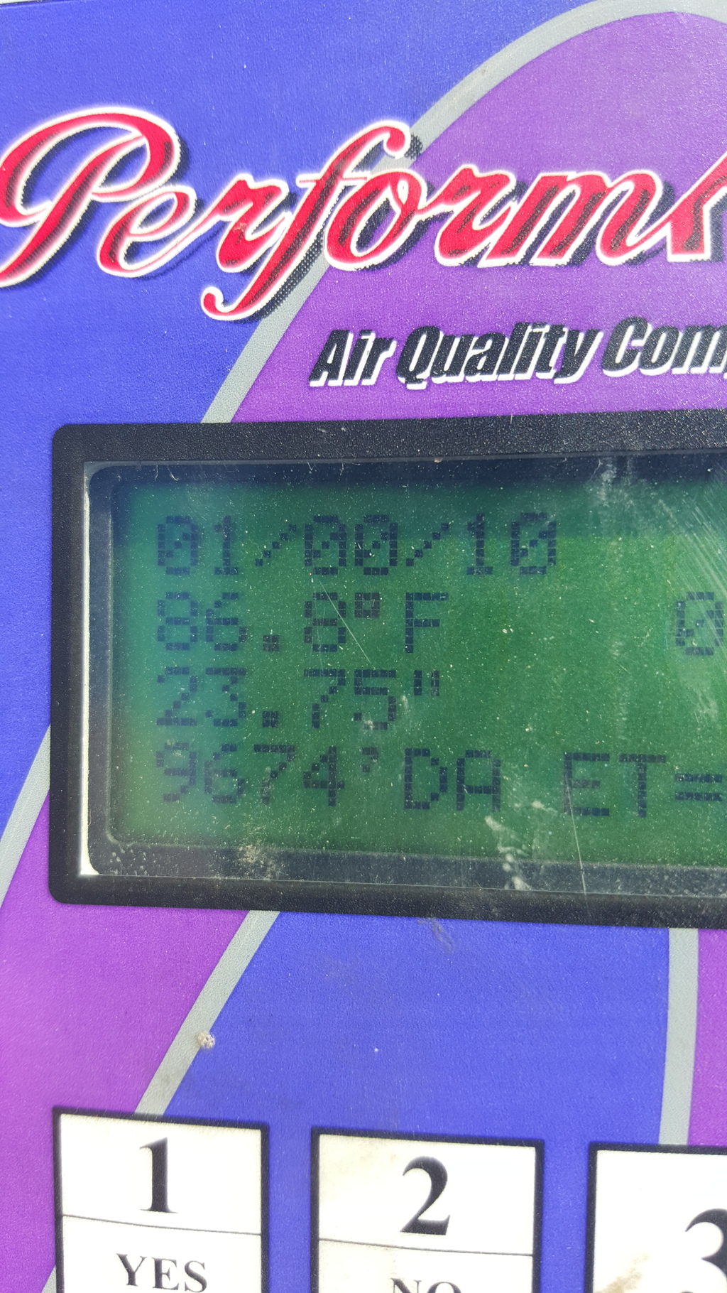

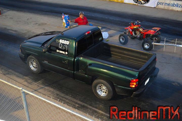

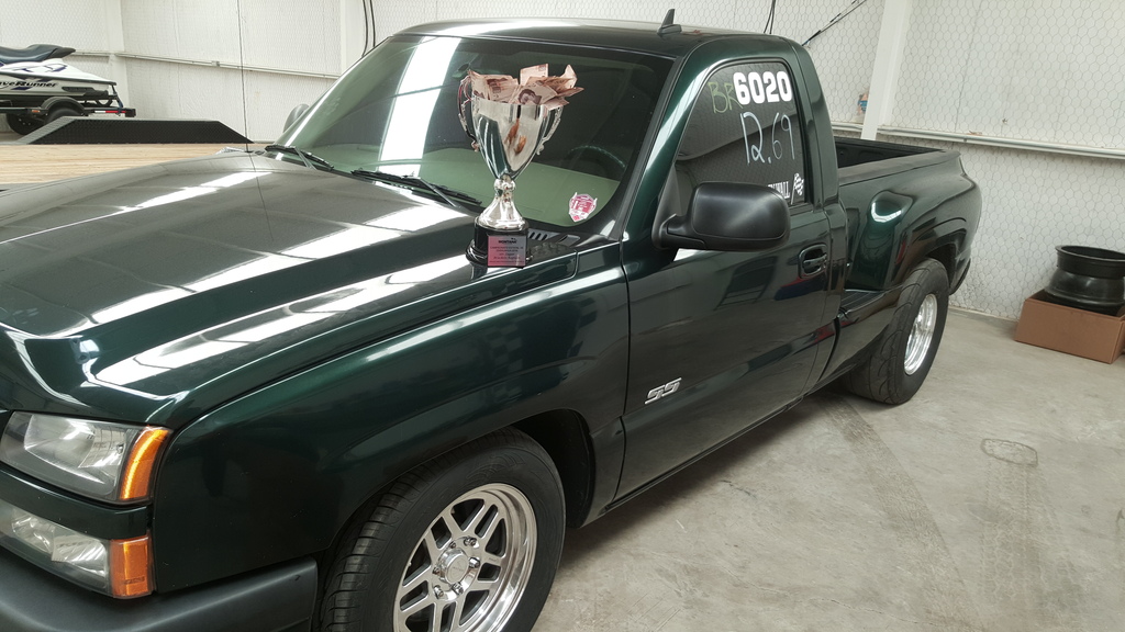

Had a good weekend bracket racing, was able to accomplish 3 important things:
-Not break anything
-Make my first 12 second pass ever
-Bring home first place in the biggest category we have here
My 60 feet arnt there yet but got a little better, i need a locker, 2 step and meth to run more timing, really hope that will bring it down to atleast 1.7x
Overall the truck went 0.4 faster this time then the last 2-3 times, im sure lighter wheels helped, maybe i use to have problem spinning a little after 60 feet not sure
Passes where made at 10 psi of boost and 8.5-10 degrees of timing

Old Mar 3, 2016 | 07:41 PM

Should be able to run alot more timing on 10 psi
Whats up with that mph?
Old Mar 3, 2016 | 08:31 PM
  #110
walledition's Avatar
Joined: Mar 2009
Posts: 1,500
Likes: 7
From: Chihuahua, Mexico
My IATS get to high (140+) and start to see knock if i throw a lot more timing at her, we only have "91" octane fuel here local
Its km's in miles it would be 114.79
