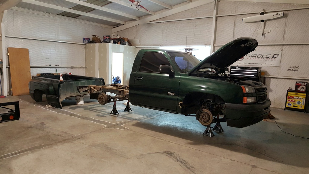

The shop was on the property when i bought the house, it wasnt complete, it needed the cement floor and all the electricity so i had to do that, when i first got there to look at the house i almost forgot about the house when i saw the shop i was all over the shop lol
So i dont really know what it would cost to build it from scratch.

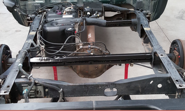

Time for an update, while waiting for my bogarts and tires i started working on:
-New traccion bars
-Vertical shock mounts

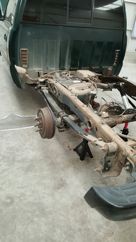

Apart without cleaning:
After cleaning and cleaning for hours

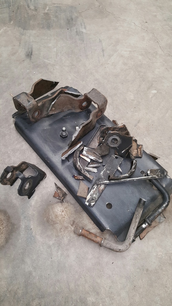

After cutting stock muffler hangers im not using anymore, spare tire mount and shock mounts

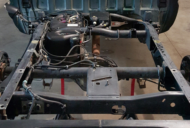

After a little paint

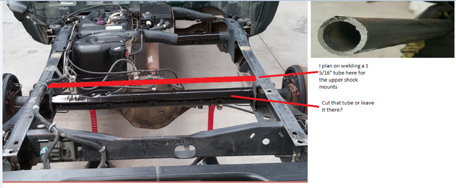

And some questions:

If anybody had any pictures of similar behind axle shock relocating setup i would appreciate it

I just put both to the same factory crossmember, but I think yours is lower than mine. You could probably remove that factory tube if you are putting a new one in.
I cut that crossmember out, made a new one that rises up closer to bed..try to keep shocks at 90* or leaned as much as say 10*
If ya gonna do it may as well stand them up correctly, also keep them as far apart as possible for leverage control
Pics are in my build thread amd i used 1 5/8 tube
