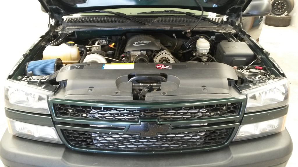

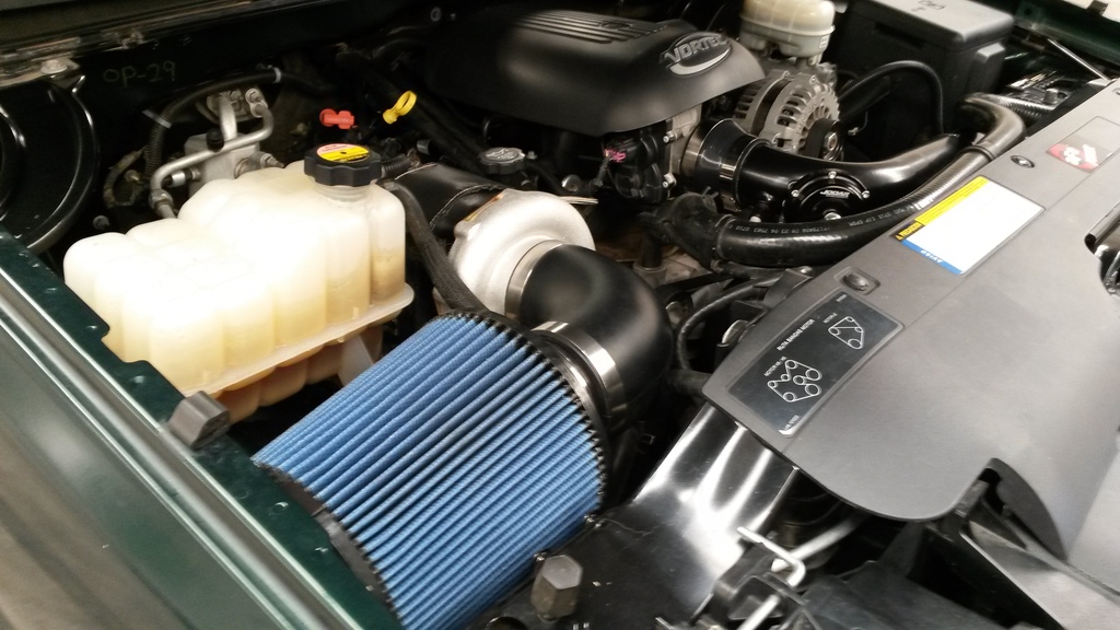

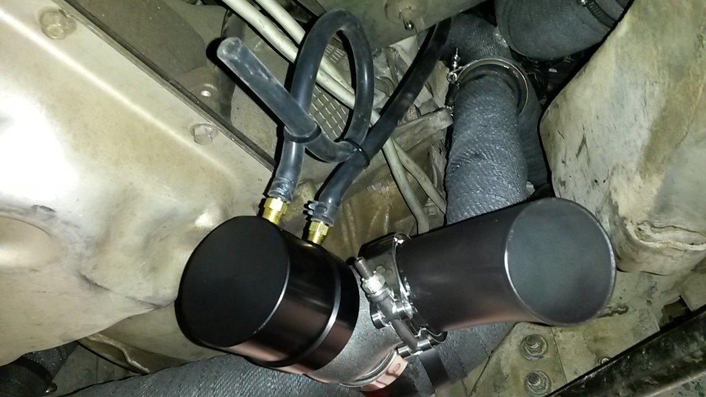

Update: Got a afe filter installed, they have a option to built it in there website at the size you need it, this was actually the biggest they had with a 4" flange diameter, fits pretty good, had to make a small braket to hold it down so i could close the hood
The 90 degree 4" rubber elbow i got from ebay, since they are a bit soft i wonder if they never suck together at high boost, i guees we will find out
Im thinking maybe i should built a wall around the filter so the hot air doesnt get to it so easy, wonder how much that helps, has anyone made any experiments on that??

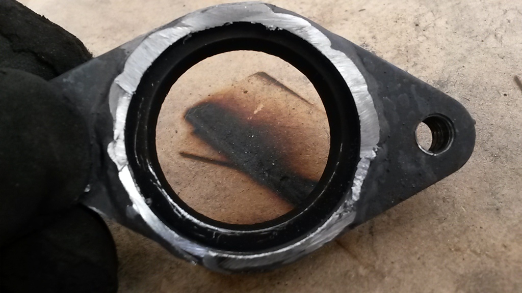

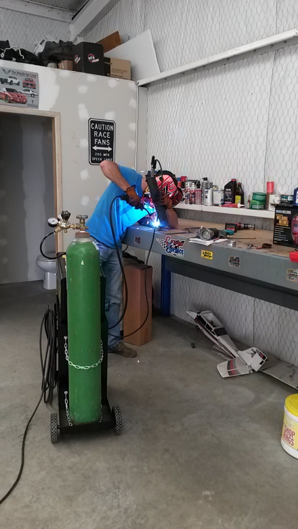

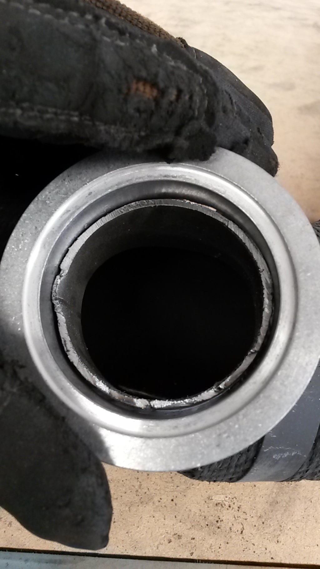

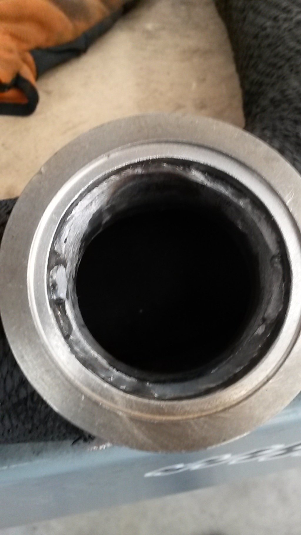

I havnt updated in a while cuz things got slow but have some small updates

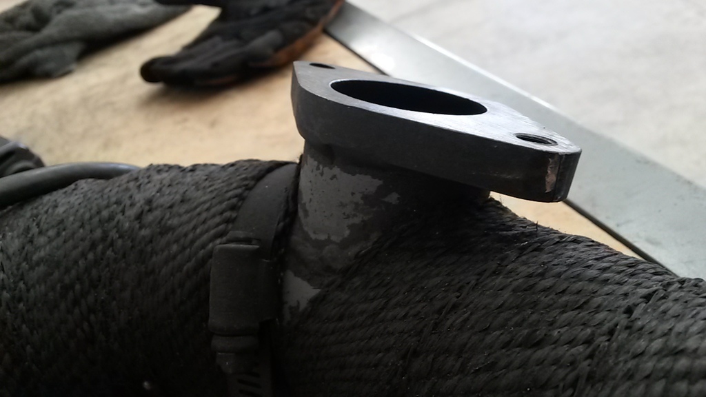

I ended up having a boost creep, 40mm wg and without the spring i could make 15+ psi so i changed my 2 bolt 40mm wastegate for a 50mm vband wastegate, now i see 10 psi with a 7 psi spring, works for me since i dont wana run lower then 10 psi
Havnt installed the Hallman Pro RX Manual Boost Controller yet

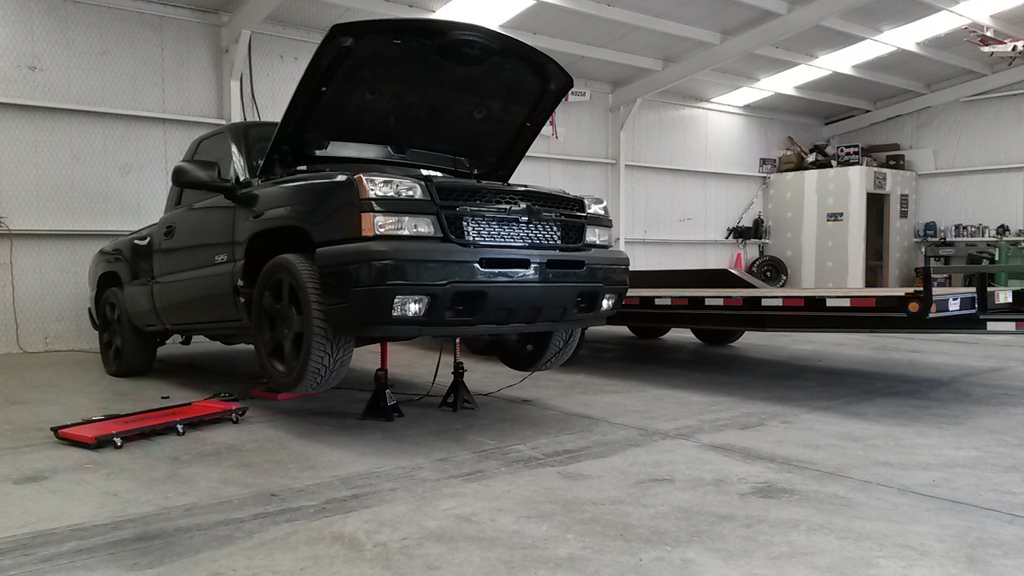

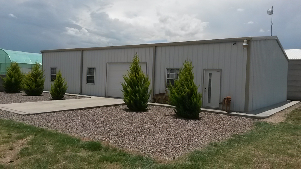

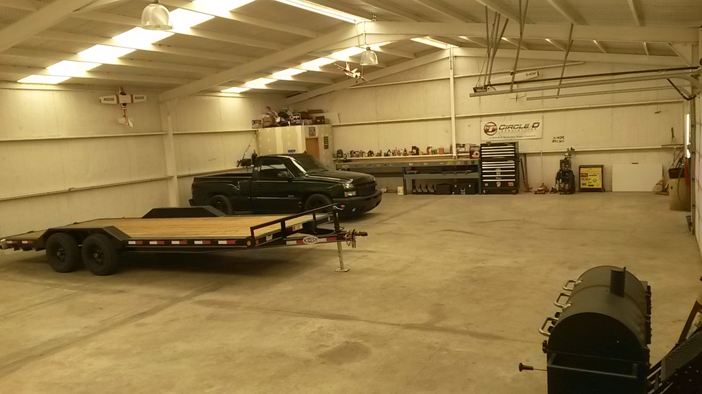

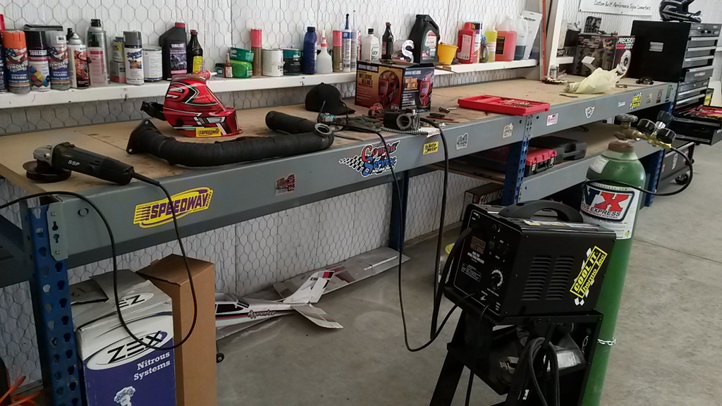

40x60ft shop
