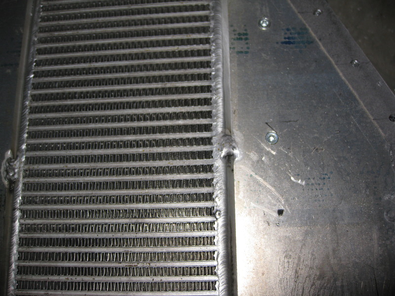

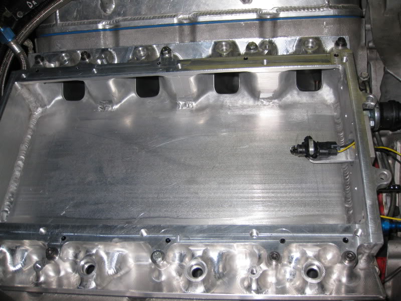

Maybe they forgot to put a divider in the IC core tank...Lol. Is the core sealed to the upper?
Think I will install a pre IC IAT sensor and in/out coolant sensors to see what mine is doing. I am seeing way more heat than you on my IATs. I have my sensor mounted right in my lower.
I am thinking that the increased pressure from the bigger pump(currently running a Meziere which Lingenfelter says is weak) might at least force the coolant to flow more evenly through all the crossflow IC tubes.
I wonder what lining the floor of the lower with a super insulator like aerogel tiles $$$ would do?
