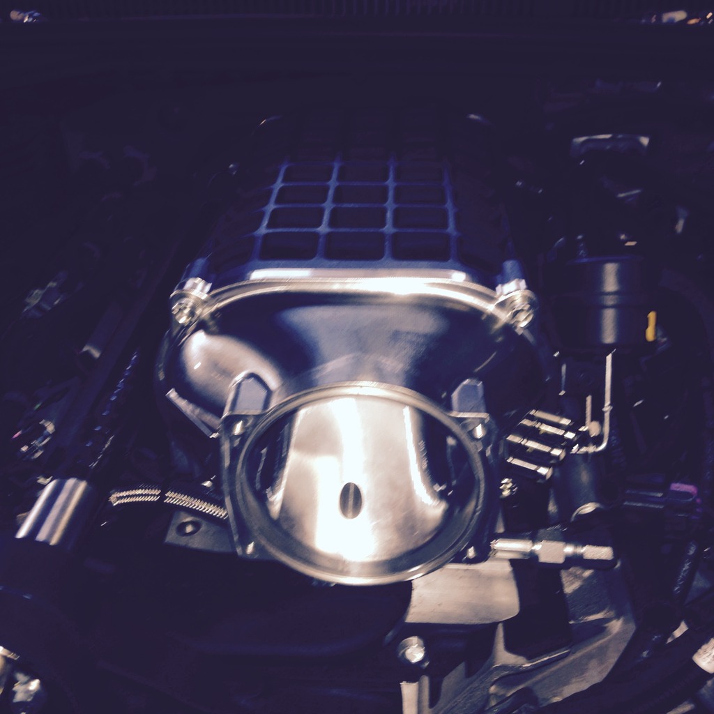

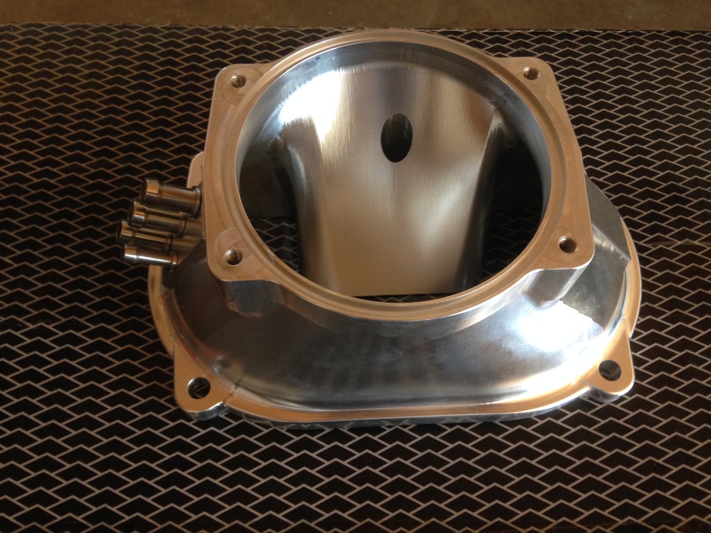

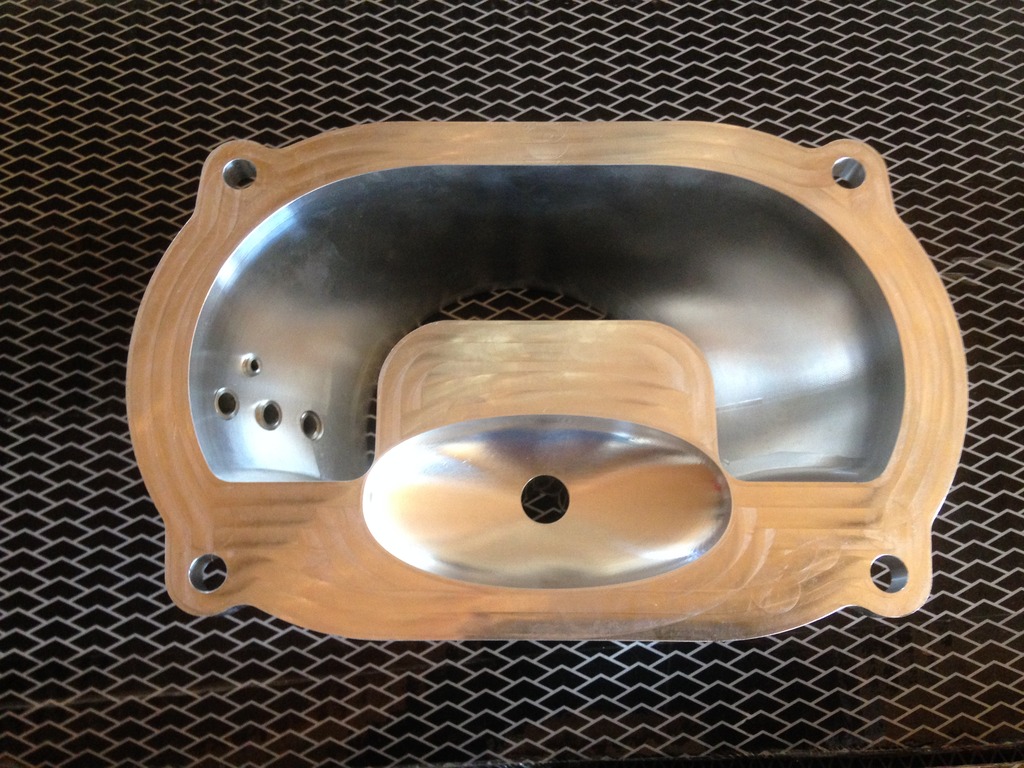

You should get a snout like this for your JS setup, helps with throttle response too:

They sure aren't cheap. Have you run one, or are you just basing it off what Joe says?
The entire blow off through that tiny little port, huh? Maybe thats why it improves response.
The original idea came from Kenny Duttweiler many years ago.........I happened to be in his shop one of the times he and Joe were testing Joe's LSx/Magnuson motor and he(Duttweiler) mentioned this mod and wondered if somebody might manufacture it as a way to increase airflow. The concept is sound as a means to increase airflow as far as I know; a similar design is used in the older chevy inline 6 motors in what's called a "lump port".....check it out: Things you need to know about Your L6 Head Before Installing your Bolt in Lumps
We are talking max effort here, Joe's motor was making power in the low/mid 900's before he started to manufacture this mod if I remember correctly........obviously, he would have the more accurate facts on this.
anyway....that's what I know/or remember

Yeah thats my SS sedan setup in the pic above. She is just a daily driver that i take to 1/4 on fridays, road course once a month, and pick on the ctsv's and vettes on my commute to work all while rowing the gears. This is basically the only mod to the car besides 2" primary headers and its right at 600whp fuel limited.
Duttweilwer and leftcoast run this piece on their 1000hp js2300 390. There are similiar snouts for tvs front drive setups and lsa also, but dont think joe and friends made those.
The tiny port is for the bypass port thats used under low load/boost. So i guess you might be giving up some mpg on freeway cruising but the improvement in the intial boost ramp, and the dyno tq graph the drop was pushed back so it pulled longer up top when the rotors are spinning at full tilt. (Currently running underdrive cog now, so rotor speed is probably only 20k)
My SS saw roughly 45 hp improvement with just that mod on a stock ls3 wIth headers. I should have done the nw102 and intake to get full potential, but didnt want to go through additional tuning headache of dbw tb as was short on time.
