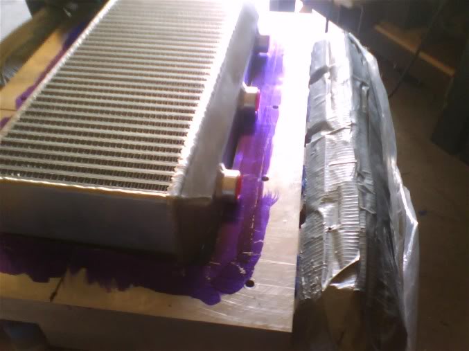

IC core is 16 (or 18) x 6 x 3in thick. I moved the ports on both tanks to the front, so not the same as this old photo.
Current HX is an AFCO unit with dual fans mounted at an angle down between the frame rails ahead of the crossmember. Not sure this is the best location being so close to the track surface on a hot sunny day.
Might have more room up front if I lose the AC. They didn't leave much room there on the old AVs.
