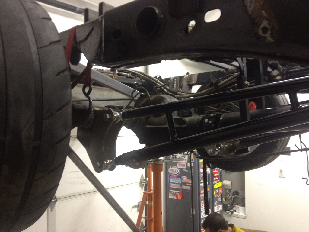

Good news is that my rear suspension is done and it's really really good! It consist of truck arms/bars, a pan hard bar and some coil over fox shocks.
Thanks to Henry for designing it and Dusty for welding it up when Henry got in an accident and busted his shoulder. It really rides amazing, can't believe how perfect it rides now, almost feels like I'm driving in a sedan as far as the rear suspension is concerened. I do have coil-overs for the front but there wasn't the opportunity to install then with Henry's injury, maybe later, hopefully.

I want to see this new rear suspension set up man where are the pics?

Dusty do you have any pictures of your handy work? I have some pics on my phone but I cannot post them on here from my phone, unless I can text them to somebody?

Wow! That looks top notch.

Very nice work, the suspension setup looks really kickass

love the rear suspension! morepics!
