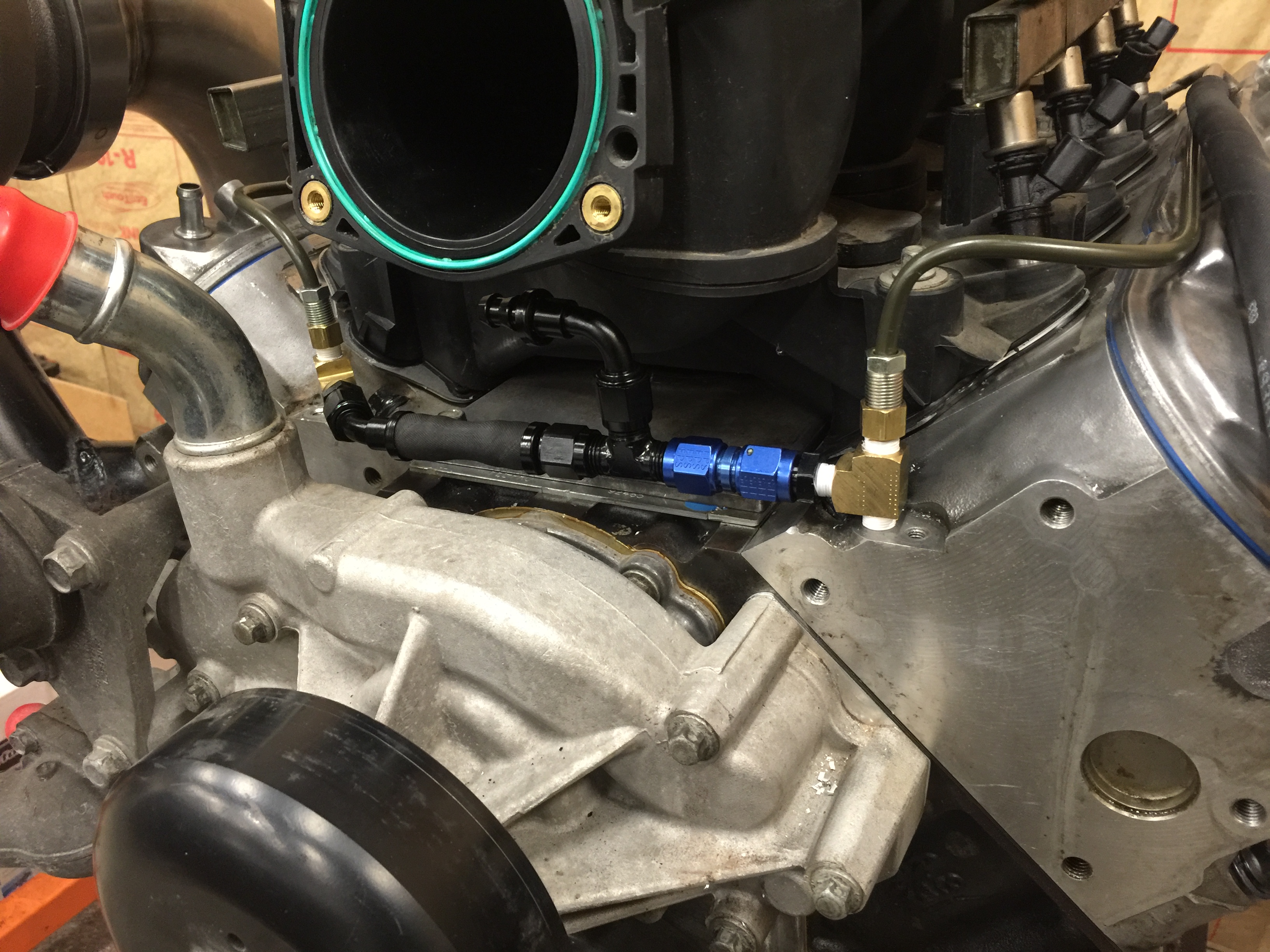

A cheap steam vent setup I made turned out alright. I need to paint the blue one.. Kinda stands out.. Had about 60$ in the setup maybe less.

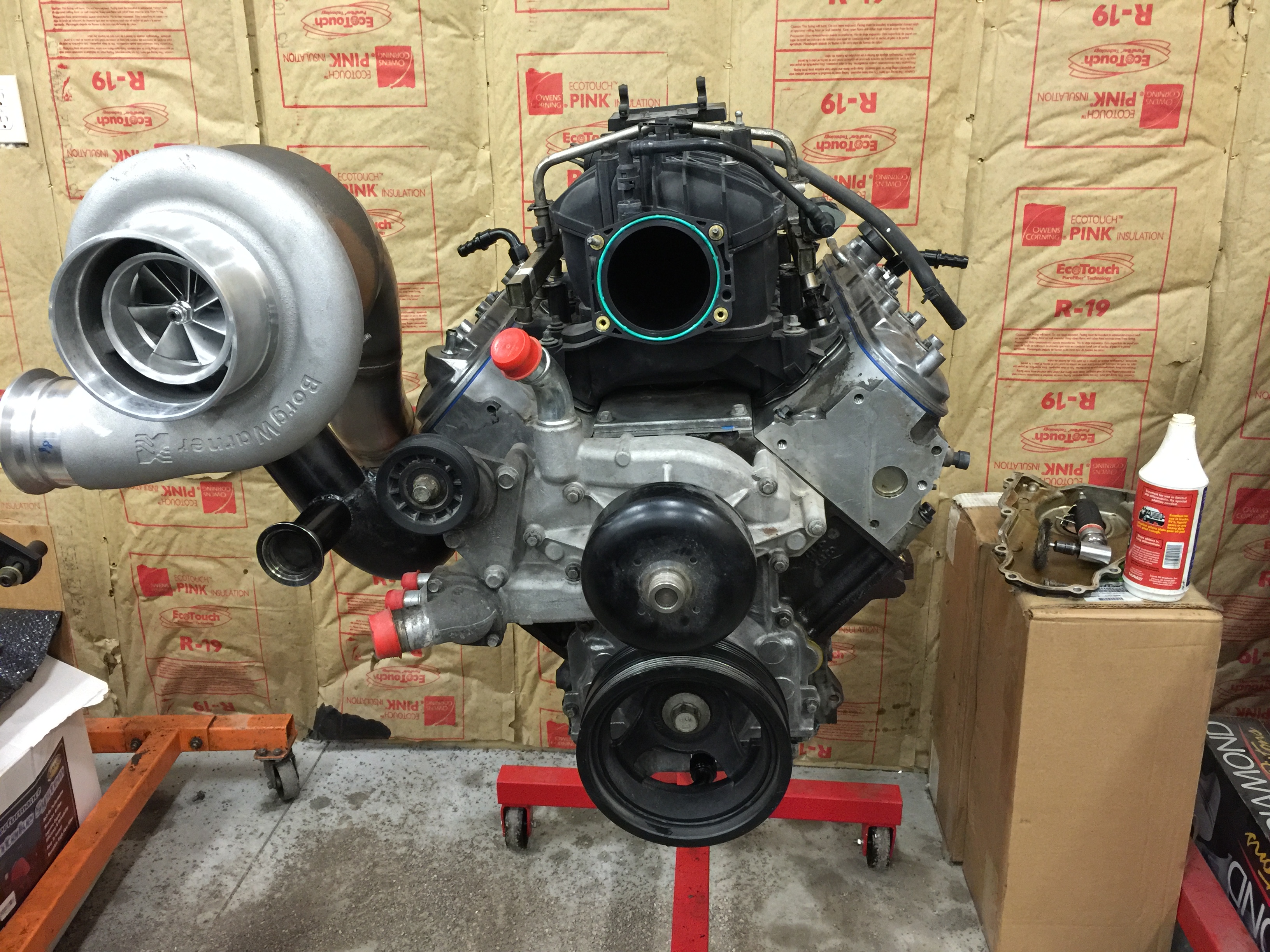

And a pic from behind

Looks good. what did you use?
I made it out of 1/4" brake line, and at the front I converted it to an -6 and connected the two banks with push lock hose I like it I use it on all kinds of things.

I did some mock up, been fitting the oil lines and drains, and the dual gates

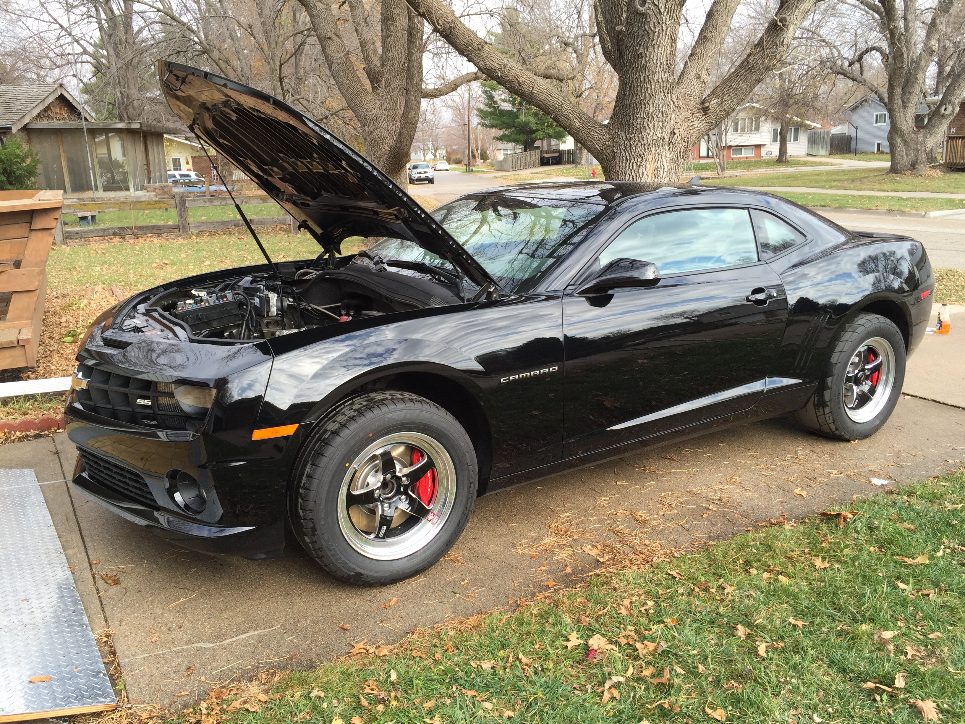

Me too should be interesting. Hopefully it keeps the rods in the block for a while.. I've been so busy here at the shop. I took on a gem 5 Camaro project as well here I bought as a roller and plan to flip it when done on top of all my day-day work. It's a 13 1LE Camaro I bought has 8500 miles on it.
