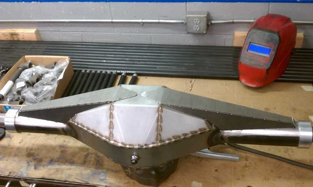

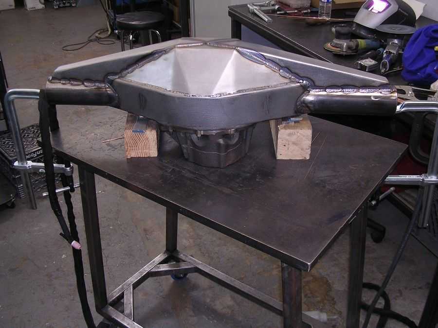

I use a 2 inch line up bar. The pucks for the Tube are custom made. I usually buy my center section line up rings from Mark Williams Unless the don't have anything.
I weld the tubes in with some custom made end pucks. After they are fully welded, I fit a back brace. Once it's ready to weld, I clamp it down with big welding clamps as shown in the pics below. It's putting some preload in it at the tube end to avoid the tube from being sucked backwards when the brace is welded up.
After the back brace is done I fit the 4 link brackets. Once its all welded, Then the ends get fitted and welded on.

Had to go way back to find some pictures.
I use a 2 inch line up bar. The pucks for the Tube are custom made. I usually by my center section line up rings from Mark Williams Unless the don't have anything.

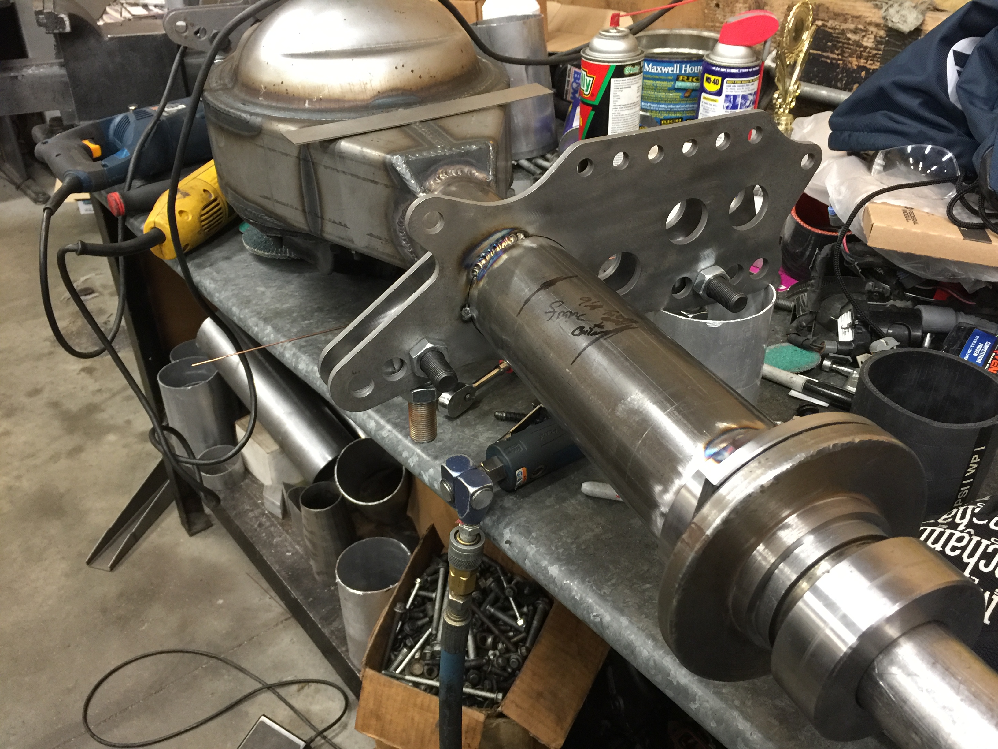

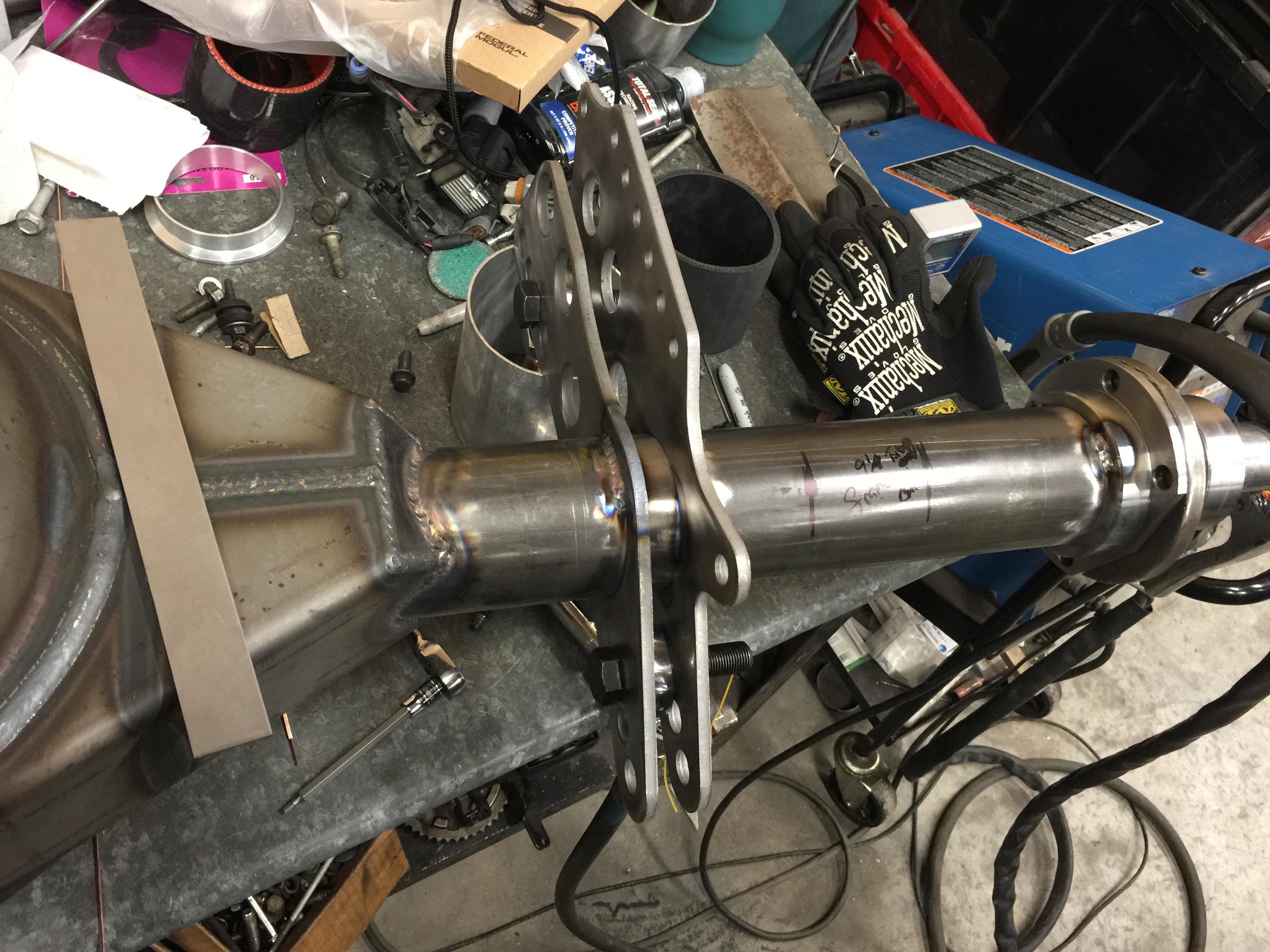

Started putting the 4 link brackets on. I don't think the housing has enough room for a back brace it's only gonna have a couple inches of brace on the tubes before the brackets you think it's worth the time? I'm thinking it's pointless when the housing has an internal gusset IMO.

The back brace is supposed to extend all the way across the tubes first, then you fit the 4 link brackets over it. This is where the strength comes from. The internal gussets can only control so much. Think of it as a long lever. The further out you go, the less amount of force it requires to bend things.
Without a back brace, on my little housing with some welding clamps, I can pre load about 1/8 inch on each side. If I can do that with some basic clamps think what it will do on a slick in a with a 1000 plus HP and FtLbs. of torque in a 3500-3800lb car. The further out of alignment, the more you start wrecking parts like bearings and axles.
My first housing in my first car was built by someone but did not have the 4 link housing brackets on it. Needless to say it wasn't straight But I didn't have the equipment or knowledge to know any different. Just pushing the roller around while it was getting caged and sheet metal work done, it tore up the axle bearings.
After I sold that unfinished project to finance another project, The new owner brought it down and was concerned that it tore up the bearings. At this point I purchased my own bar so I could build my own housing for my new project. Sure enough a lign up bar confirmed it wasn't straight... The last shop never told me that it had any issues But they took my money and worked on it any way... This is exactly why I have my own equipment now and learned how to do it on my own. Paying for work once is almost as expensive as the equipment. Paying to have it Re-done because it isn't right is Painful to say the least...
In Summary, Yes I recommend a Back Brace!
