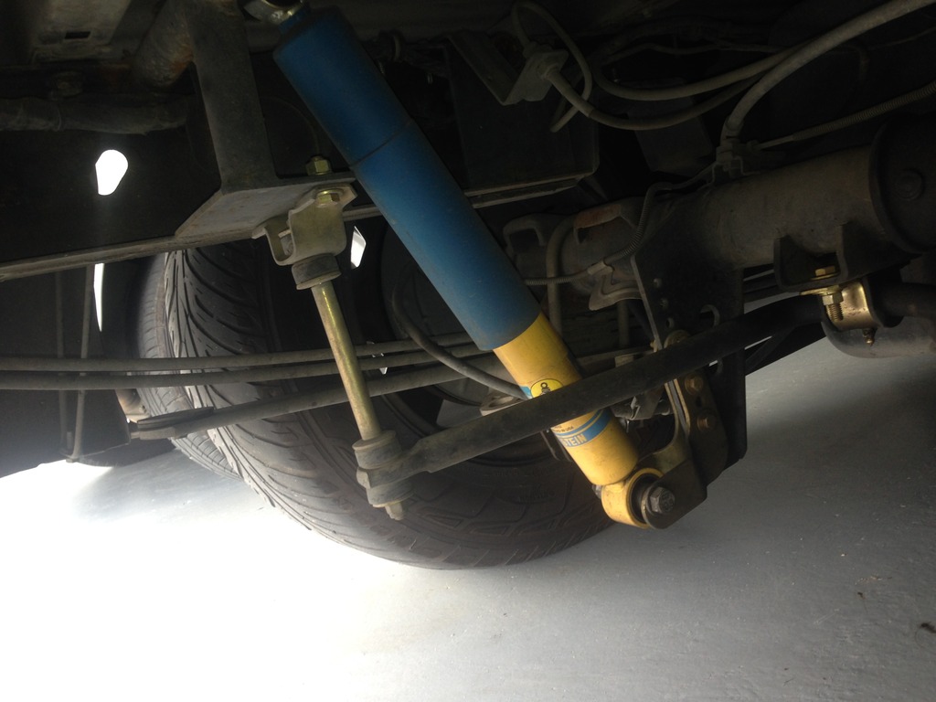

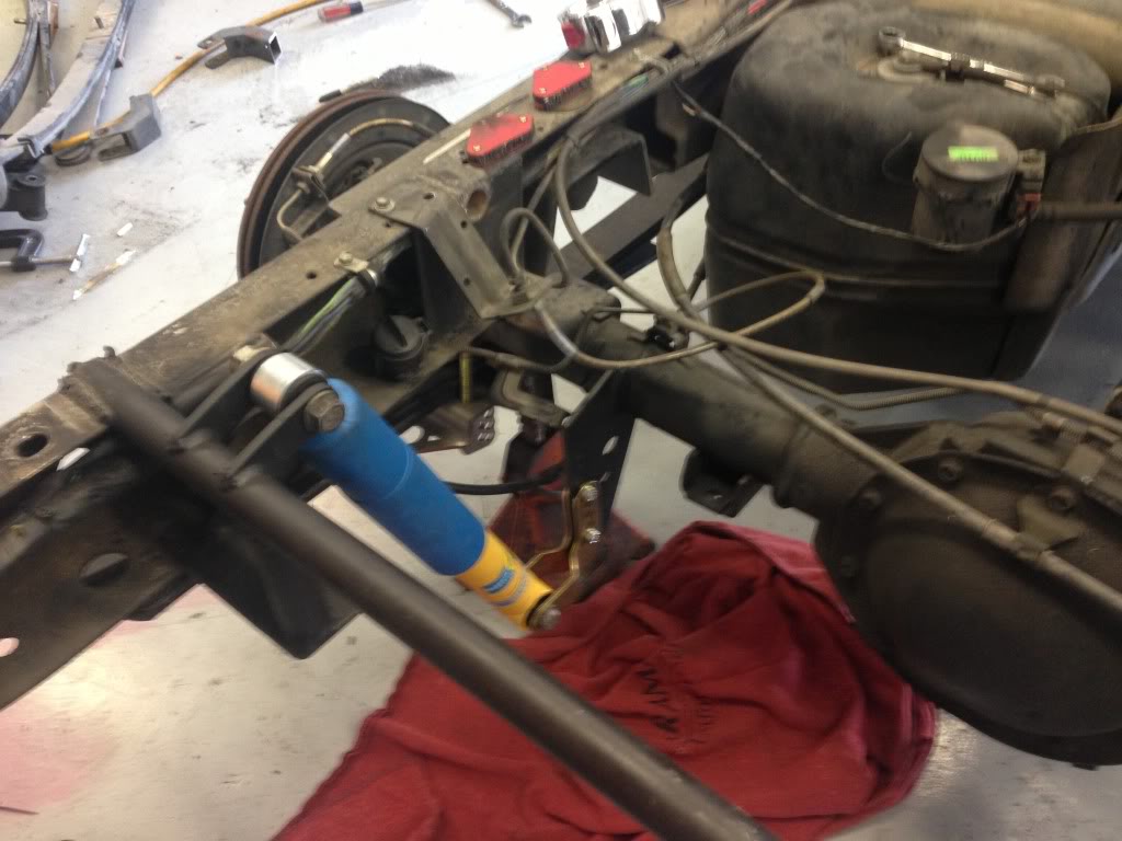

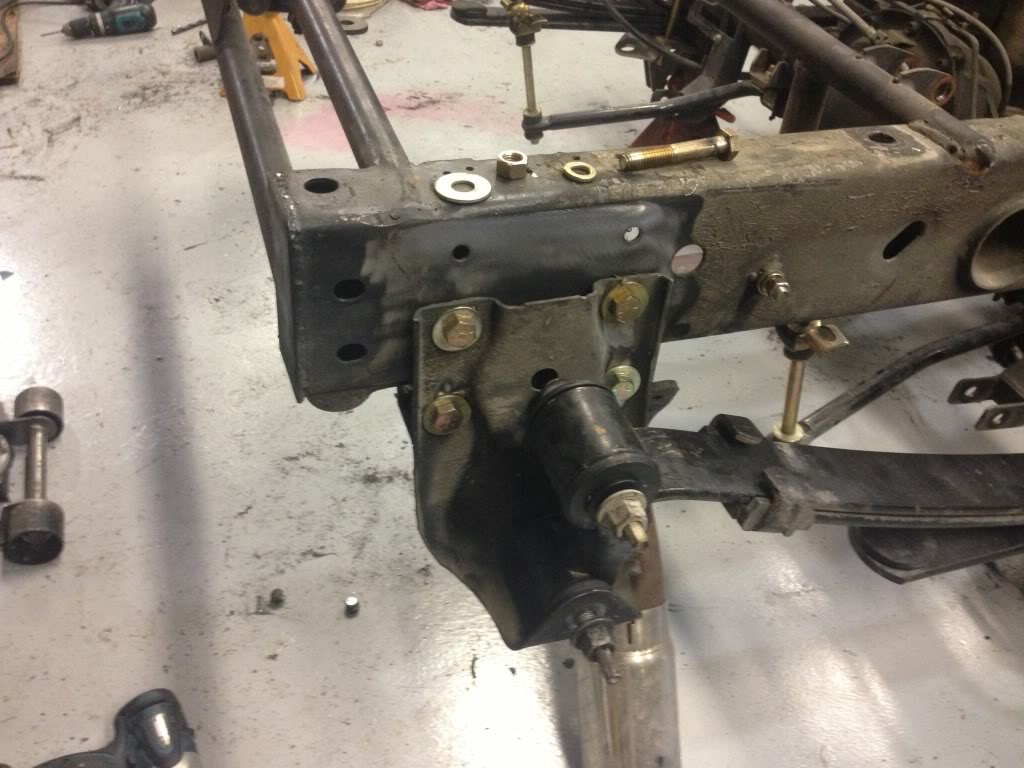

Here is my rear suspension.
I just need to get some DA shocks. I have been looking at some afcos.
Rear axle flip.
Lower leaf spring mount dropped 2in
Assassin bars
1in rear sway bar
All poly bushings in leaf and shackle
Shocks relocated.
One thing to note i have since adding diagonal braces to the shock mounts because i bent them. The deflected about 15* inward on the passenger side and about 10* outward on the drivers side. Those brackets are about 1/4 thick sooo alot of stress going on back there.

What was the point of the axle flip? Just wondering and ya I'd like to see the sway bar when ya get time.. Never mind it was in the last pic. That's similar to the setup I did on a mustang from white line.. What about the notch I'm gonna redo mine I think when the box is off and box the frame in mine looks like a guy welded sewer pipe in it cut in half

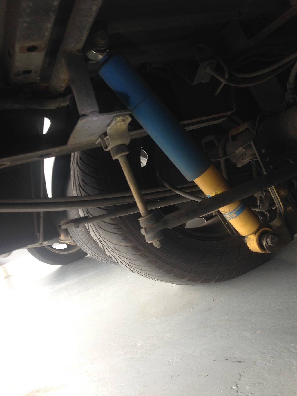

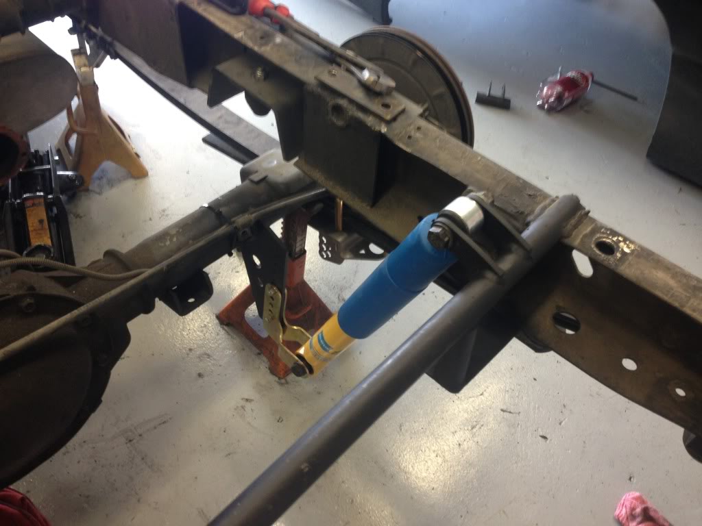

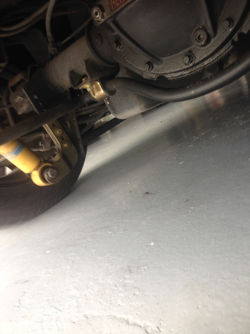

From what i read it gives you better driveline angles and more adjustability out of the assassin bars. Making adjusting the instant center better. I can make my bars flat, tilted forward or tilted backwards.
Way back when i was researching suspension stuff the guys hooking the best had axle flips.
My notch is bolted and and welded all the way around. I would have boxed mine but i was lazy and too damn tired when i was doing all of that.
One more thing about the axle flip. Before i had drop hangers. Like you i had tons of shims under it. It got to the point i was raising the rear to get the right angle. With the flip i just bought new perches and set my angle exactly where i wanted and welded it.
Here are some better pics. I welded a spring perch to the axle tube to mount the bar then i made another bracket to attach the end links. Which is tied into the shock mount bar

So what did you do with the assassin perch that wraps around the axle how does it attach just cut it flat?
