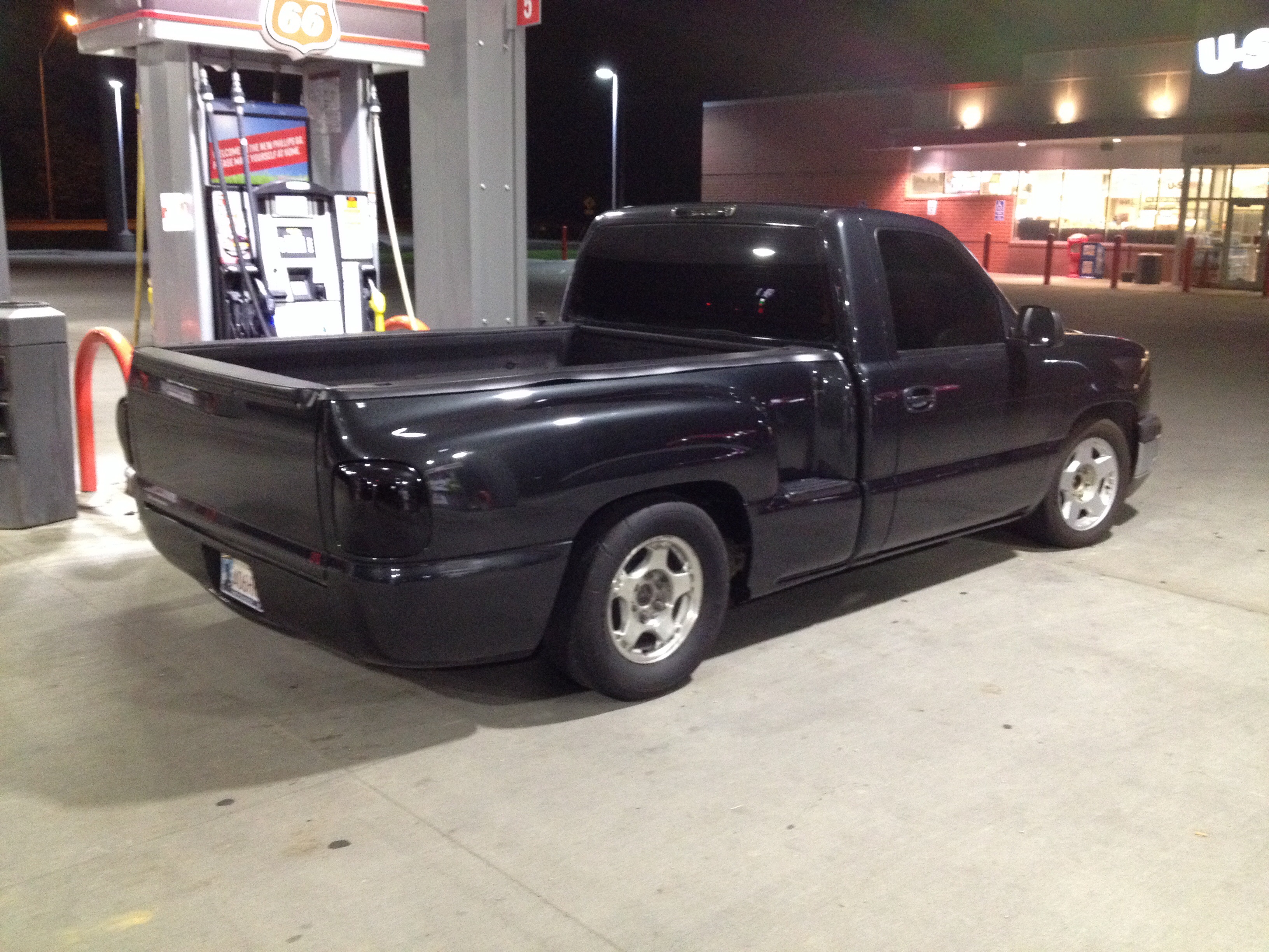

I bought this truck in Oklahoma is an 03 Silverado with a decent amount of mods.. Current mods (that I know of, or was told):
408 11.5:1 w/l92 top end milled .030", and l92 intake, 90mm t body, x link, ls7 lifters unknown cam, headers and true dual exhaust, has a Lingenfelter 2 step, has a 4L80e and a 3600 billet hub stall, built driveshaft, a Detroit posi, and it's currently on a 150shot via nx proton kit.. So pretty decent list.

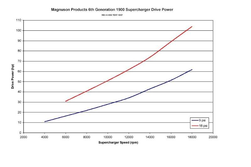

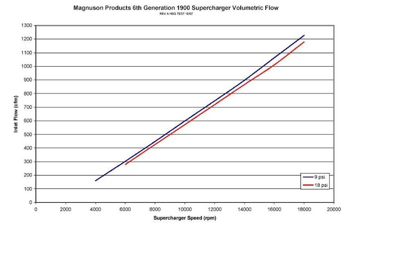

This is really coming together! The torque this thing is going to make is absurd...
11.5 compression 408 with a 1900 spun faster than I'm spinning mine with a set of good heads and running on e85. I'd bet we see about 12PSI out of it, but its going to be feisty!! It will make great power on 12PSI.
For comparison sake the 2.55 upper on my engine with my 1900 would be in the ball park of 15-16.5 psi. Despite what most think these blowers do generally build boost through gears and with RPM even if it is slight as hell.
To that end with a 408, heads that flow a lot more, and a bigger cam I can see about a 25% reduction in boost. I'm going to go out on a limb and say that it will be in the ball park of 10-12PSI. The torque it makes will be brutal while it may struggle a little to hold that power late in the RPM range. Let's hope this converter builder is true to their word! At the RPM you will have this thing spinning you will be above the 1400 CFM mark with a peak drive loss of about 80.
