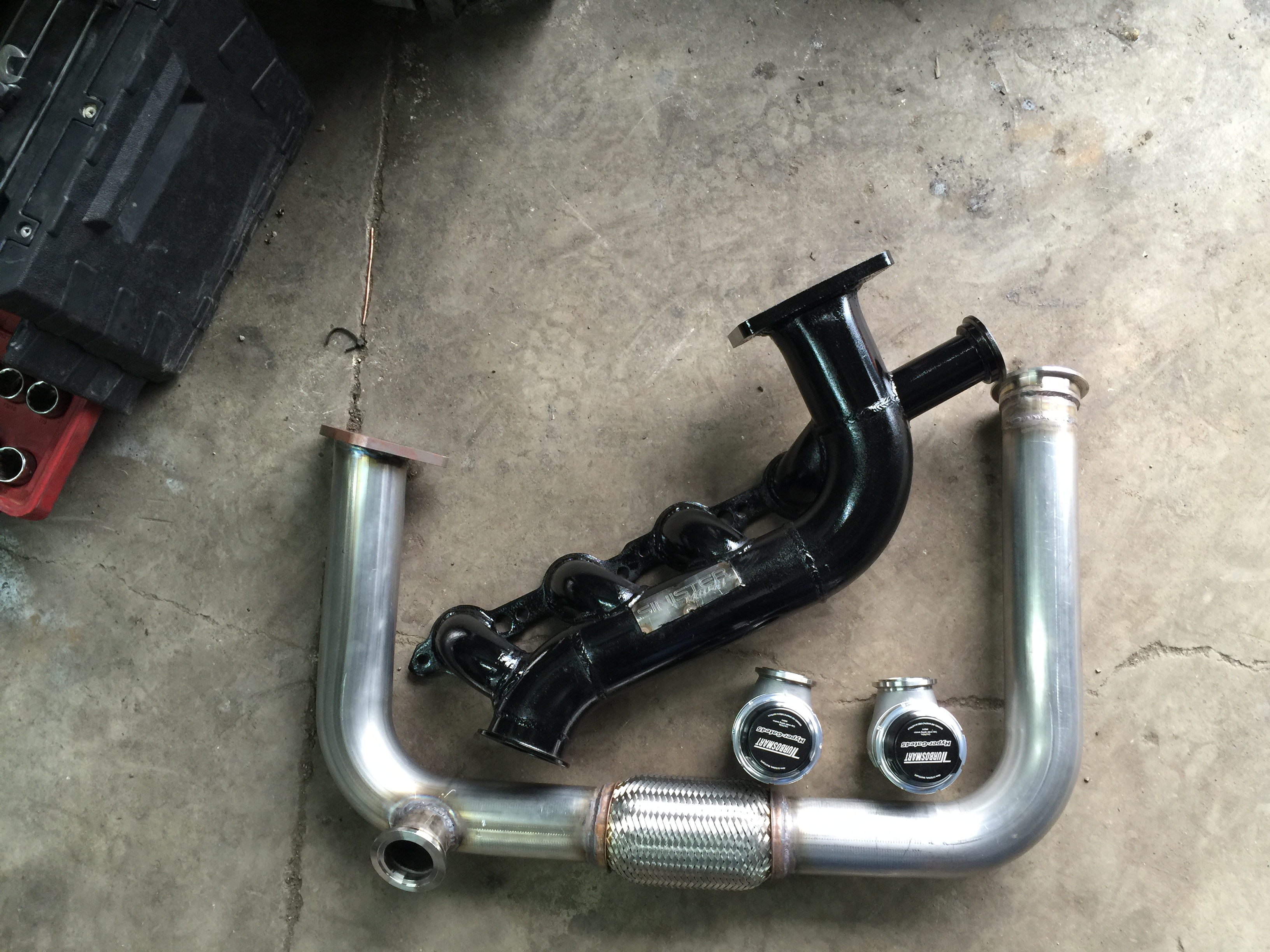

Well finally have some parts coming in soon here's a couple pics. I've been waiting on my turbo, and hot side since February 2015. It features sinister Racecraft crossover and log manifold with dual 44mm gates, s488etr-ho with a v2 racecover and I went with the 96mm exhaust, and 1.58ar exhaust housing. I've decided to pull the heads and have Frankenstein fix and do a different Cnc program on em. I'll probly drop a new piston in or possibly get a set of wiseco pistons in. Also I'll switch to an inconnel exhaust valve at the same time.

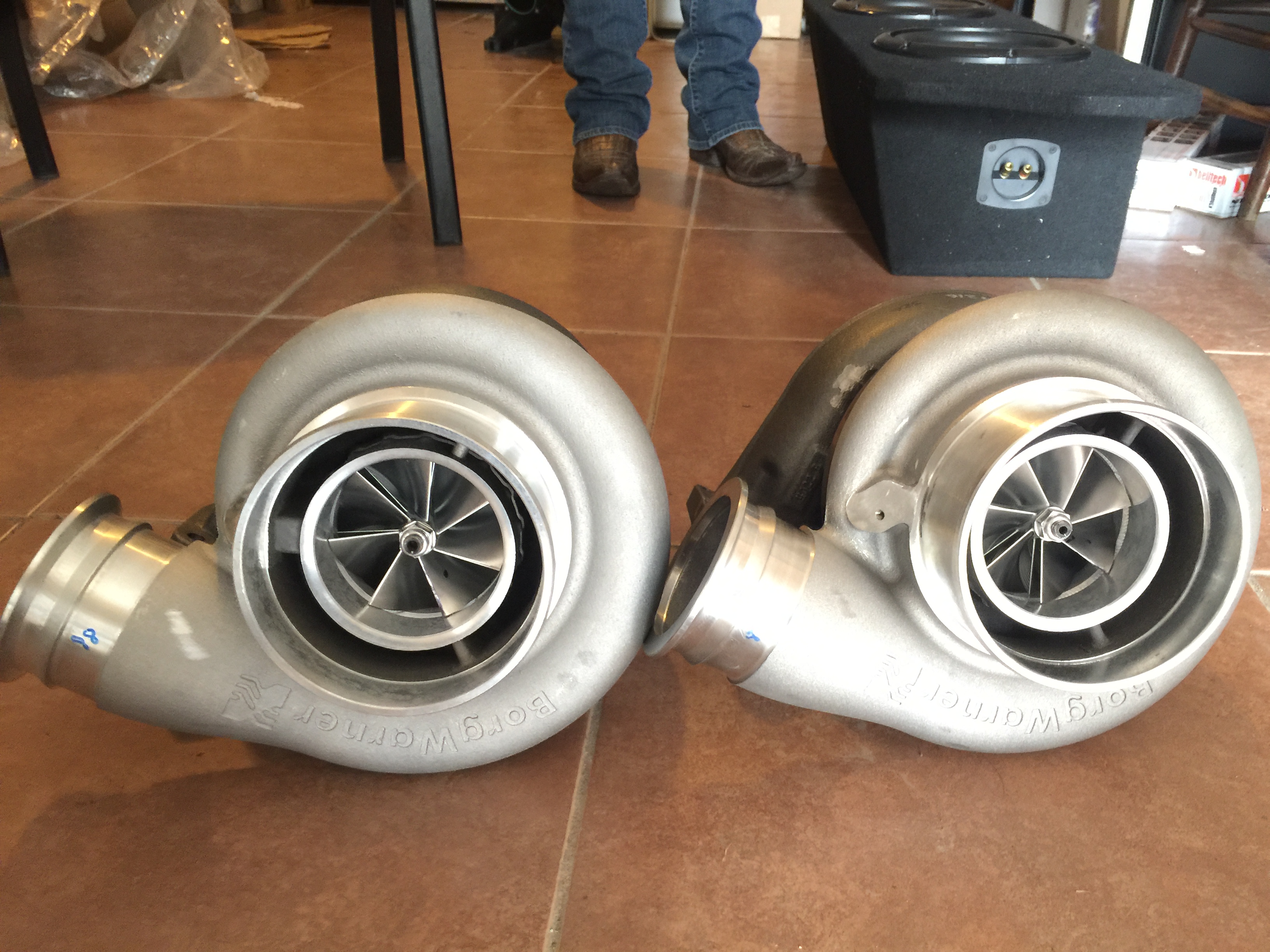

And here's the turbo.. Mines on the left

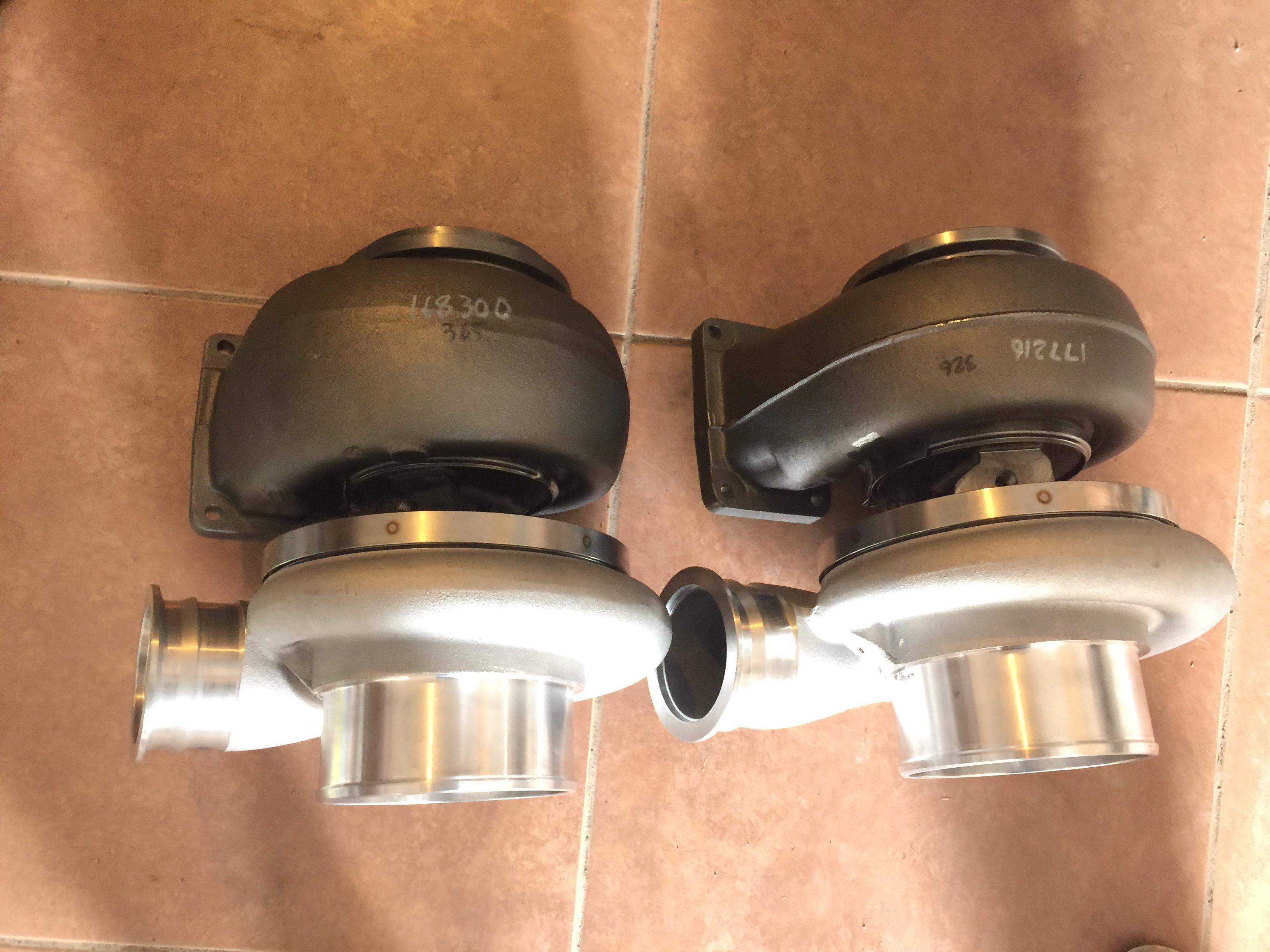

Again on the left

Baller turbo! Me want
I wonder how different downpipe position is with the 1.58 housing vs 1.32

I may make two of them.. We will see depends how much I race. I'm limited to a 4"dp and keep ac. But I may cut my stock hood for a hood exit for racing 5" they said it really cuts down on power output running 4" but I'll try it and see what it does.

Nah you wont notice any power difference with 4" vs 5". 5" will spool a little better though. Are you still planning on doing the compound setup? If so I would have gone to a bigger turbo...

That turbo should be capable of 1250-1300 rwhp...How much more you need??
