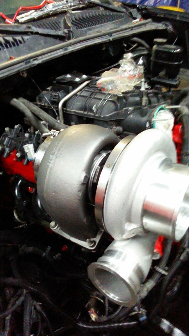

They sent me some pics of the s488 getting mocked up for the down pipe.. Man it's a big bitch!
Also bought a 4.8 for 250$ Ima run the next year, has 325k miles on it I'm cam it, 243 heads, studs, file the rings back some and roll the dice.
408 is getting sold as a shortblock, heads are getting worked over by Frankenstein racing,
427 is gonna slowly get built as I can afford it this year. Just didn't want the truck to sit..

that turbo looks ******* badass.
I want.
