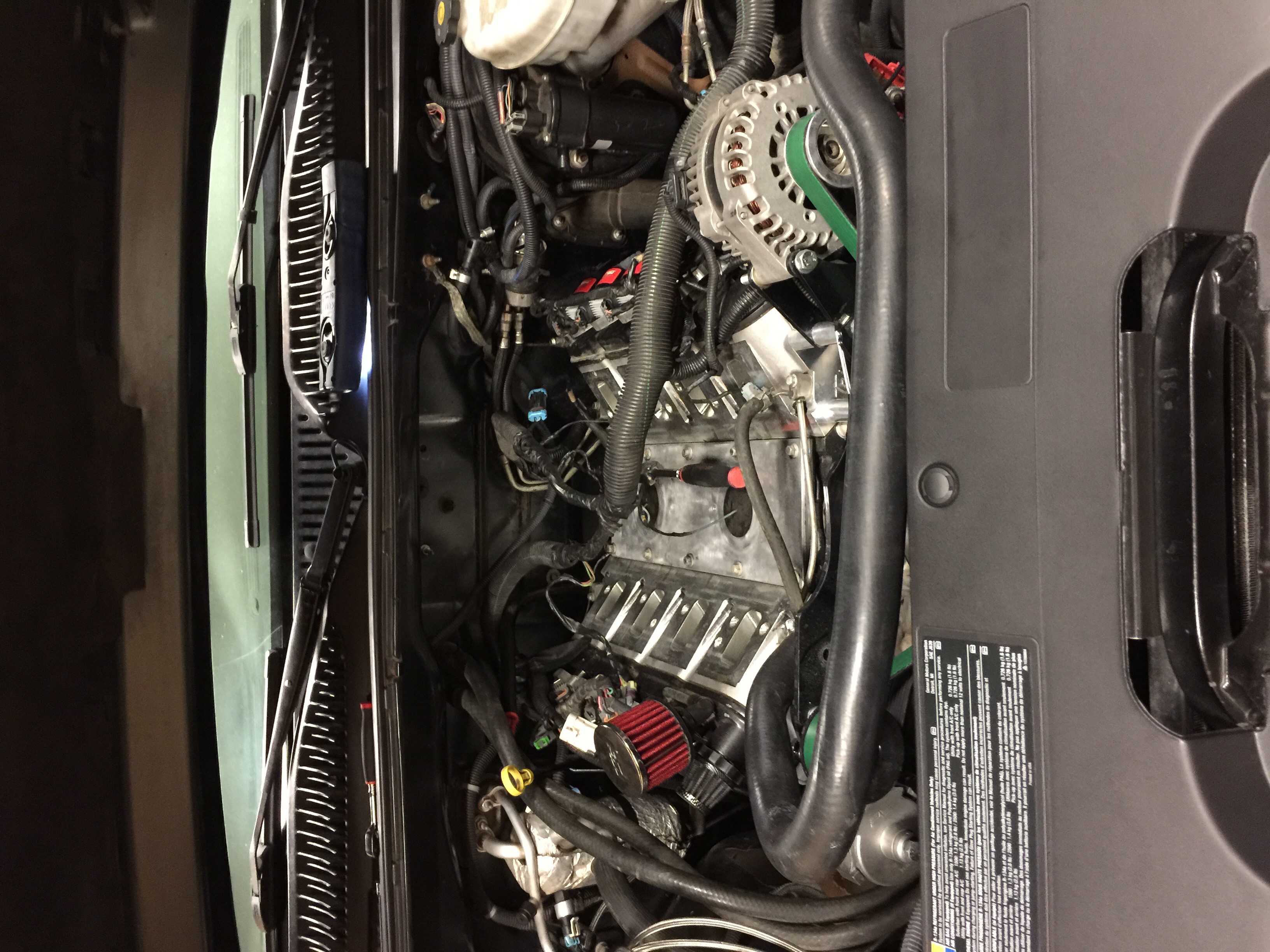

Oh ya s10 in the sig thru me off. Blower is goin on...

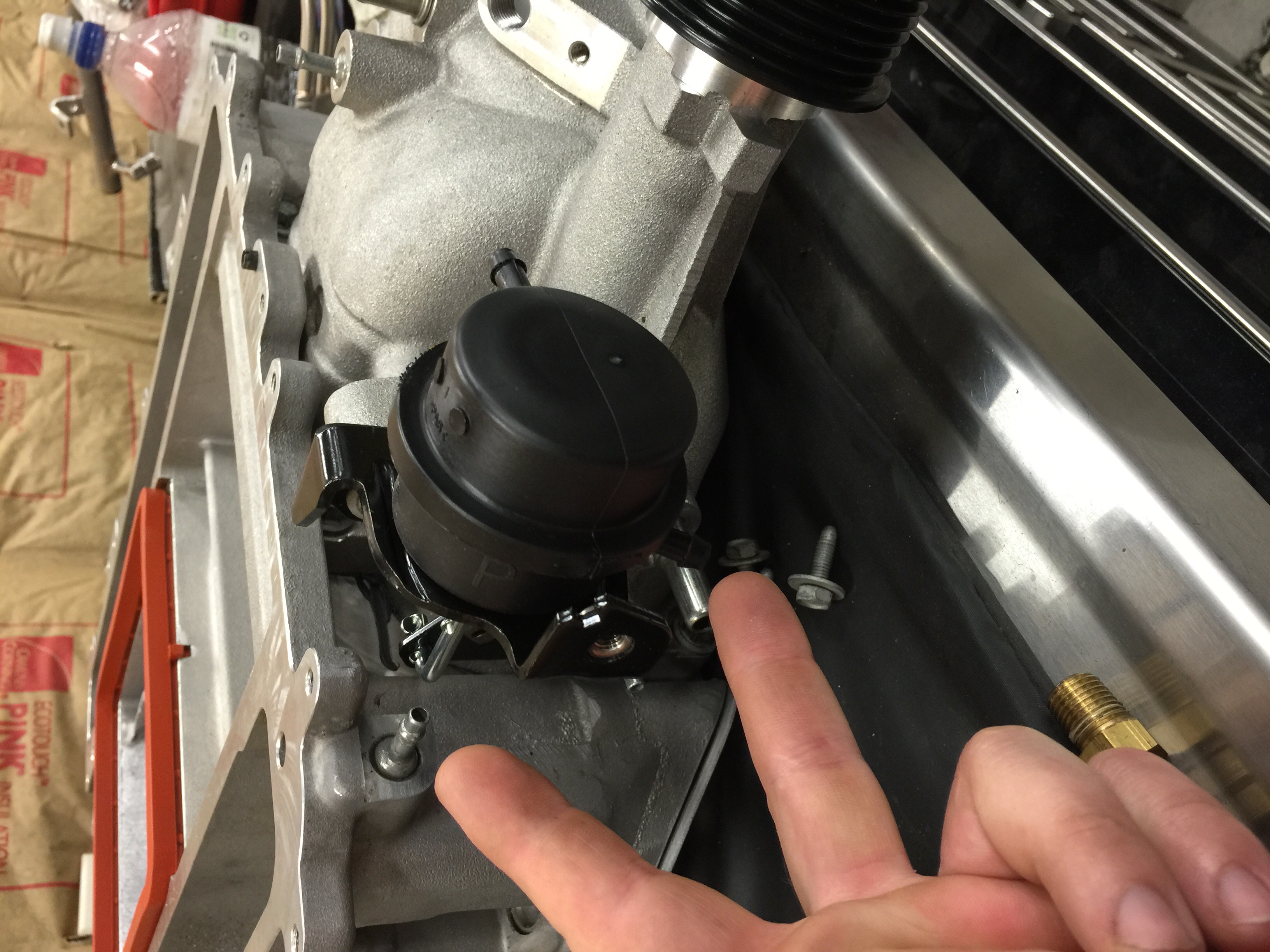

Also spent some time and figured out the actuator since no one on the ctsv forums were any help..
*port furthest forward is controlled by vacuum ANY port on the snout will be a good choice.. They are your vacuum sources.
You will need to plumb a vacuum line between these fittings shown in pic. This is necessary so when you close throttle it will release pressure in the manifold. It will also be used in part throttle and cruising driving and idle.

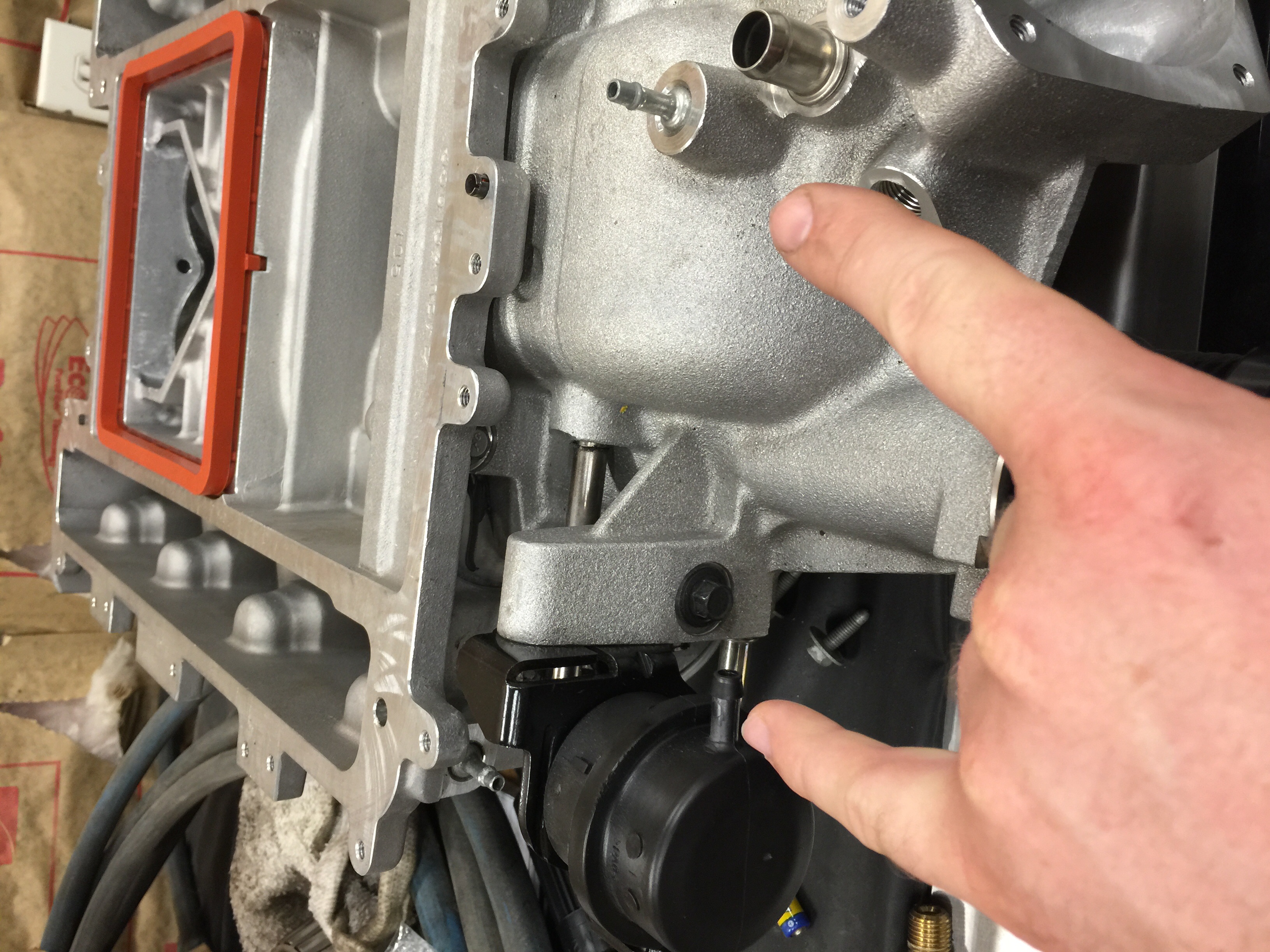

Old Aug 24, 2015 | 10:33 PM
  #129
lsxperformance's Avatar
Joined: Jul 2010
Posts: 789
From: Waverly, Ne
The other port on the actuator will be left open unless you feel the need to have a boost control device such as a boost leash or something else if you put pressureized air to this port it will open the actuator.. I plan on running a line from my intake tube when I compound this thing to that port to open the actuator when the turbo spools to by pass the twin screw.. In theory I think it will work great but dunno. Gonna try it. There is also a port on the manifold right behind that that is a boost re fence spice and will make pluming a gauge easy..
