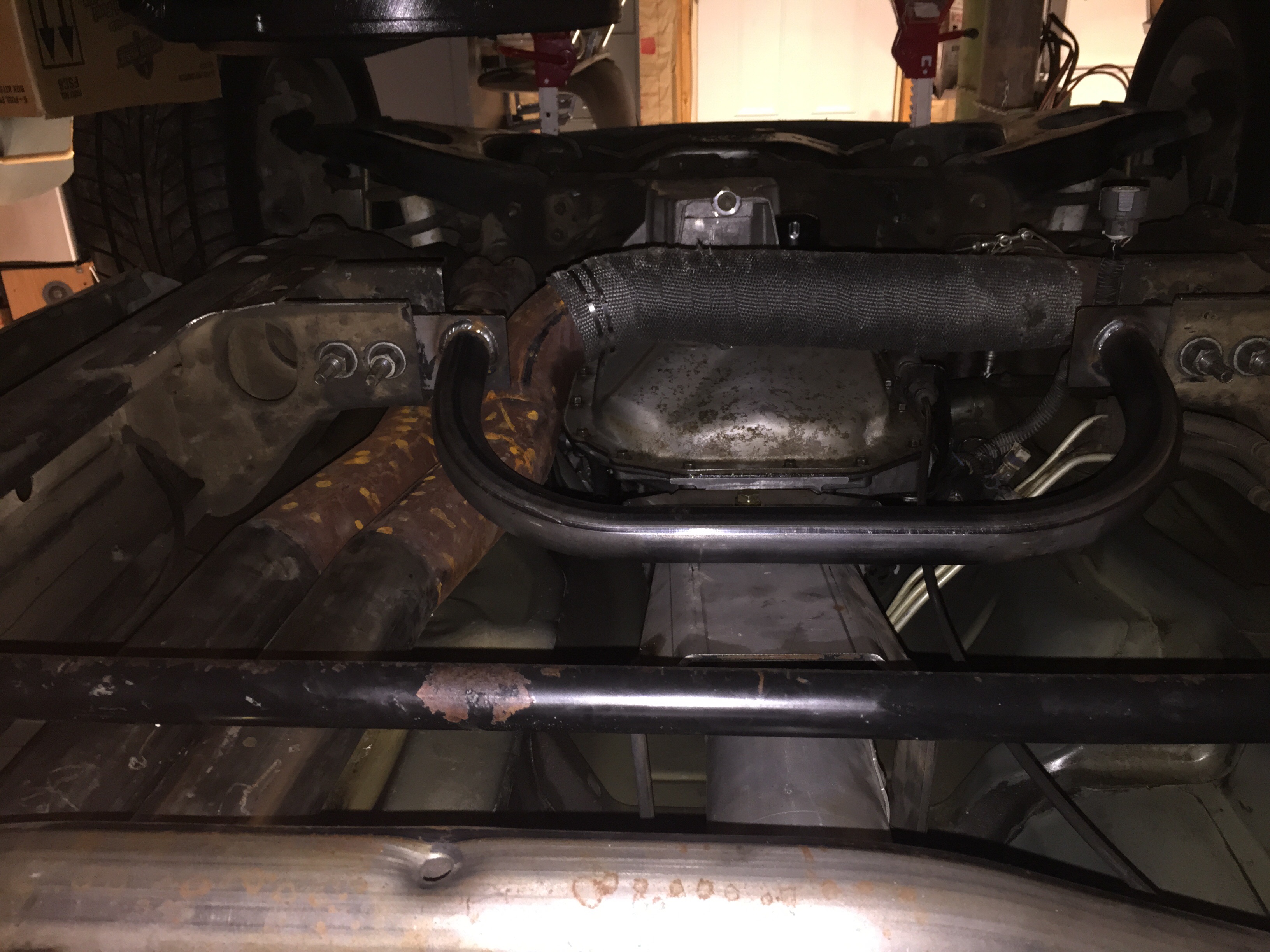

Here is a pic of Dirttrackracer 4L80 crossmember.. Fits dam nice and looks good too!! Don't mind the exhaust it will be getting changed and will be making a custom x pipe under the crossmember.. After I get new headers because the current headers are cal speeds and fit like **** I had to beat the hell out of the primaries to get them to fit between the frame rails.. Pretty much the poorest fitment of a header I've ever seen.. A friend of mine his dad builds custom headers and he's hinted he wants to give it a whirl.. Multiple stepped and crazy built around the engine combo..

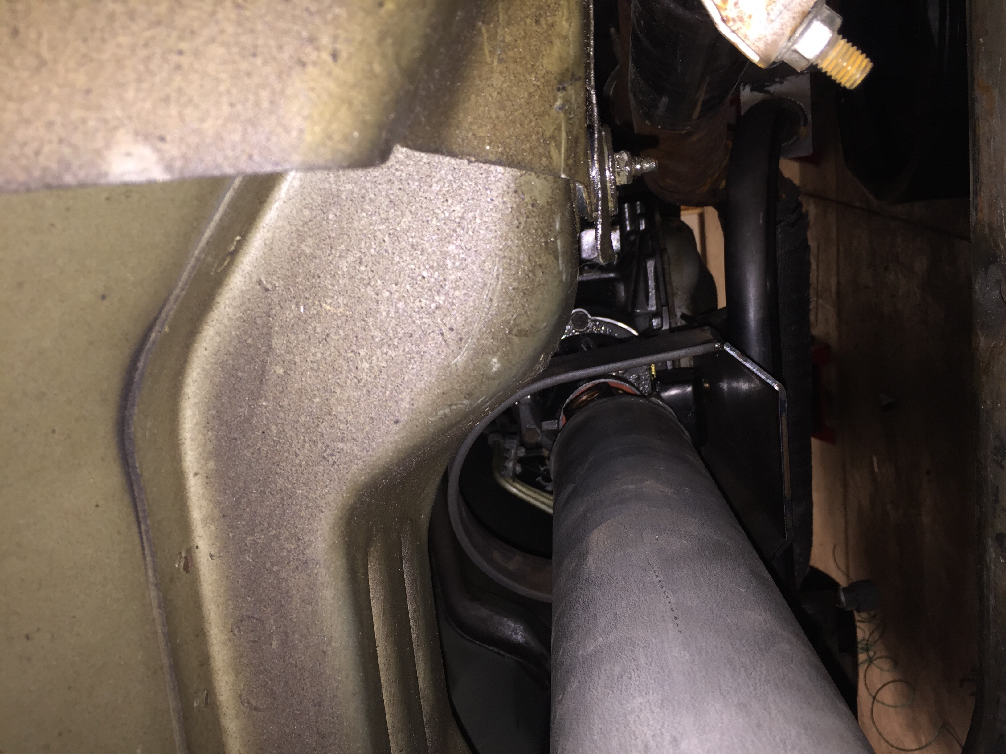

I also got a driveshaft loop to go with the cross member also fits well. And heavy duty for in case it actually be needed..

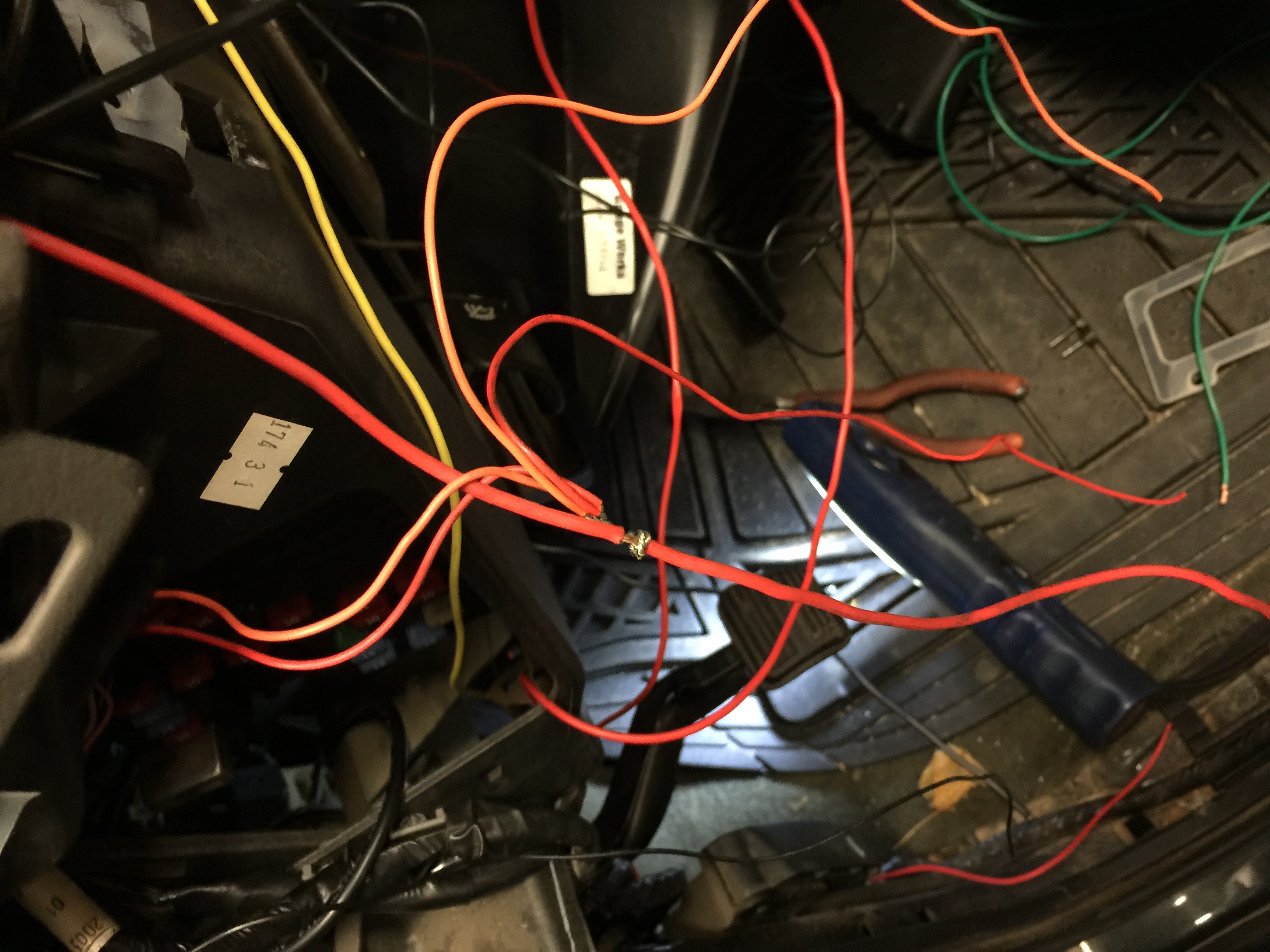

Old Aug 12, 2015 | 01:53 AM
  #70
lsxperformance's Avatar
Joined: Jul 2010
Posts: 789
From: Waverly, Ne
Been working on cleaning up the night mare of wiring this thing has under the dash from previous gauge installs and nitrous. I'm hooking a Lingenfelter LNC-2000 2step launch controller in parallel on the trans Brake switch that way I can control my launch rpm at the track and not have to watch it. Also has a ignition retard I'm going hook in parallel with the nitrous arming switch that I plan to pull timing with in hole shot if need be. I'm gonna have a momentary on switch to bang the nitrous solonoids on the big end if needed.
