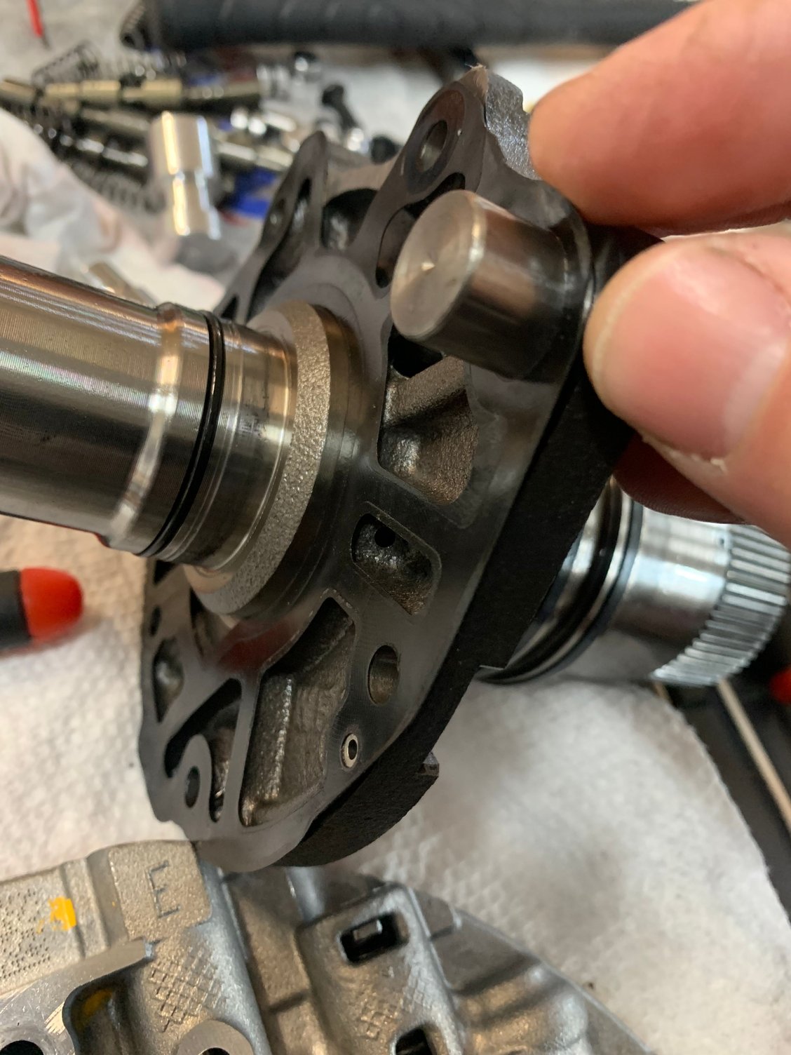

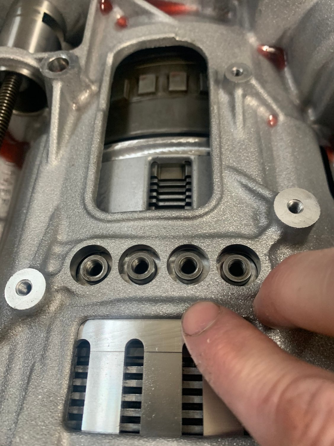

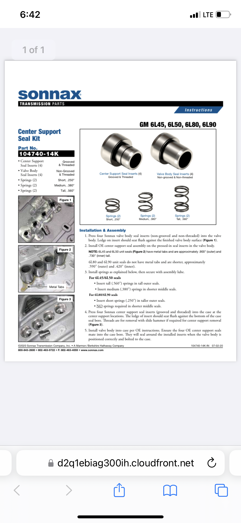

Installed a Sonnax Center Support Seal Kit. I will be installing a Seal Aftermarket Stabilizer Kit on the trans I’m removing though. I’ll build it myself and have it standing by for any future needs. The Seal Aftermarket Stabilizer Kit is much beefier and really locks the center support to the case. The Sonnax kit just helps to prevent leaks at the factory seal.

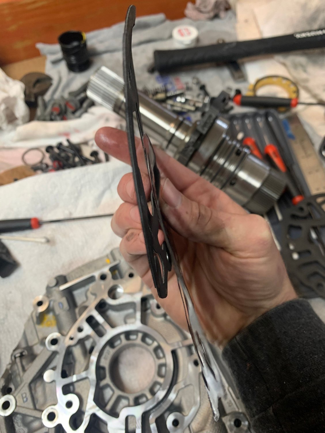

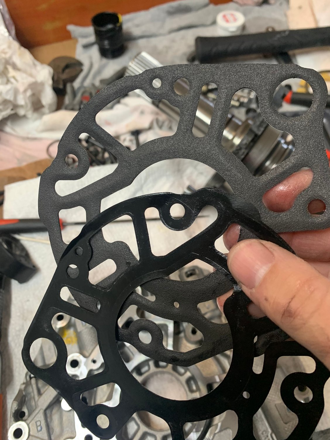

I am also upgrading the pump to stator gasket from the OEM paper to a Foamet metal coated one to prevent any blowouts.
Paper gasket vs coated metal gasket

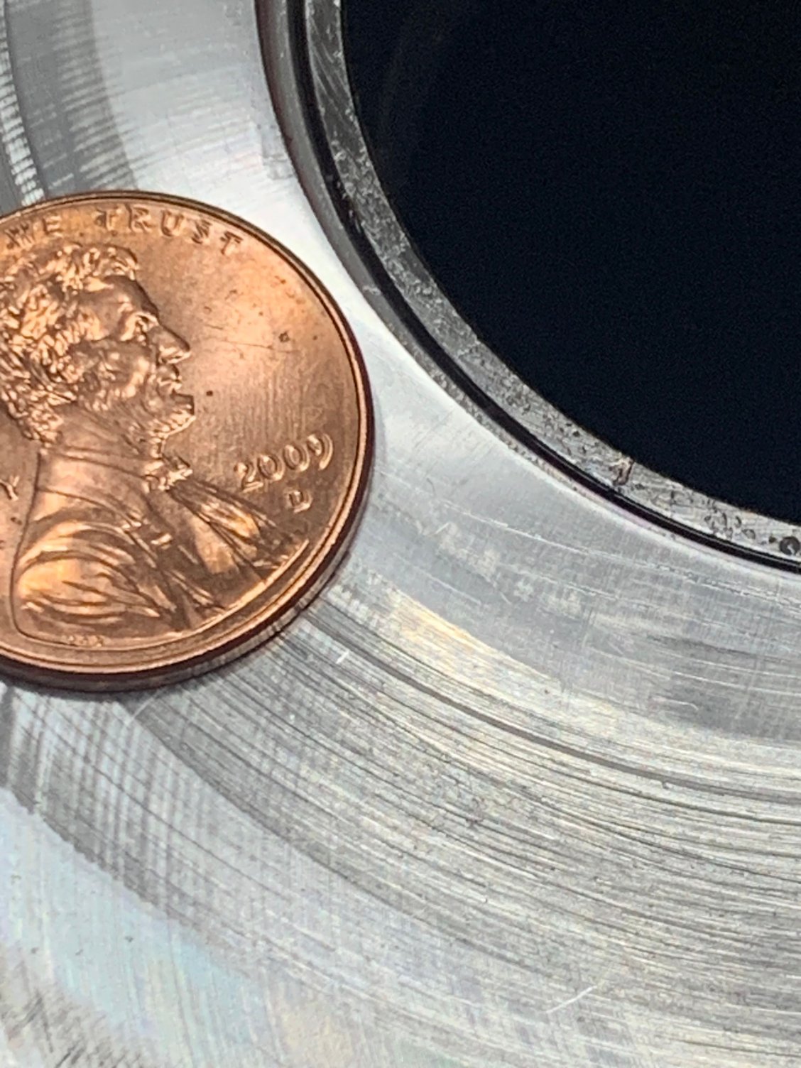

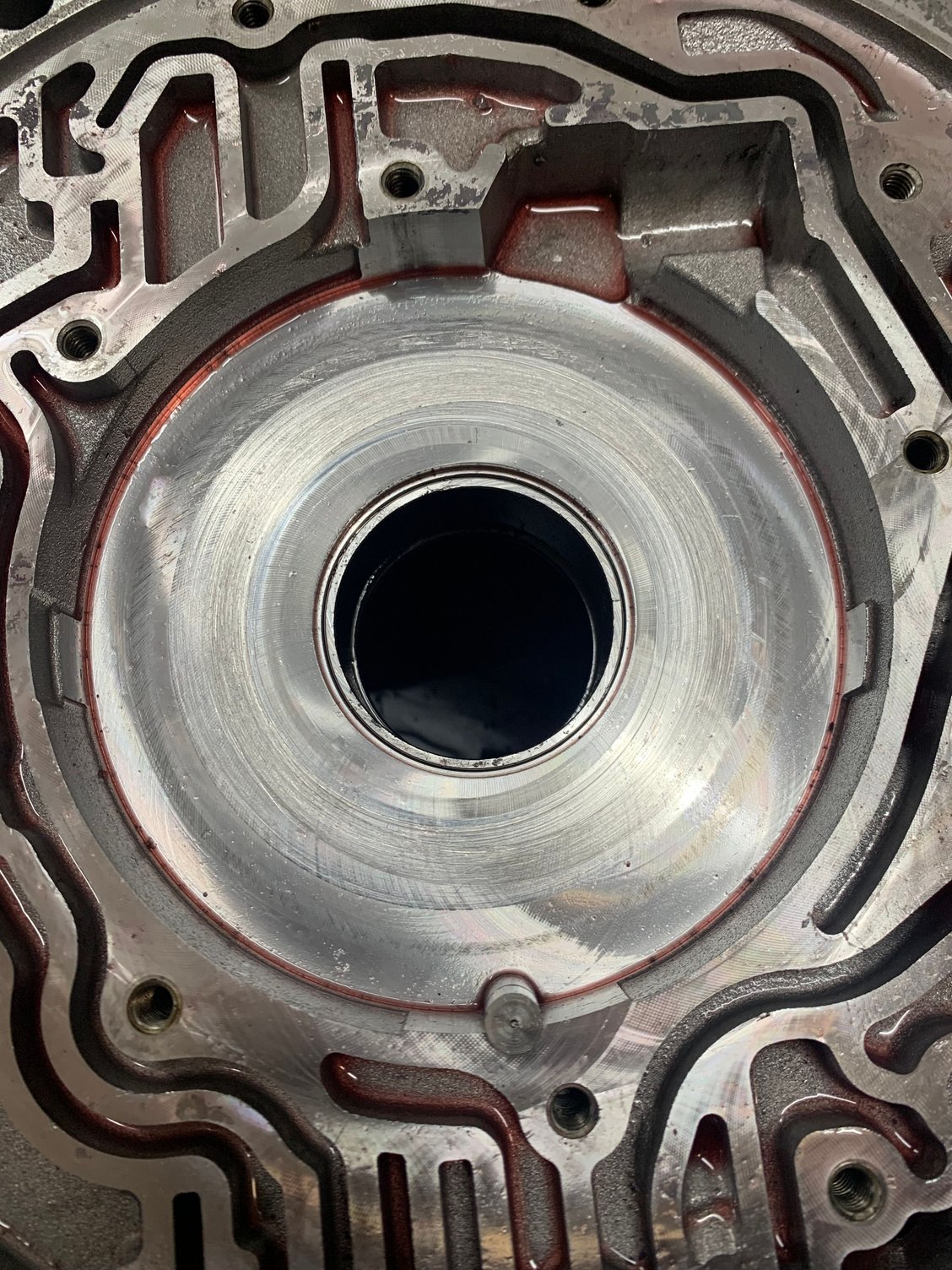

Bellhousing side of pump surface….notice the scuffing that’s already present and the machining marks. The machining marks act as “wipers” which literally squeegees the fluid film away resulting in metal to metal contact. You can catch a fingernail on some of the scuff marks.

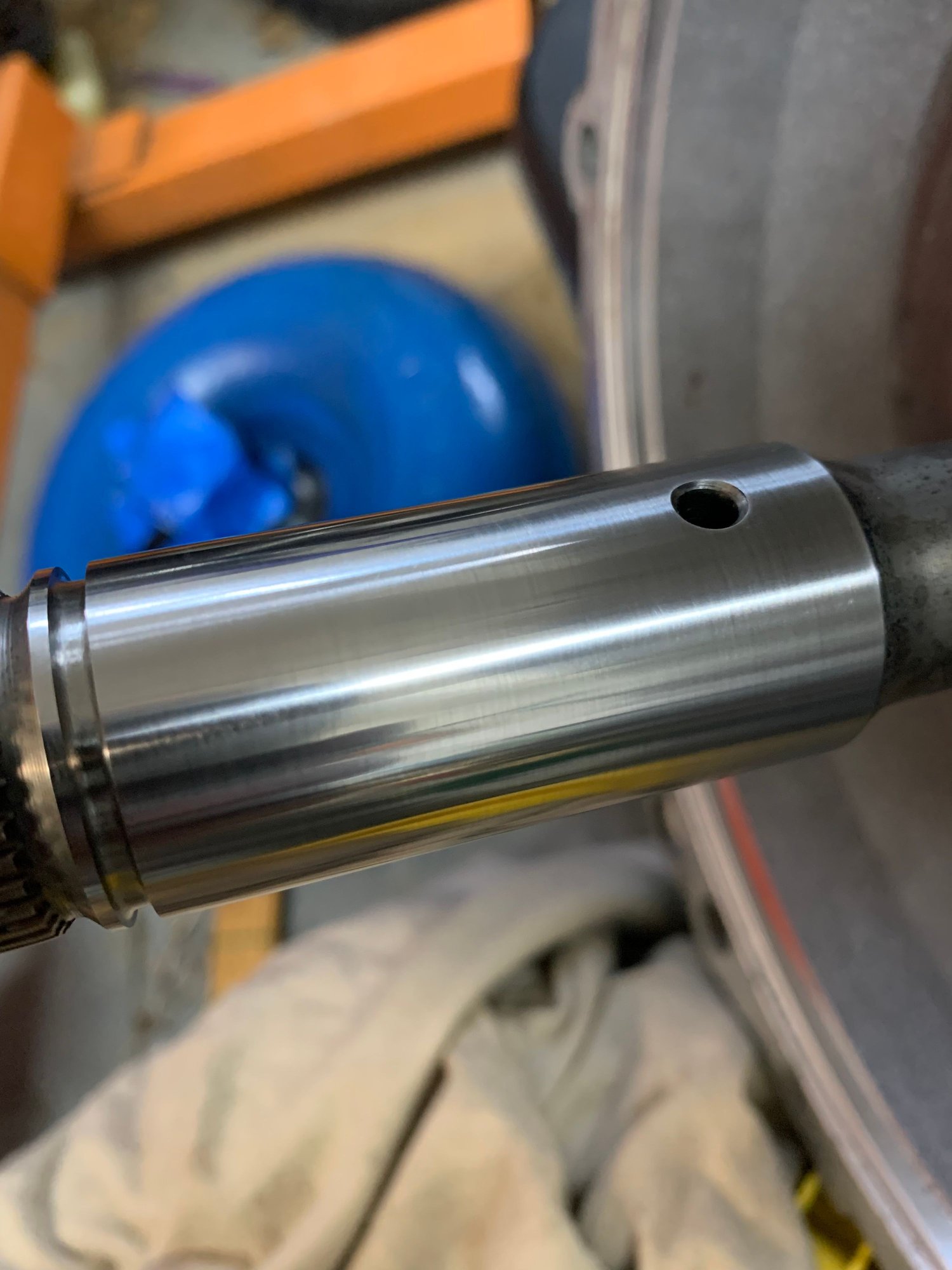

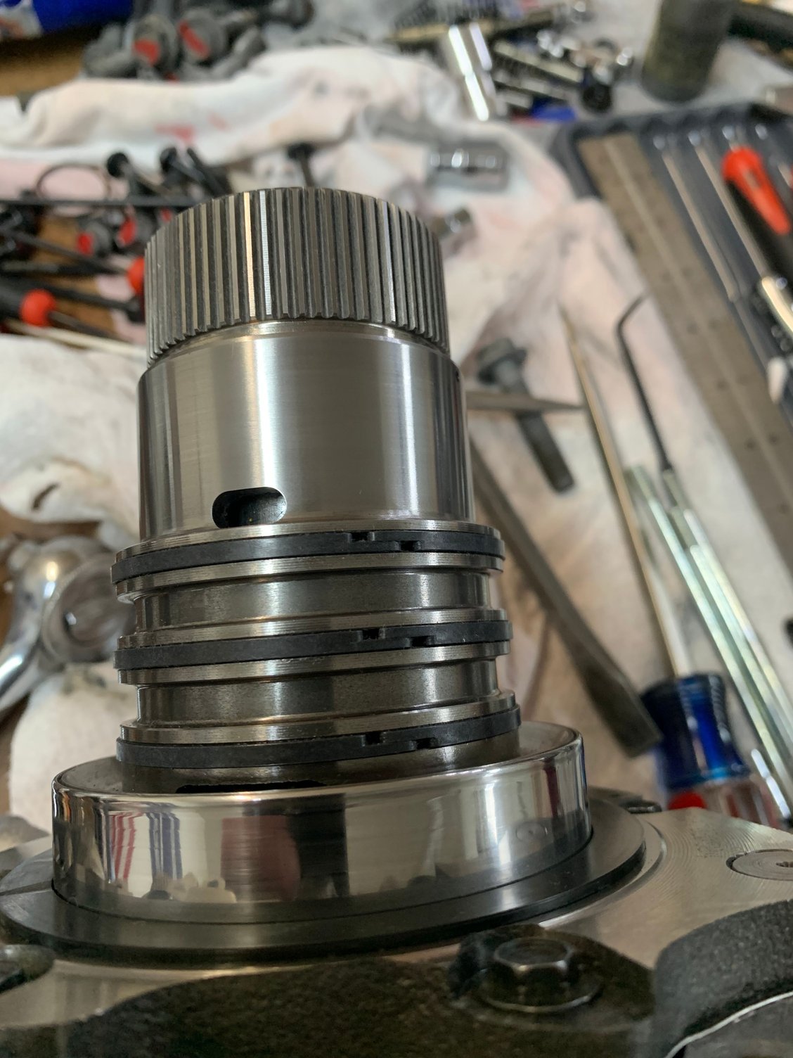

Quick Polish with Super-Micro finish belt. Few more pieces to go then I’ll apply some tungsten disulfide on the polished areas. Also switching over from OE aluminum bushings to bronze bushings. After removing the OE aluminum bushings I lightly dress the area the bushing sits in with 60grit sandpaper to help give some bite to the new bushing and prevent spinning.
Polished stator areas where bushing and bearings ride
Polished input shaft where it rides on stator support bushing

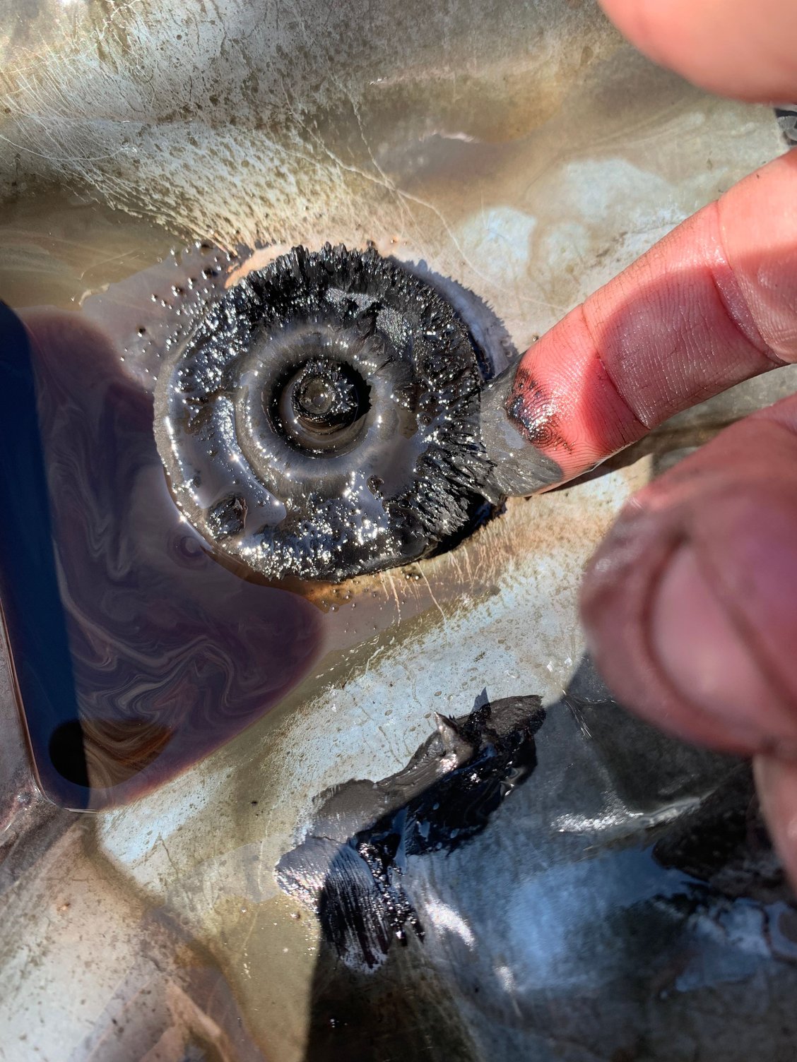

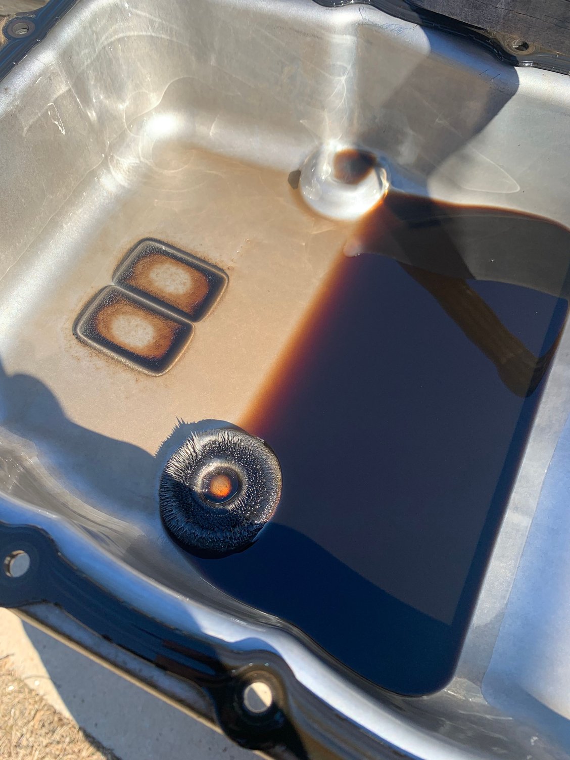

Surprised it lasted as long as it has. The fluid only has about 30K miles on it. Smells horrible and lots of metallic dust. Halfway done taking it out of the truck. Hardest part will probably be lifting the truck high enough to get the trans out from underneath it.

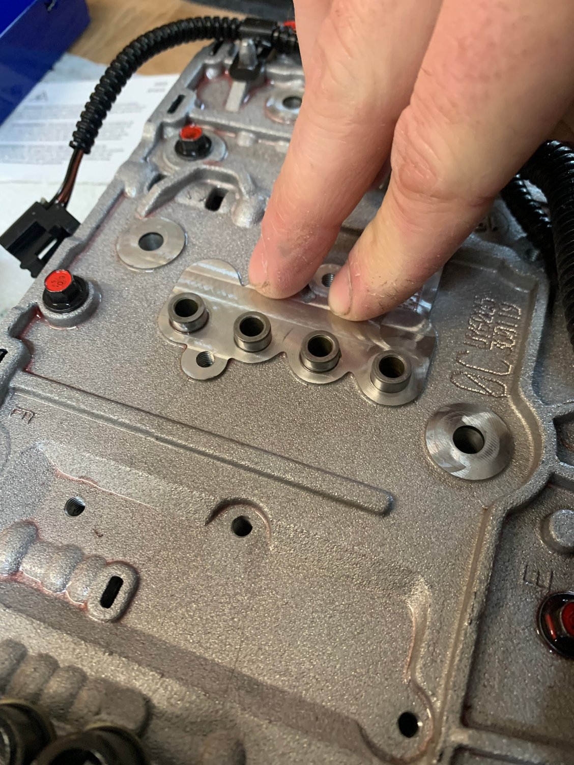

My father also told me about hearing that changing high mileage transmission fluid would make one “go out”, act weird, or start slipping. I’m a little skeptical of that myself. It’s my belief that if one goes out after putting fresh fluid in that it was on its way out anyways but that’s just me. I might bite my tongue if the 4R100 bites the dust soon though. I was generous with the size of the calibration plate holes. I think I went like .010-.020 over the first recommended size. It shifts really firm now. Definitely more aggressive than it was prior.
Got a upgraded Sonnax billet 1-2-3-4 piston
