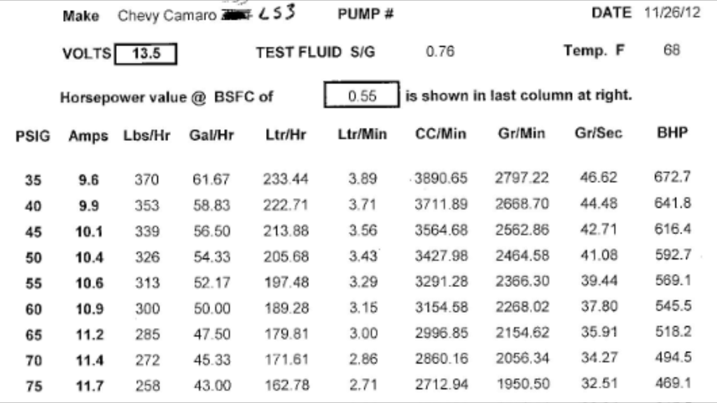

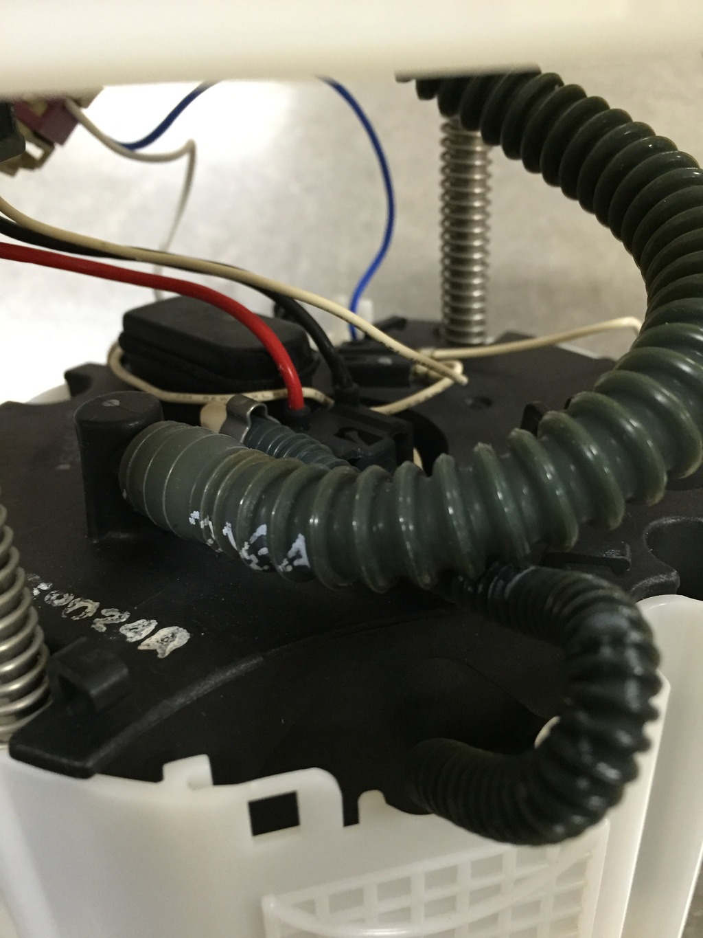

CTS-V LSA fuel pump (left) LS3 Camaro fuel pump (right). The CTS-V has dual pumps stock while the LS3 Camaro only has one. On the flows charts you'll notice the large difference in flow rate between the two fuel modules. I will be modifying the Camaro module and installing the dual Walbro 450 pumps in it. The CTS-V unit will be enough for cruising around with by delivering 304L/hr @ 60psi.

Camaro single pump:
Photo/Data Credit VaporWorks:
CTS-V
LS3 Camaro

Man, the flow in those ctsv module falls off like a rock at pressures we would see under boost.

Yeah it's because of the internal pressure regulator that it falls off like that. With my injectors being plenty large and flow volume being plenty large I believe my base pressure can be set at 43psi or lower.

If you have a large enough injector you can run a lower base though and its pretty damn stout.

EDIT: I got off my *** and got on the computer to download that spreadsheet. Am I thinking correctly for if the spreadsheet shows Injector Total L/hr=484 @ 30psi then the fuel pump output would need to be 484L/hr @ 30psi as well?
