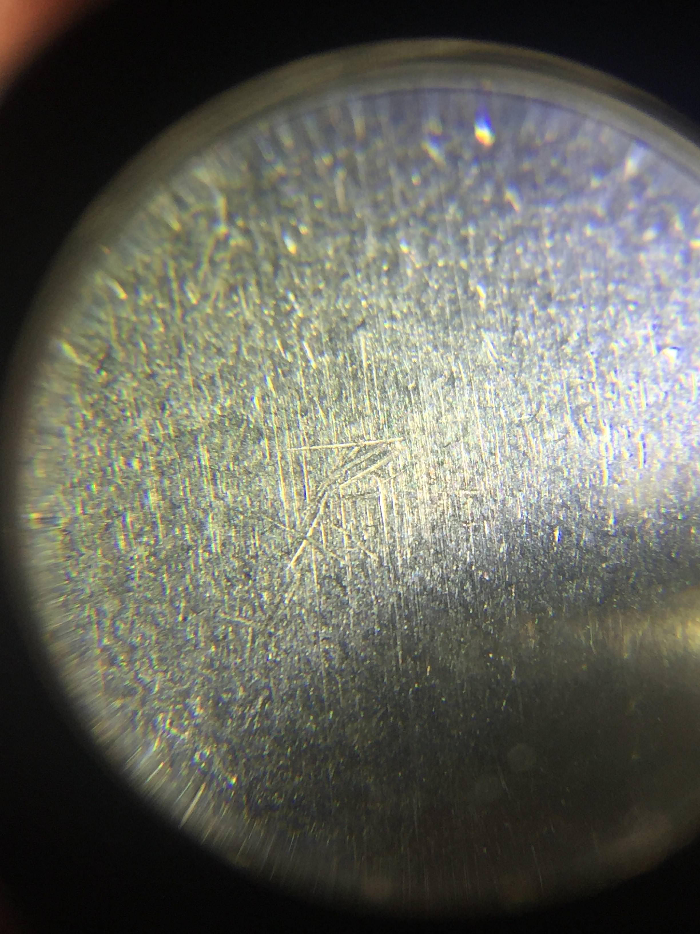

Looks like a polished mirror but when you magnify it just 40x you see this. You can see the main direction of the grinding along with gouges in random directions.

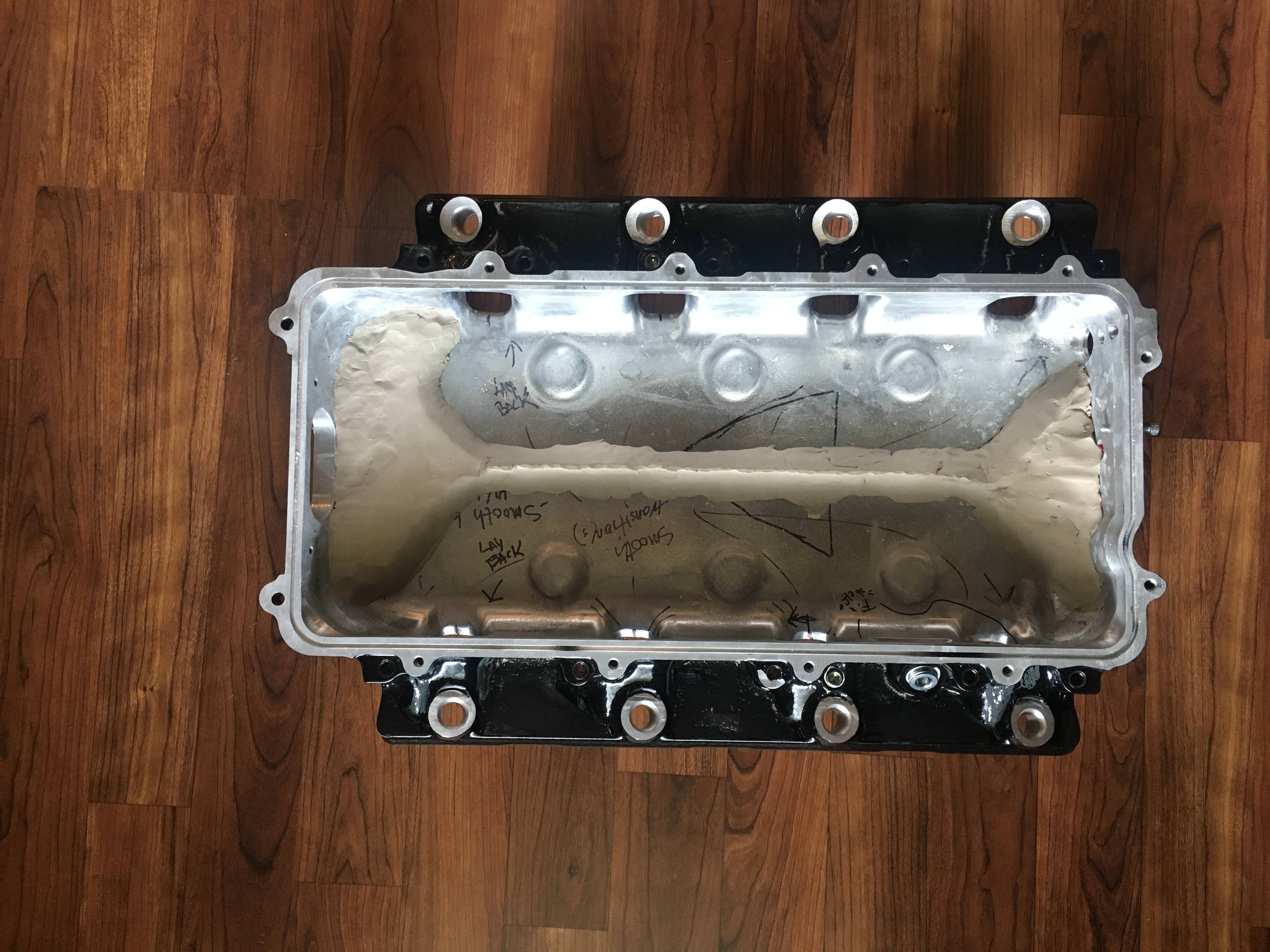

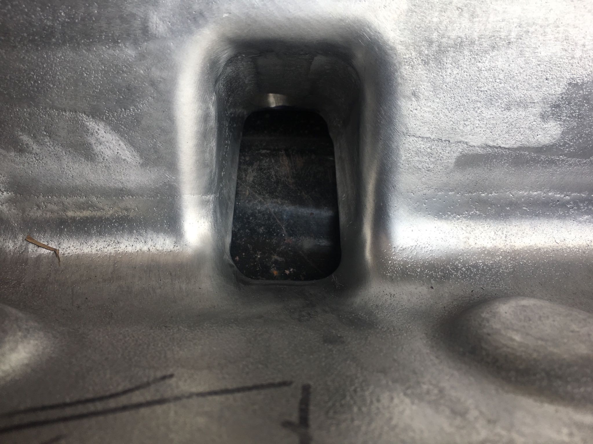

I call it the large laminar airflow maximizing agitator (LLAMA) pulls more airflow onto the long side by kicking out the air opposite the short side. Also increase the opening size of of bellmouth on top to increase airspeed on the smaller bottom that sees more turbulence by pulling more air in Venturi style. Also the air on top has more of a straight shot down into the cylinder and helps “curve” the air on the bottom past the backside of the port which keeps it from slamming into the wall and making turbulence.

Most guys would just be like "hey bro I ported the manifold today"

Bruhs I did things and I call it SPARE BRAS Split Pulse Anti Reversion Ejecting Boost Ram Air Splitter

2 things... I think a sharp edge wont work as well as you think. Look at the LSA lid. A gentle curve accomplishes two things... it deflects air in the direction you want while making the clearance under the intercooler in specific spots tighter creating "high pressure" zones essentially forcing the blower to use more of the intercooler evenly.
