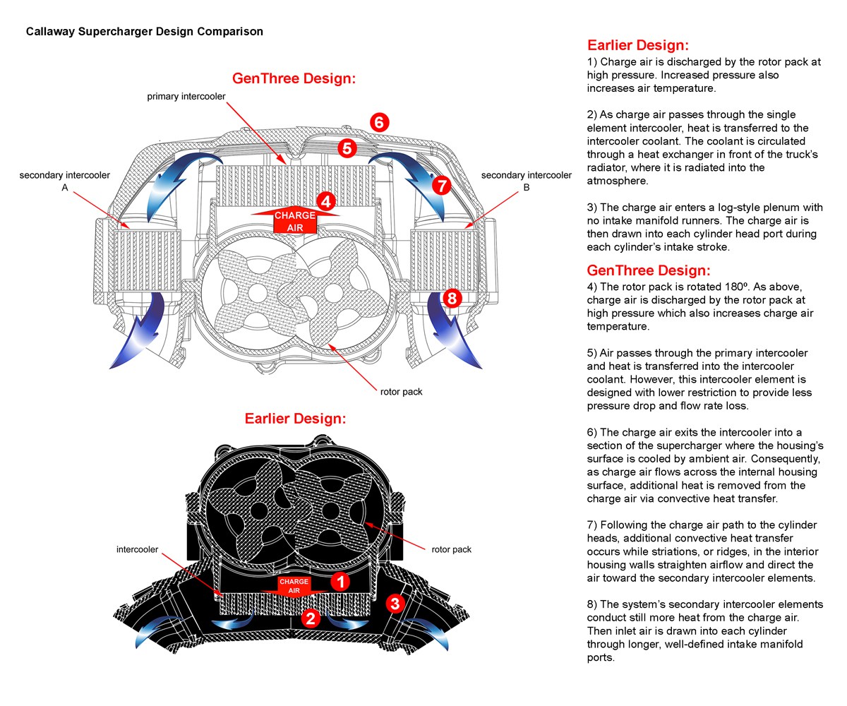

Look at what is now standard on all COMP LS Camshafts:
COMP Cams Micro Surface Enhancement - CPG Nation
They aren't the first for this as Crane Cams (Mikronite) has offered this similar treatment for quite some time and the process for out sourcing has been around from a very long time "isotropic / supermicro / REM etc polishing"
Gen5 Nice intercooler that makes the air flows through it twice and a splitter in the upper plenum to divert/channel the air. Basically the entire rotor casing/housing also gets cooled by the chilled air which is a plus.
SEMA 2017: 3.0-liter Whipple Gen 5 2018 Coyote Blower
And a pic of the Gen 3 design
Attached Thumbnails Petro's Project ERL Superdeck 427 w/ Whipple 2.9L-img_8215.jpg
Old Nov 2, 2017 | 01:43 AM
  #490
Vortec350ss's Avatar
iTrader: (20)
Joined: Feb 2006
Posts: 7,271
Likes: 62
From: South Shore, MA
Also noteworthy is that it's now a 3/4 lobe rotor design as opposed to 3/5. So at the 18k blower rpm limit you'll now have the second rotor spinning 24k rather than 30k. I'd imagine it will allow for higher RPM limits on these rotor packs.
Lookin a lot more like a TVS rotor design if I do say so myself. Obviously they spin in different directions... but I wonder how much more efficient they are.
