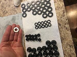

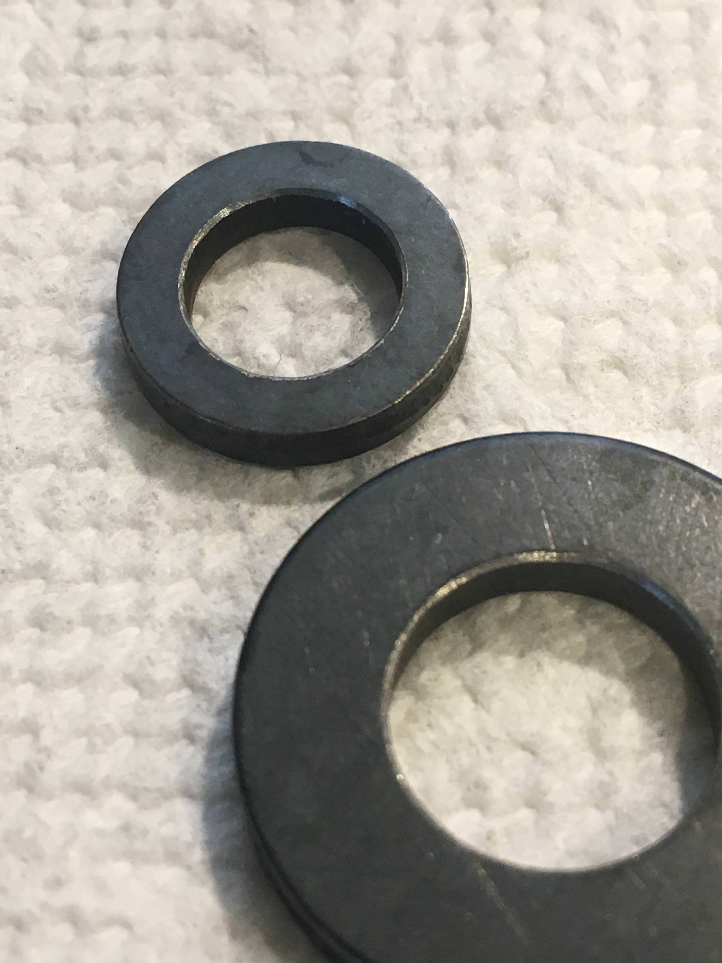

Chamfered both sides of the washers (they’re flat unlike the head bolt style washers with the generous factory chamfer) for the head studs and started roughing up the head surface side. The chamfer relieves the sharp edge which allows the fat surface of the nut to more fully engage/spread the load on the washer. The roughing up on the head surface side keeps the washer from spinning and acting like a bearing which should make for more accurate torque.

I thought about doing that to an adapter fittings and drilling them out, but i came to the conclusion it would weaken the threads on the small side by taking out the extra material. No worries of that?
Old Sep 11, 2018 | 04:33 PM
  #603
Petraszewsky's Avatar
iTrader: (28)
Joined: Oct 2008
Posts: 1,137
Likes: 22
From: USA
I didnt think about that but it doesn’t look to be or feel questionable. Plus they aren’t seeing a load like hanging a weight off them. I don’t think anyways. I think they’ll hold up to max of 80psi-ish fuel pressure.

I opened up some of my fittings like that years ago when I did my fuel system. Worked just fine.

I did think about chamfering them also but just said meh, not necessarily hanging weight but the threads when tightening. Mostly only the bigger ones but ive had to tighten the snot out of some of my fragola fittings and some still seep a little.
Just thought id ask.

My bad...I don’t mean to come off douchey if I did I apologize. That’s the last thing I want to be viewed as. Anywho yeah my fingers are crossed none leak. Did you use a AN assembly lube and anti-seize thread sealant on the fittings? That may or may not help with the seeping. I’ve personally never had to tighten AN fittings real tight but that could be luck and not having messed with as many as others.

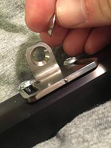

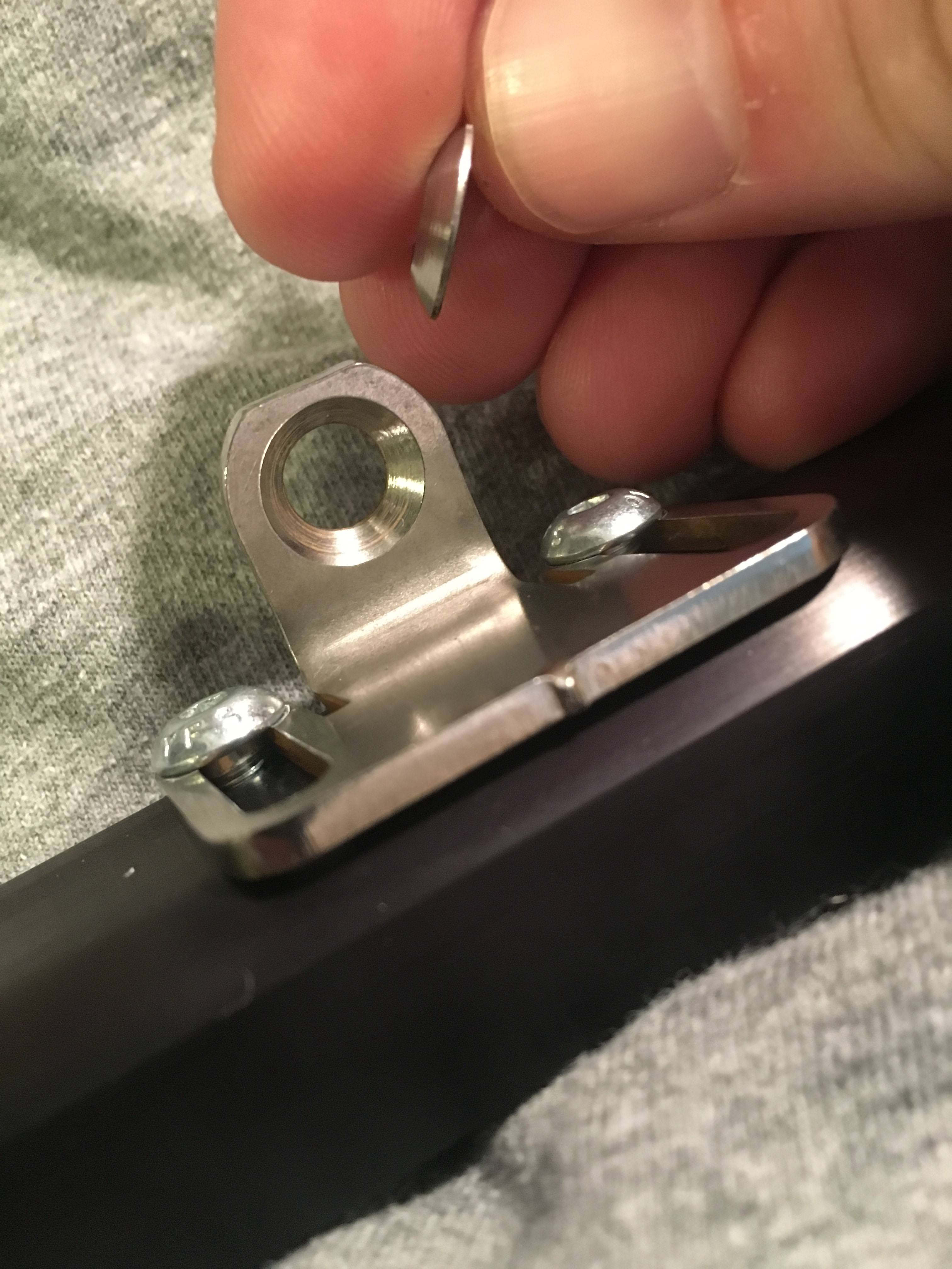

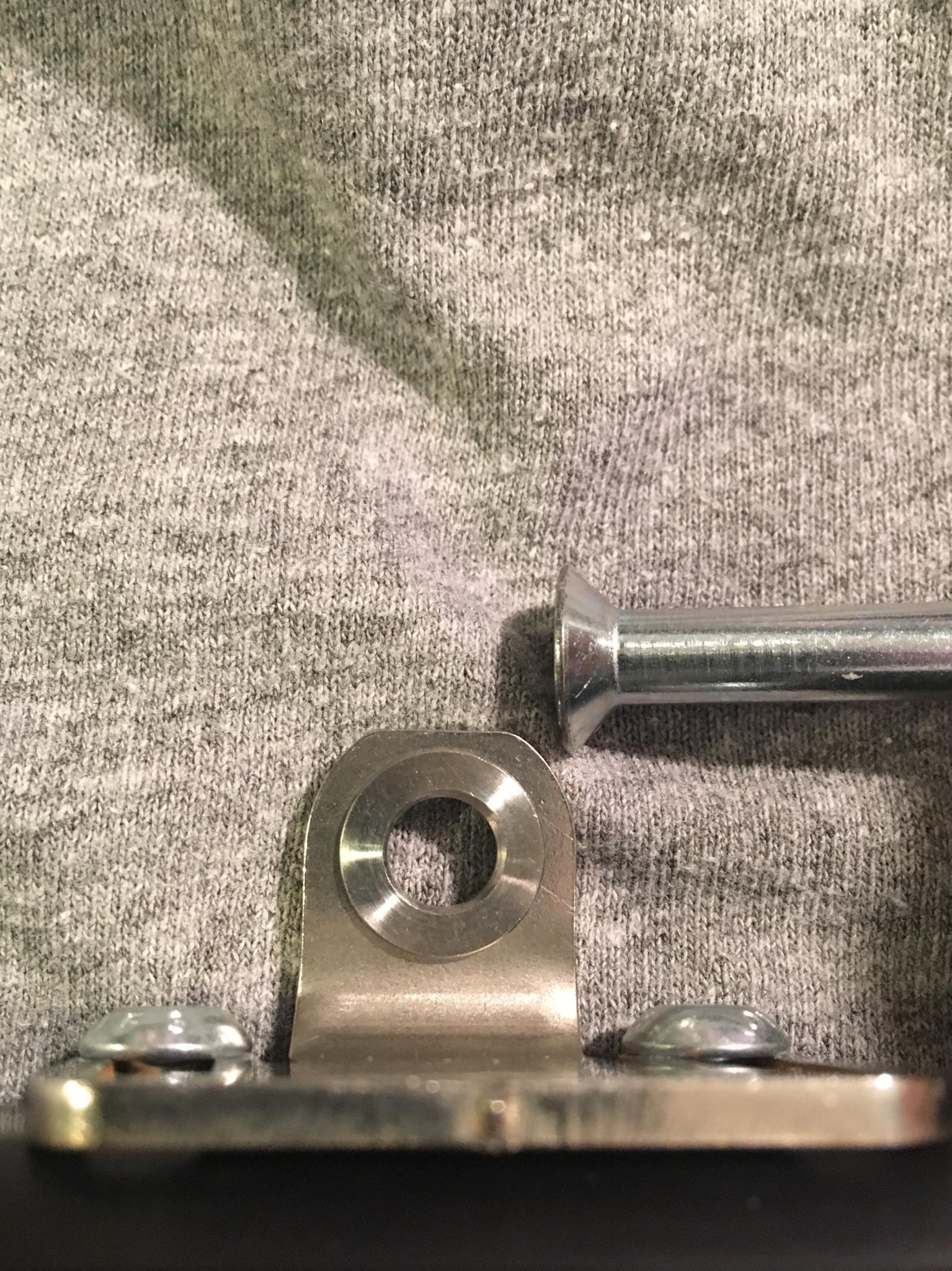

Helluva time finding A4 stainless M6 Spherical Washers 12mm od.....Got these from the UK. I also ordered some A-788 Splash zone to redesign port entries and lower manifold floor.
