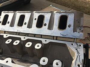

Not that I recommend it because of risking damage to the threads, gasket, and head deck surface/holes but if you wanted/needed to install the head with all studs in place you could
Petro's Project ERL Superdeck 427 w/ Whipple 2.9L-vtx78ws.jpg
