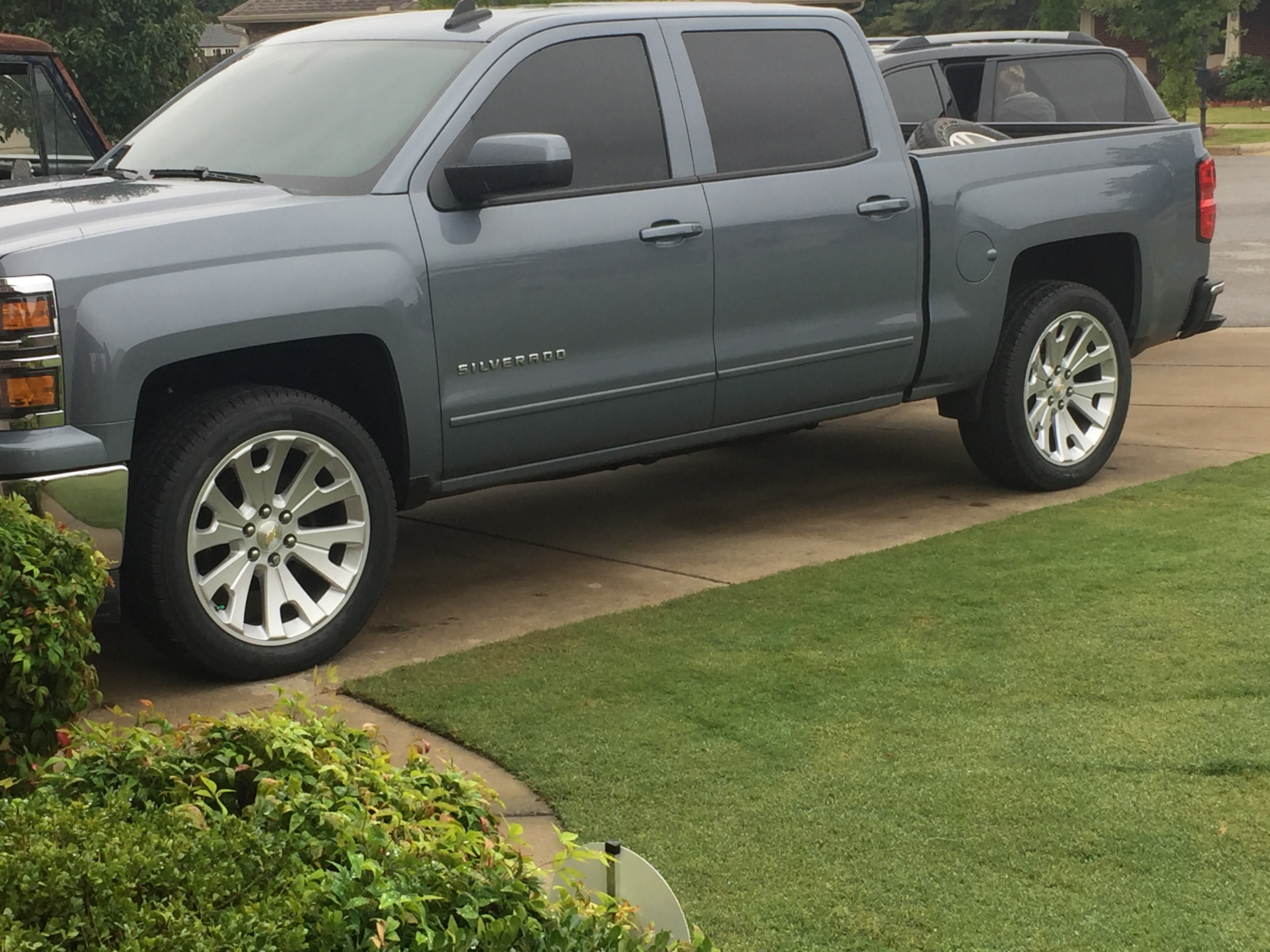

Used S10 money for new wheels and tires for the Silverado
Petro's Project ERL Superdeck 427 w/ Whipple 2.9L-vlhd429.jpg

Nice wheels, too bad your yard looks like crap

The lawn did take a turn for the worse at the beginning of August for some reason and never fully recovered. Not sure why either but I did make note of it
