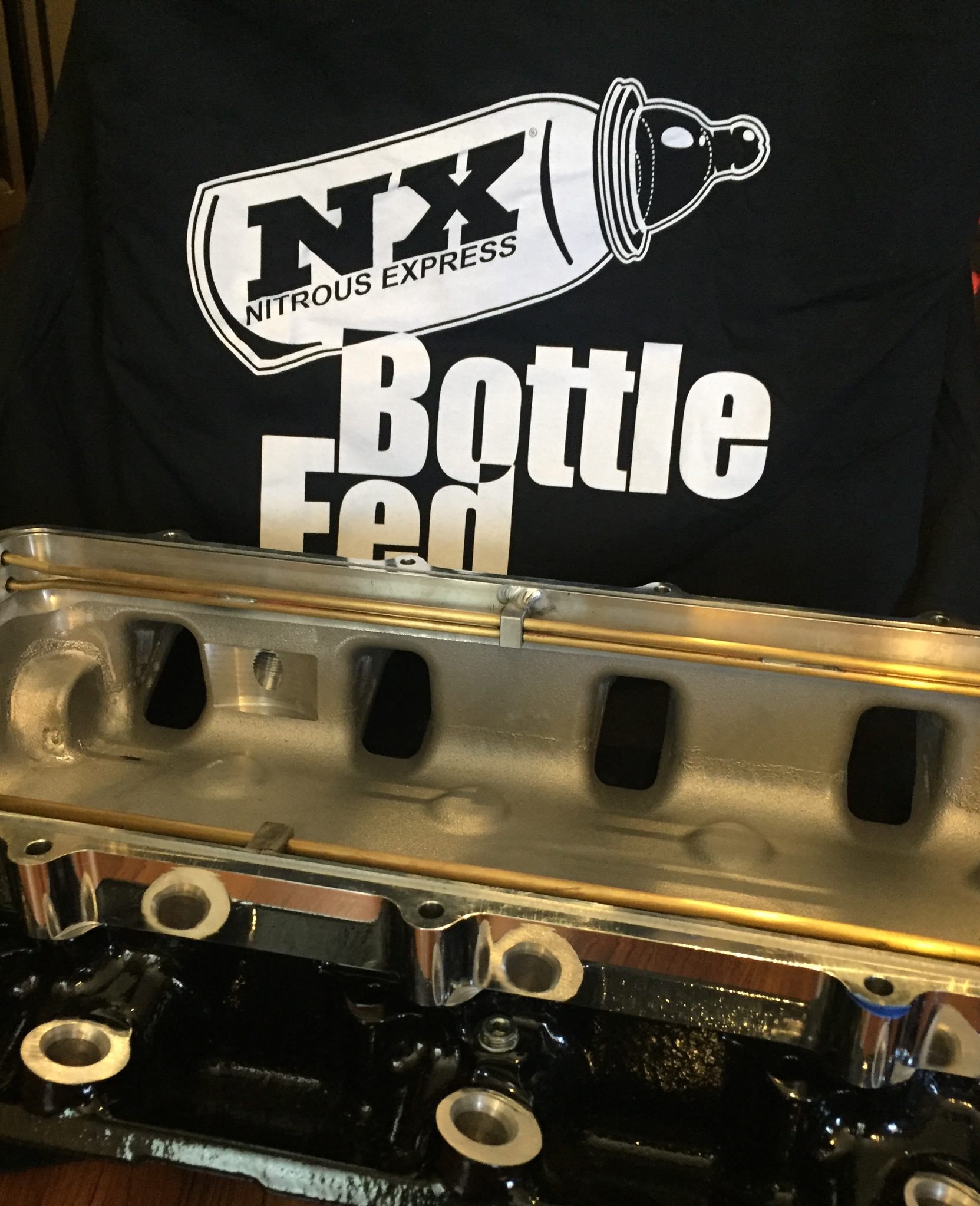

Spray bars installed....now to tinker with the ports and floor design

Old Jan 4, 2018 | 10:59 PM
  #524
Vortec350ss's Avatar
Joined: Feb 2006
Posts: 7,271
From: South Shore, MA
that looks awesome!!

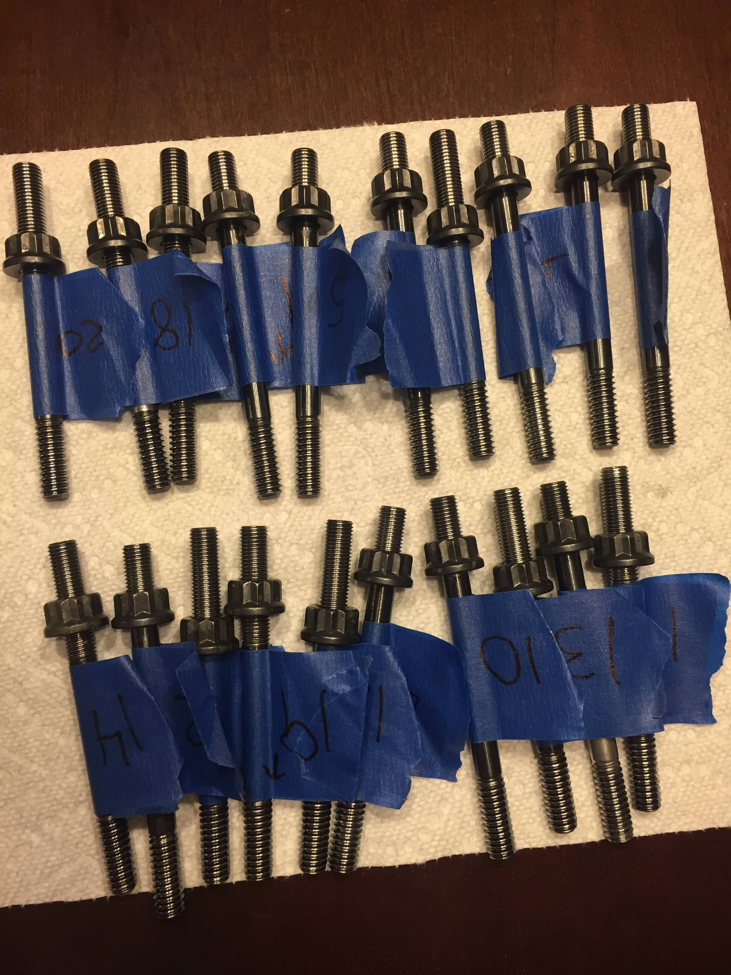

Almost done wire wheeling and polishing every bolt/stud for the engine:

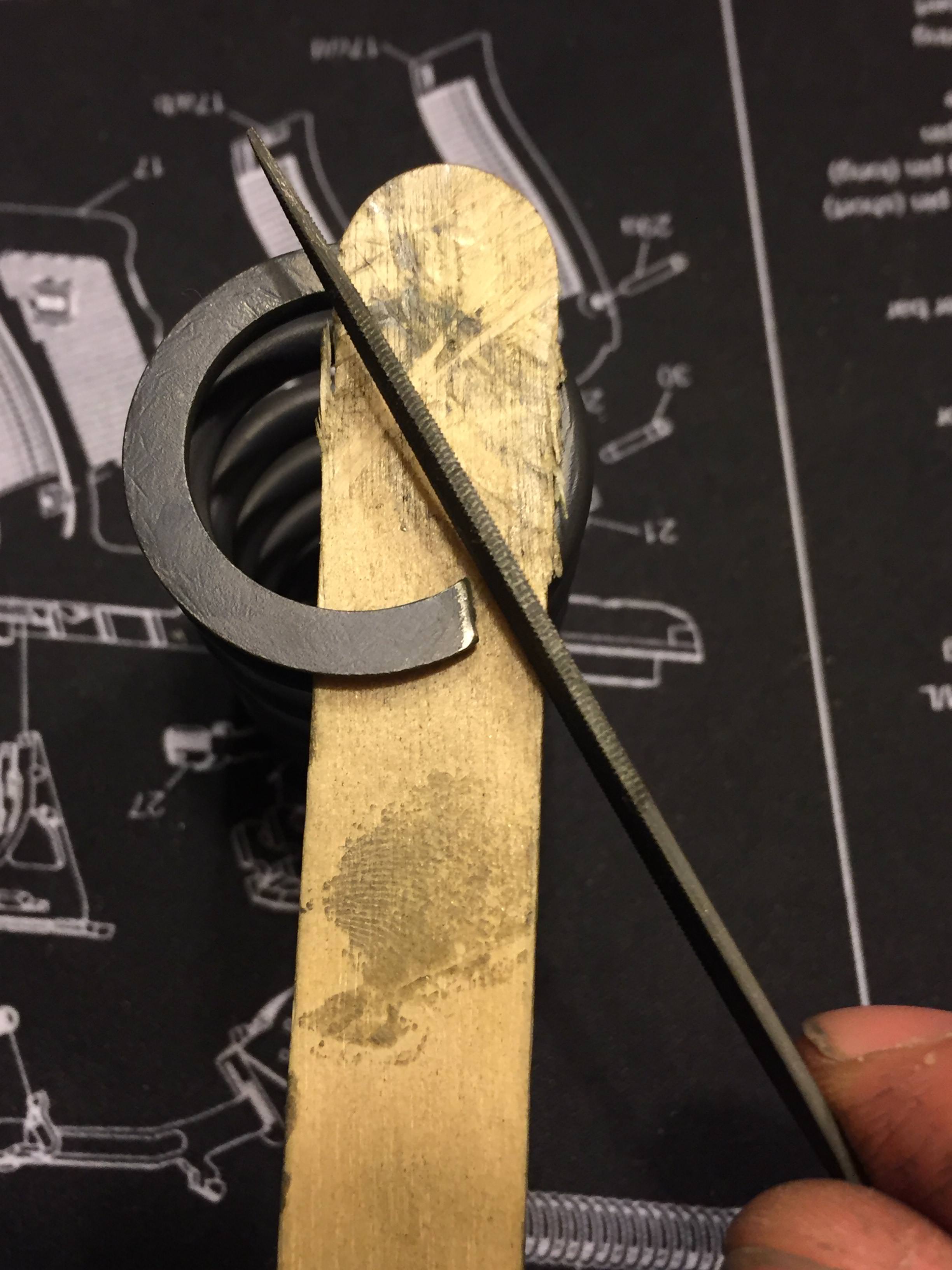

Putting the final touches on the valvesprings...chamfer on both ends of each spring...that’s 64 ends total!!! This prevents the springs from digging into the seats/retainers and creating metal shavings/wear. I have another tool to chamfer the inner diameter as well to complete the process. Titanium galls easily so the coating helps prevent galling and the chamfer is another failsafe.

Old Jan 15, 2018 | 09:20 PM
  #527
arthursc2's Avatar
Joined: Jan 2014
Posts: 4,341
Likes: 1,517
How is your file holding up to the Ti?
The attention to detail is insane. I’ve never seen anything like this. Hats off to you my friend.
Old Jan 15, 2018 | 09:34 PM
  #528
Petraszewsky's Avatar
iTrader: (28)
Joined: Oct 2008
Posts: 1,137
Likes: 22
From: USA
No filing of the Ti retainers just the springs

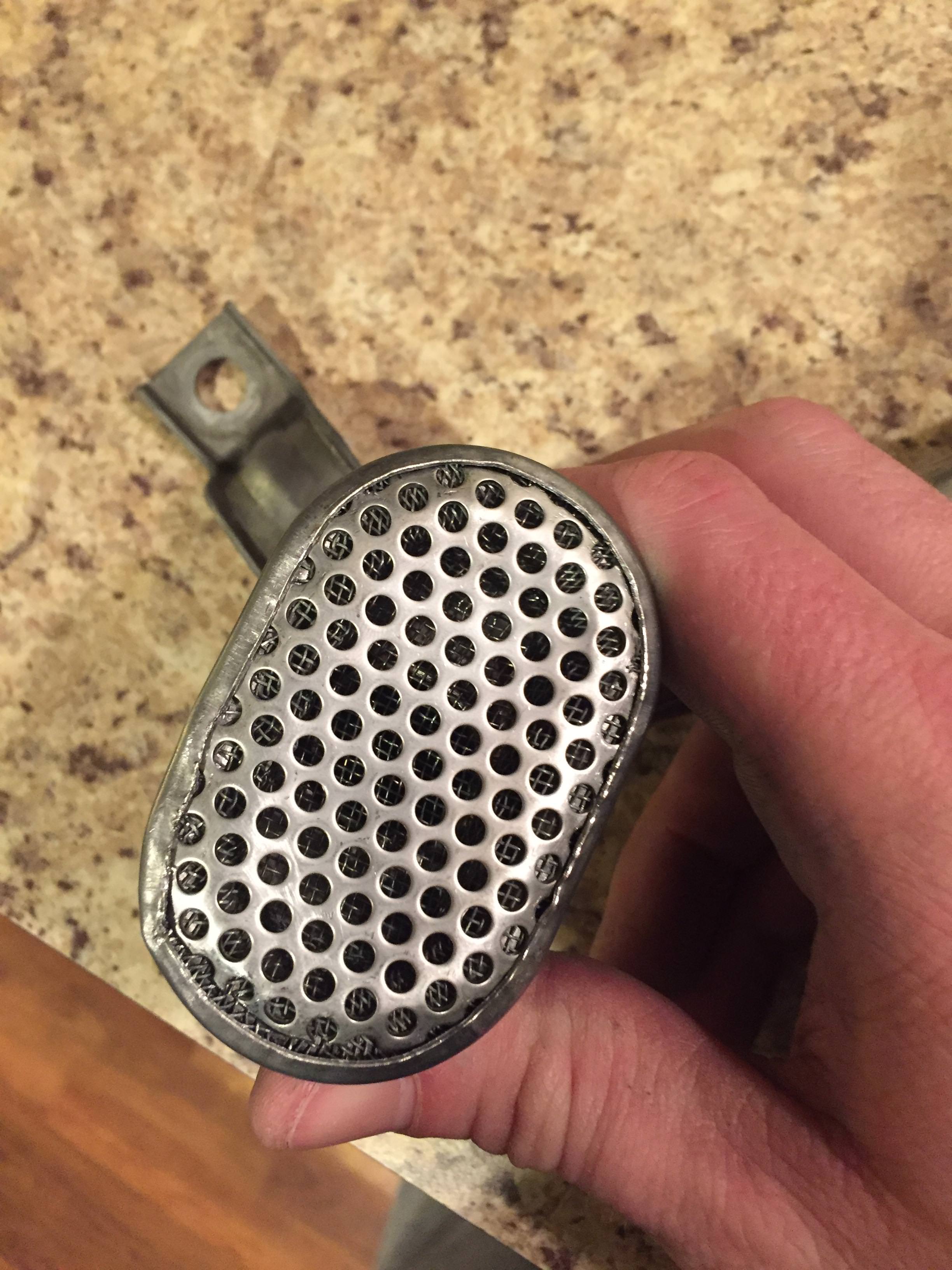

Testing pressures on each spring was bringing up differences of +/- 8lbs so I ran each individual spring down to coil bind and waited 1 minute before releasing it. I then pressure tested them again and got more consistent results. I matched each spring to get 178 or 180lbs @ 1.800” height. This netted a consistent 200 or 202lbs @ 1.740”
Not quite done but you get the idea....roughly 24% increase in open area to compliment the 18% greater flow rate of the Melling 10296 pump.

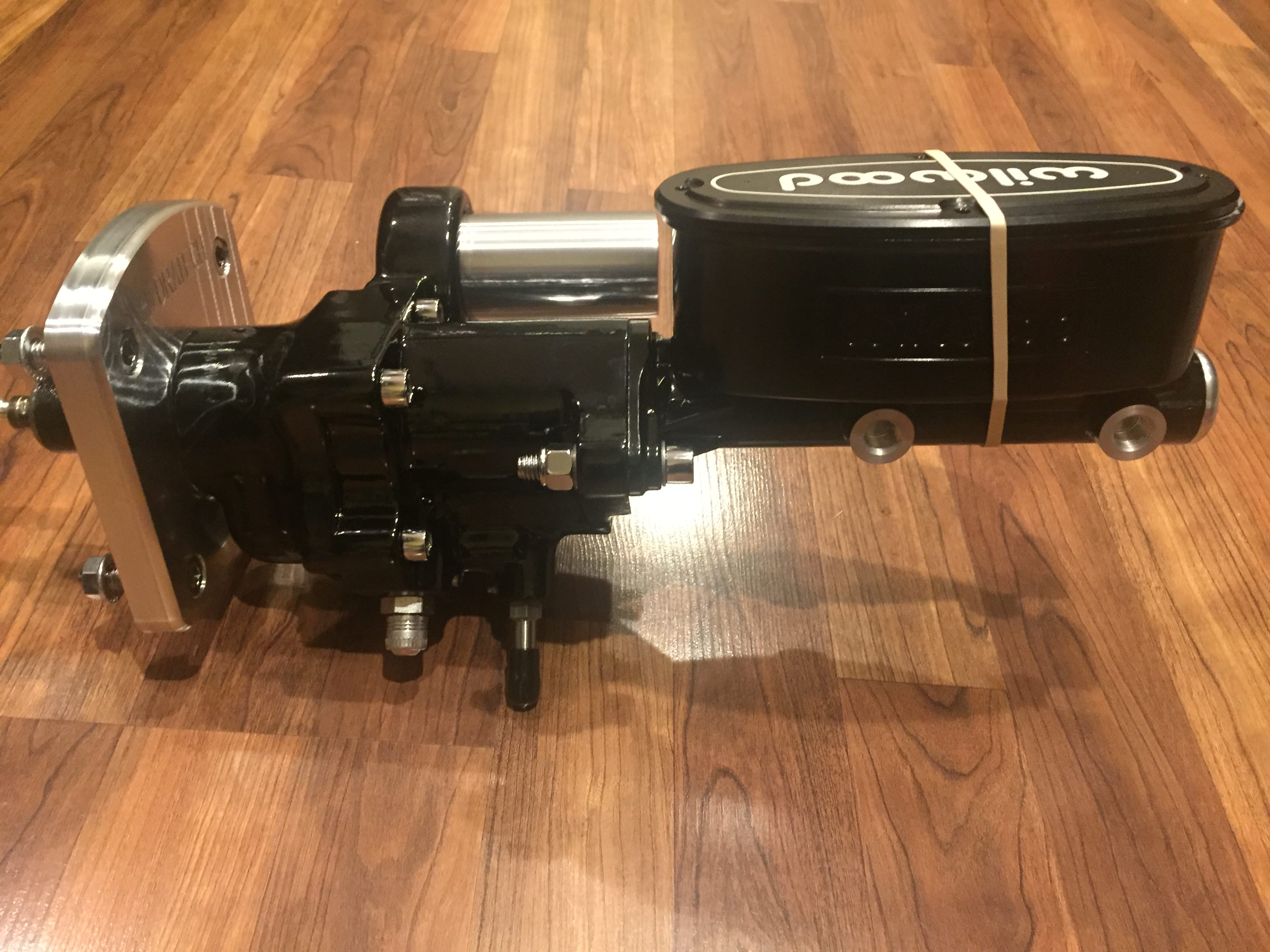

Hydroboost and 1 1/8” bore master
