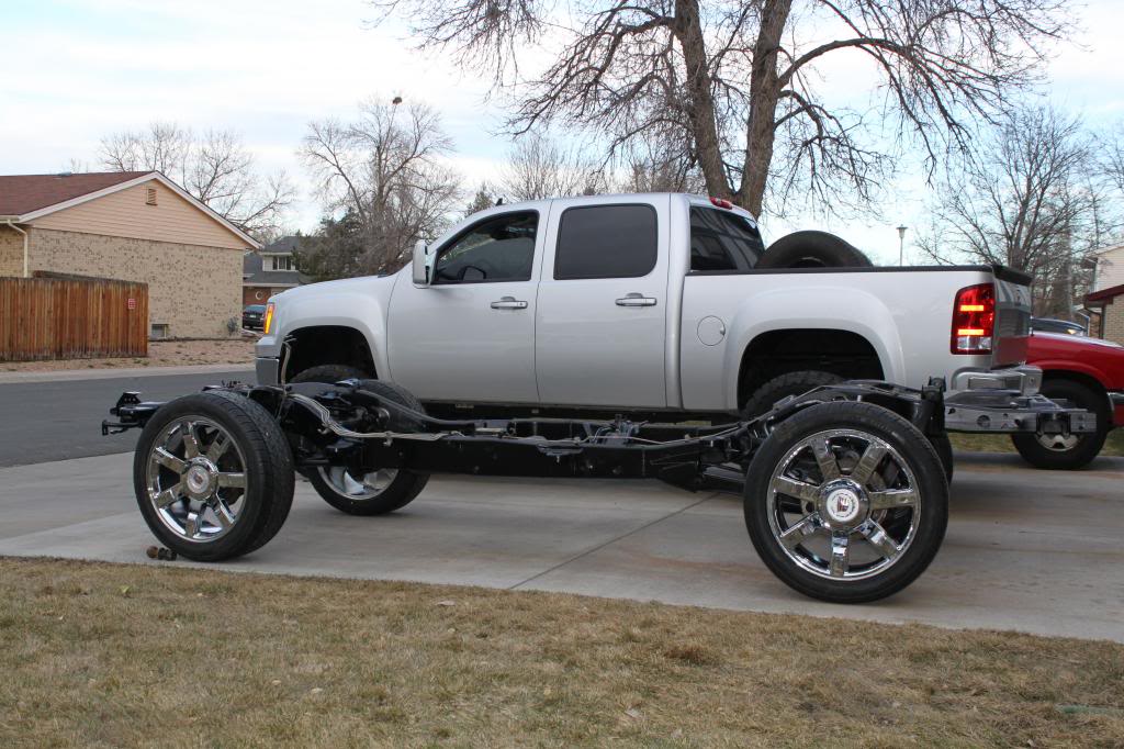

New Wheels.
Dropped the block off at the machine shop today. Going to get cam bearings, crank polished and cylinders honed.
I still need to order rings, rod and main bearings. Where are you guys getting bearings at? What brand?
Also need ARP Rod bolts and want manifold studs but cant find any.
Any help would be appreciated!
