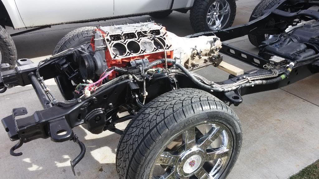

Look familiar?

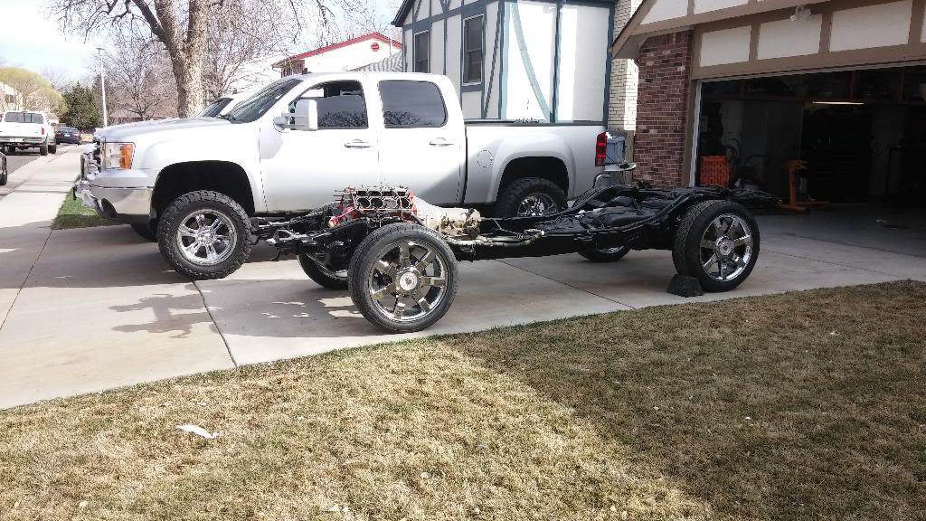

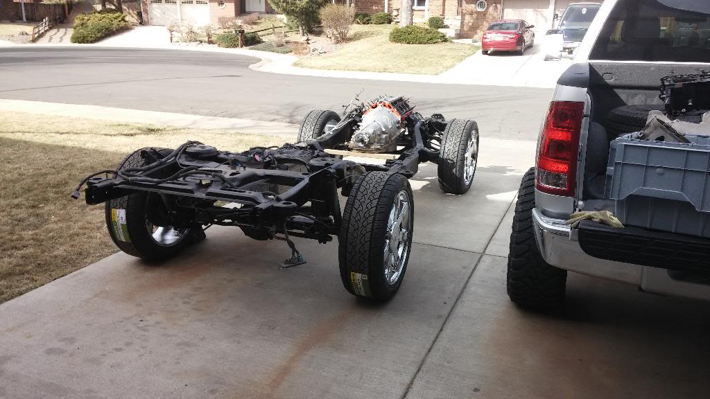

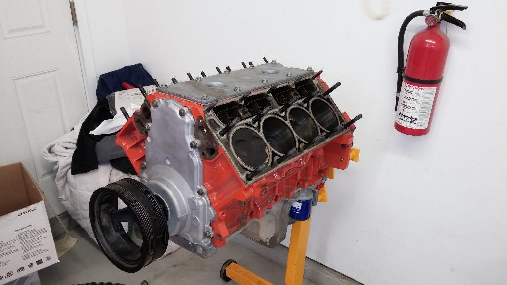

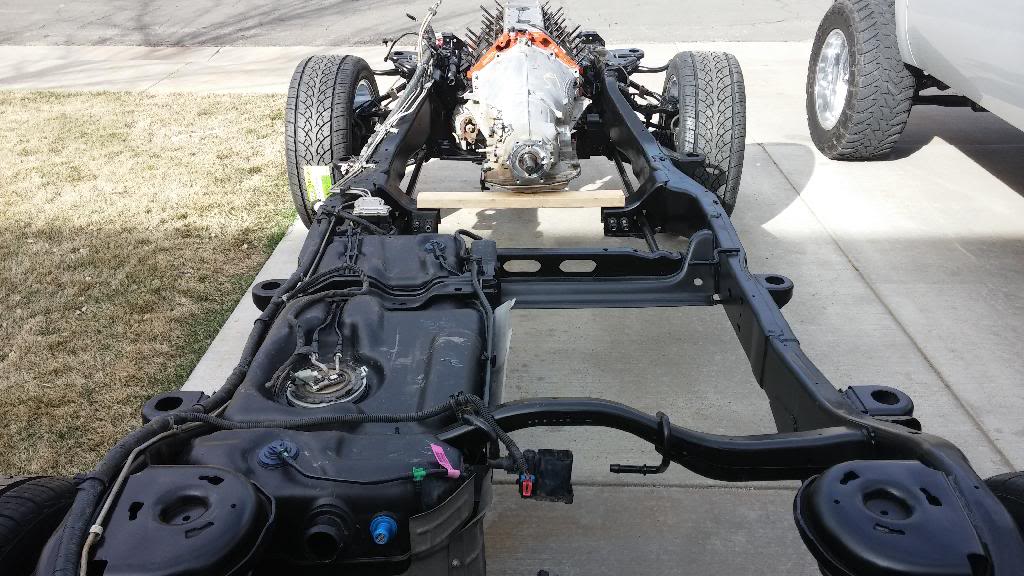

Gonna get trans cross member done tomorrow.
Still need before the cab goes back on.
4l80e Tailhousing
Neutral safety switch
Tcase input shaft (where is everyone getting it from?)
Waiting for Valve Springs
Manifold studs
Drop kit
Drive line

Dont think I would ever have an open short block outside and open like that.
Old Mar 30, 2014 | 06:41 PM
  #129
Mortiz's Avatar
Formerly PurplePearl (2014-04-06)
Joined: Dec 2011
Posts: 262

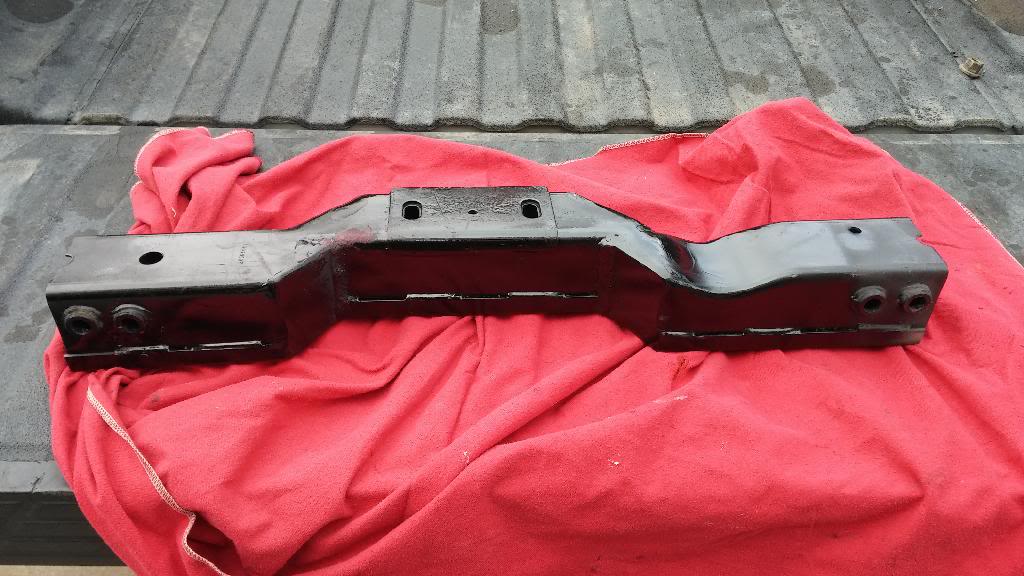

I just took the cover off to take some pictures.
Got my cross member done today. Going to repaint it.
Is my tcase a np261? It is the auto trac unit out of the tahoe!
Old Mar 30, 2014 | 06:54 PM
  #130
1FastBrick's Avatar
Custm2500's Rude Friend
Posts: 14,593
Likes: 900
From: JunkYard
I believe Autotrac is a NP246
I believe the NP241 is a manual case.
