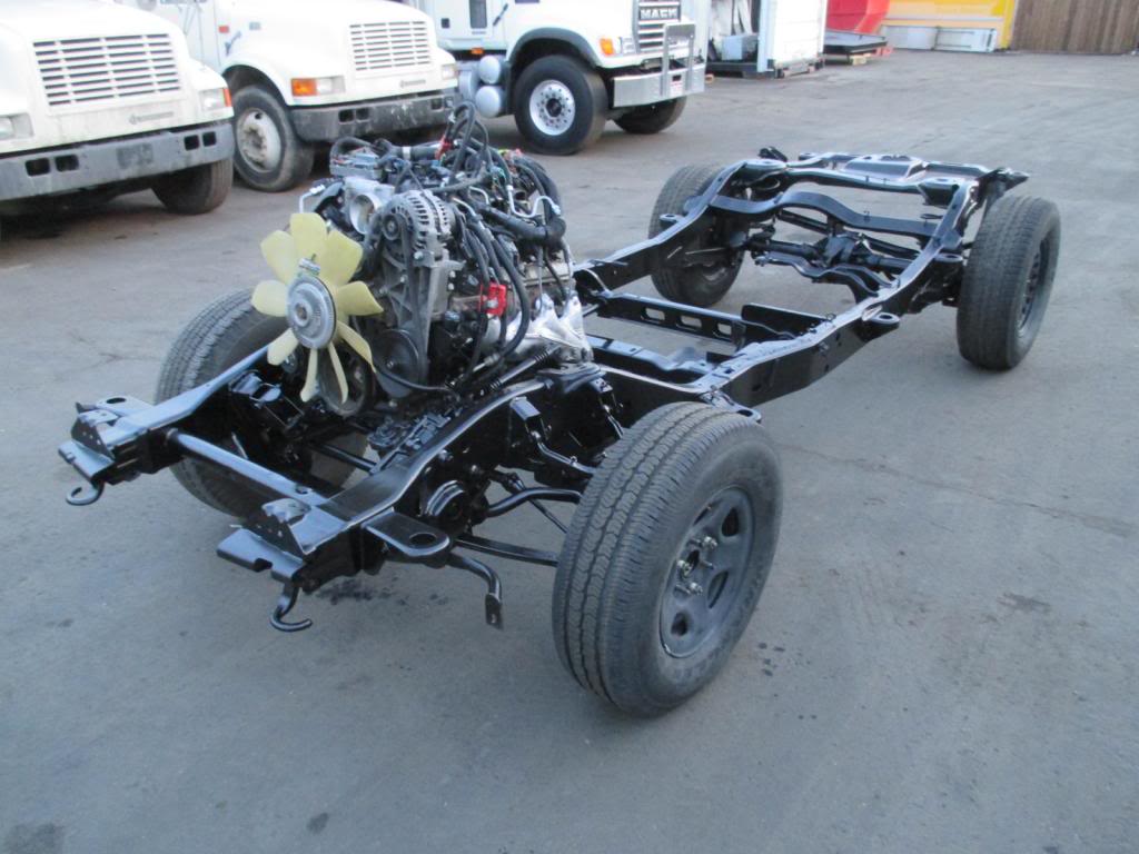

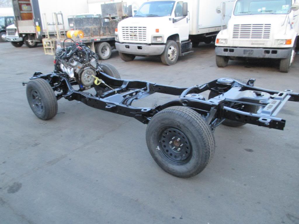

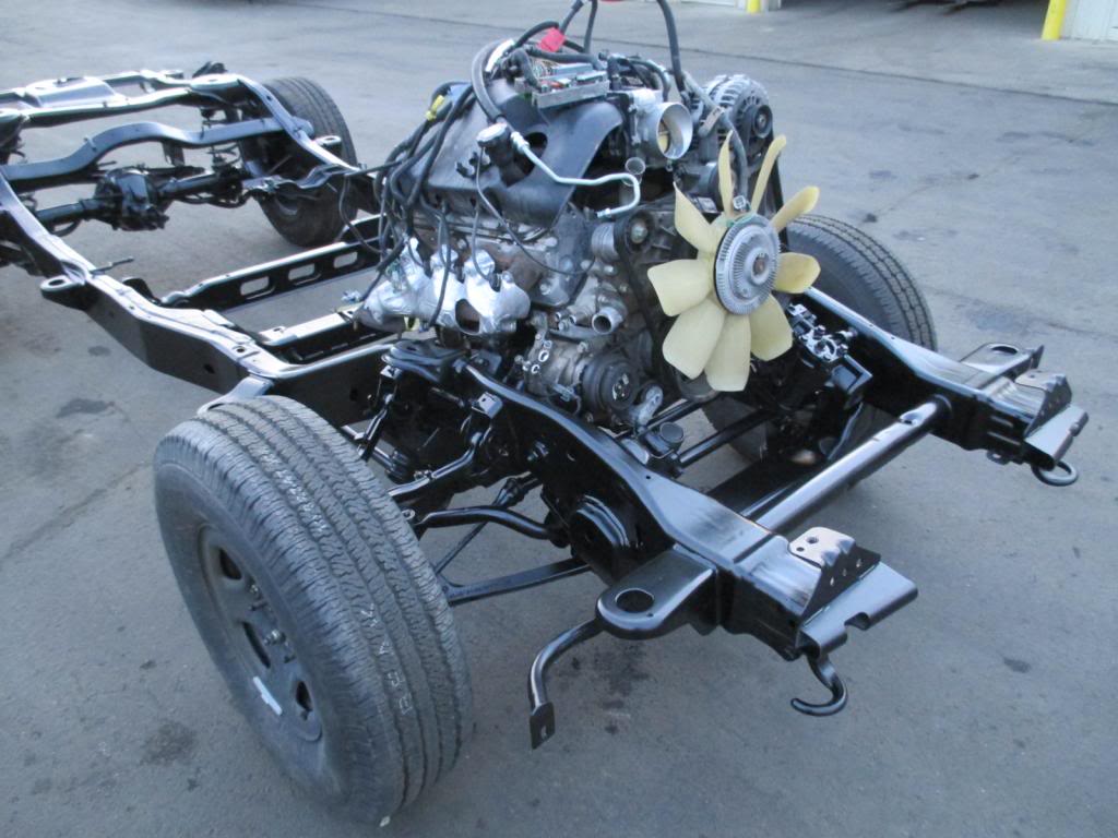

Some better pictures!

So were did the GMC front clip come from?
Are you going to have to modify the frame or the mounts even though you painted it already?
Old Feb 17, 2014 | 11:08 PM
  #93
Mortiz's Avatar
Formerly PurplePearl (2014-04-06)
Joined: Dec 2011
Posts: 262
Picked it up on CL for 500. No cab will bolt on. I am going build brackets for the bed and use tahoe mounts.
